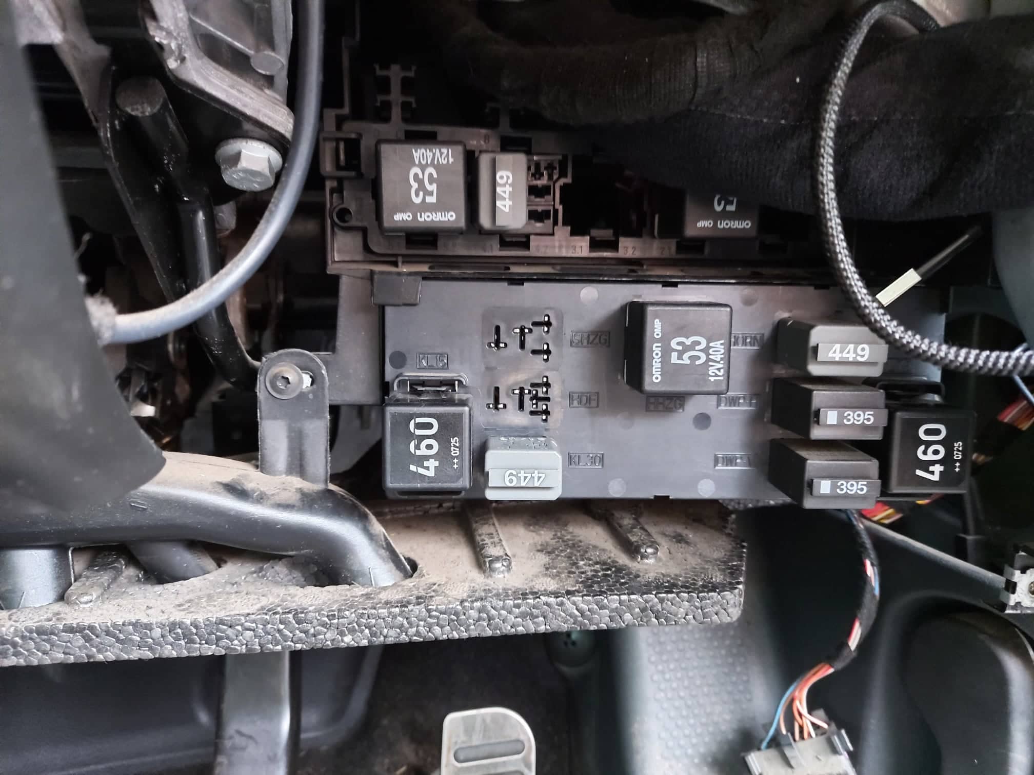

    is this your relays ?

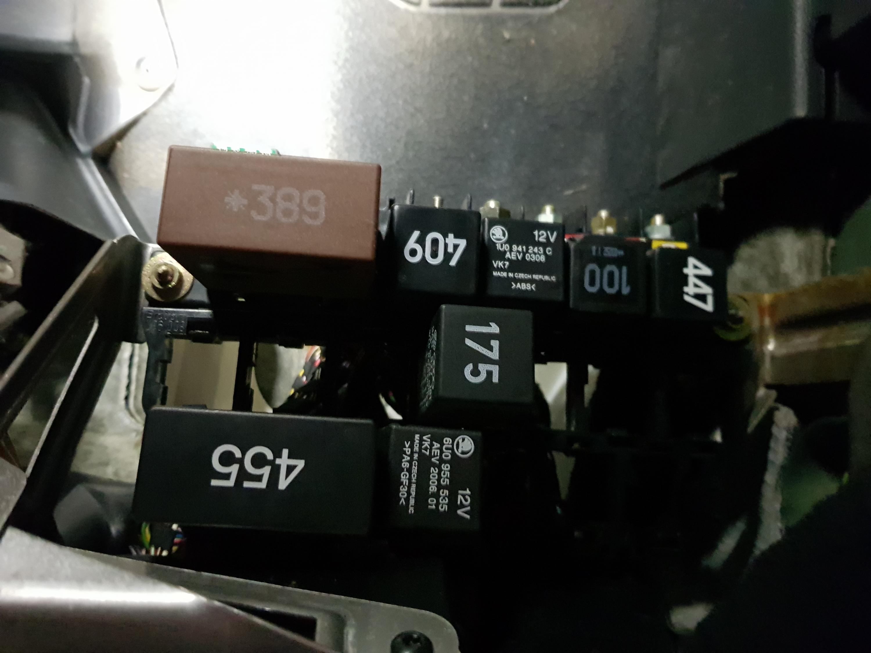

      Re: 12v 1uo941243c Relay repairable?
      here is my plate but a bad pic and the relay is numered 409
      nnot 309 and the pics are upside-down

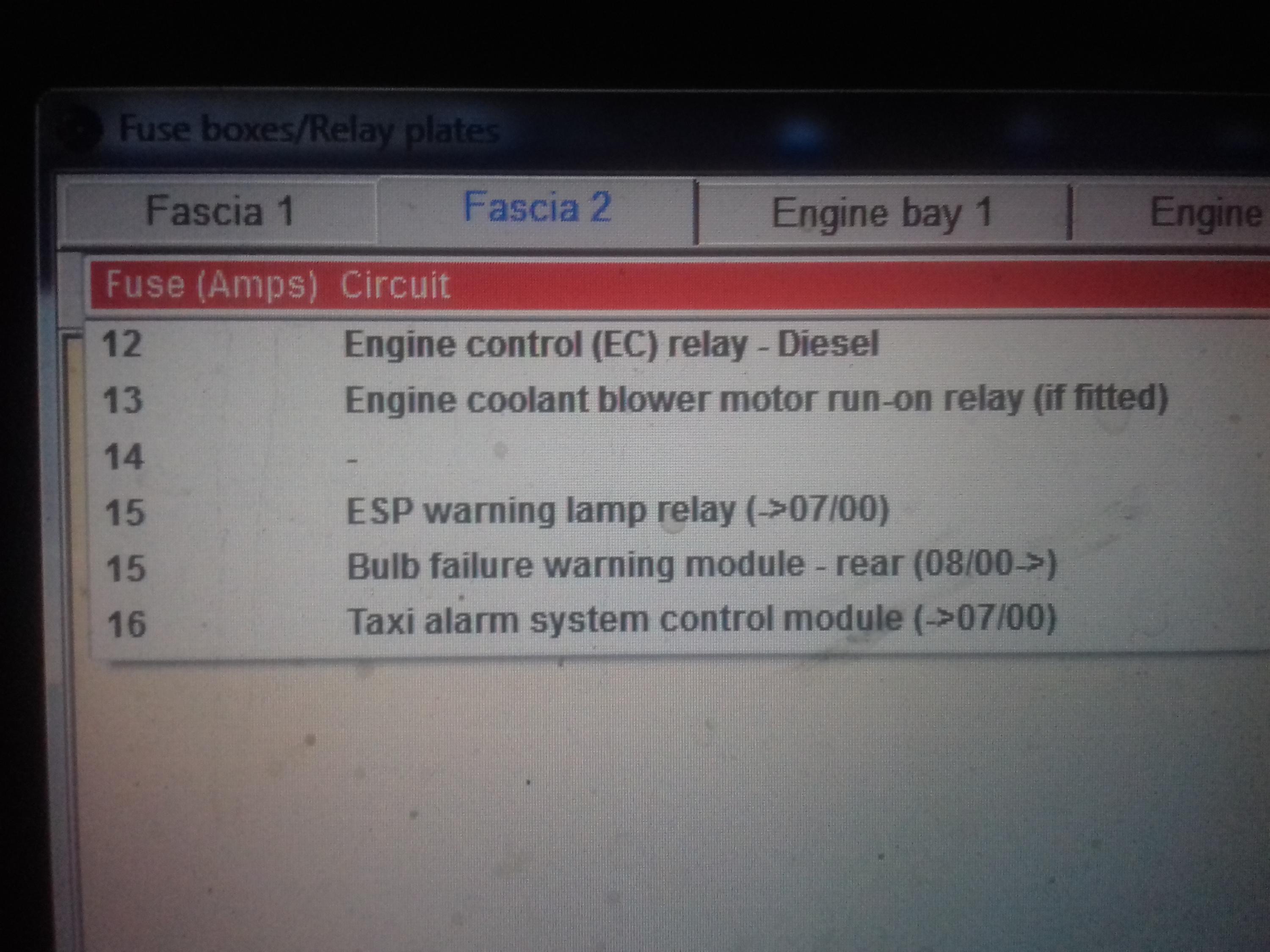

        i cant match them with my autodata . it is a 2004 octavia is it ?
          yes SKODA Octavia I break (1U5) 1.6 Bensin (102 hk / 75 kW)

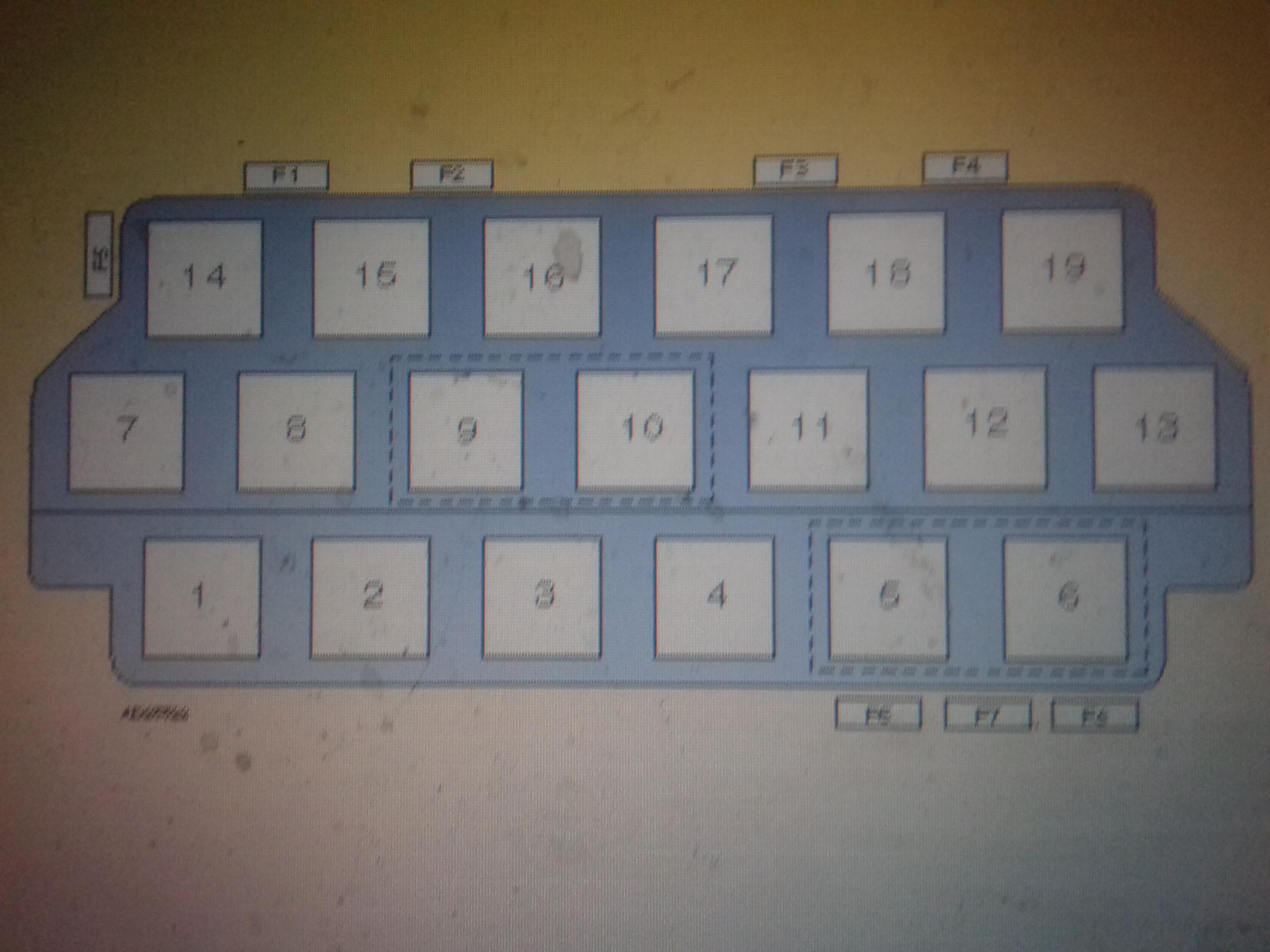

            i see now your relay plate can fit 14 relays .. will look at autodata again later

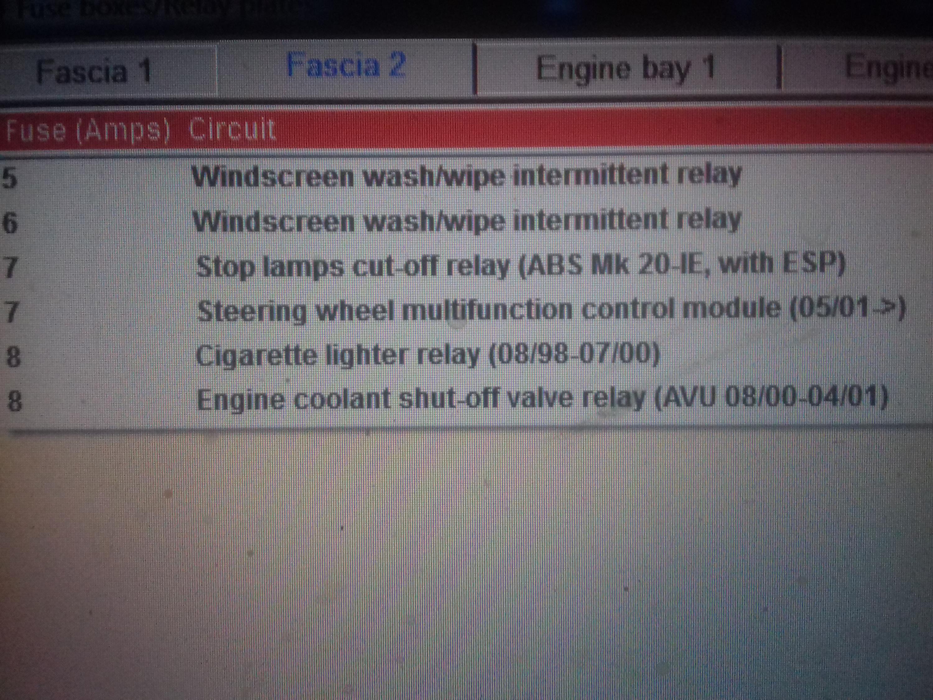

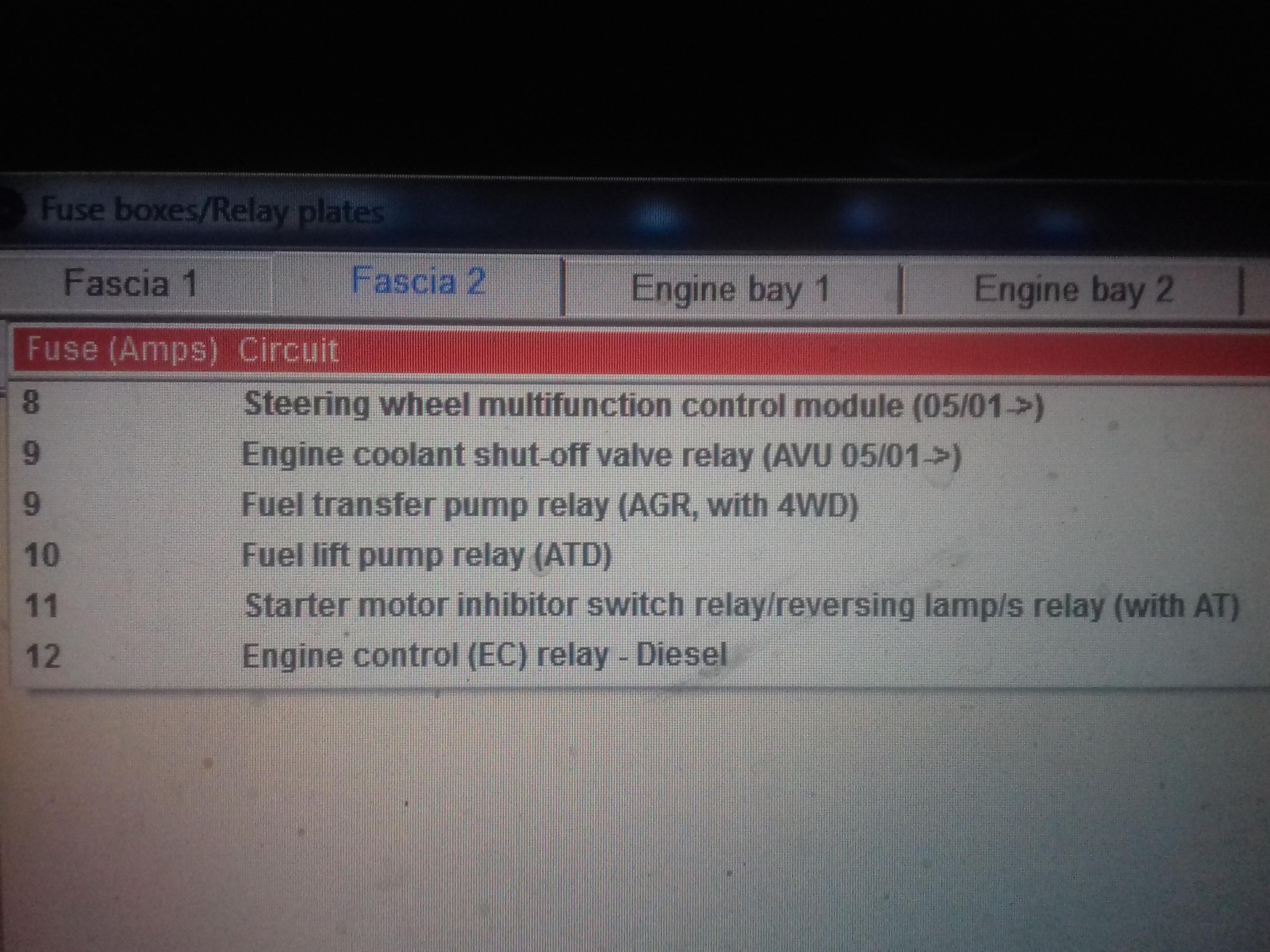

                #47
                hope pics are good enough i couldn't get print screen to work properly so used camera .

                        #51
                        hoping this works i didn't check if it converted properly .
                        thank you so much for your help. will look further but wondering is it for fuel pump? because i see no specification
