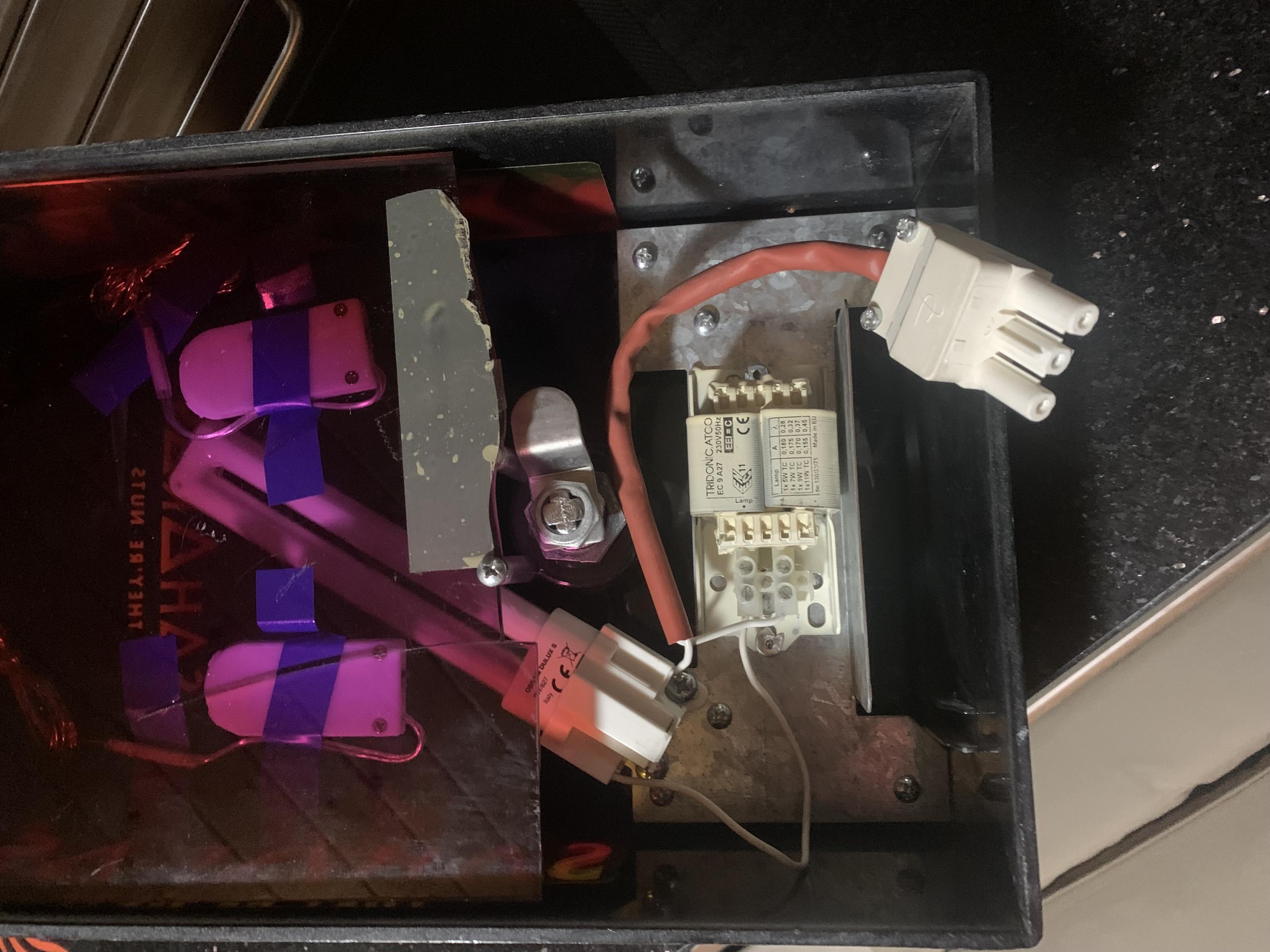

                • 30983
                Re: flourescent ballast resistance
                it's a philips PL tube,
                totally dead - maybe it's a bad lampholder or broken wire.
                the problem is it fits into a tight housing - and the light is used in all directions.
                so no room to use an electronic ballast and the tube only has 2 exposed pins
                i thought about winding led strip onto some copper water pipe to give 360' illumination, but it's a last resort.

                        • 30983
                        I am sure you know that already. Lol
                        you asked for it.
                        this is the lid of a countertop vending machine
                        notice how the lamp is between the top housing and a colour filter to illuminate the goods.
                        ignore the tape and led lights - thats the owner trying to bodge some illumination into it - failed

                          For what it’s worth, GE still makes magnetic ballasts for the NA market. I thought nobody made those magnetic ballasts anymore?
                          Interesting light fixture. There is not much room inside. I’d be tempted doing a led conversion.
                          Just googled Osram D8/827… I can see D10’s and D13 also on eBay. I guess that lamp is a D8?

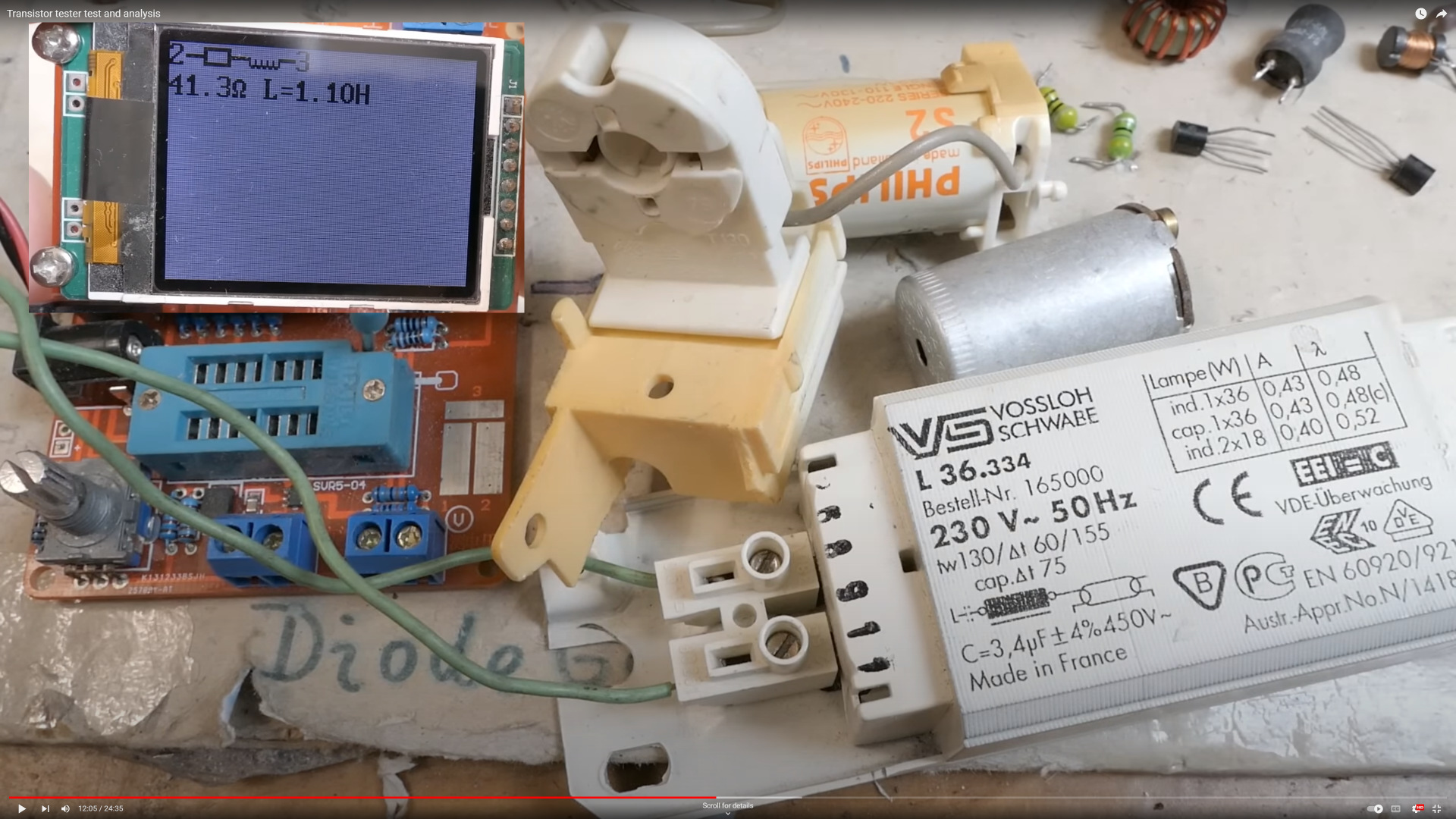

                            • Per Hansson
                              • Jul 2005
                              • 5895
                              • Sweden
                              In one of DiodeGoneWild latest videos he tests a 36w CFL ballast:
                              https://youtu.be/B4YM_ljELl4?t=723
