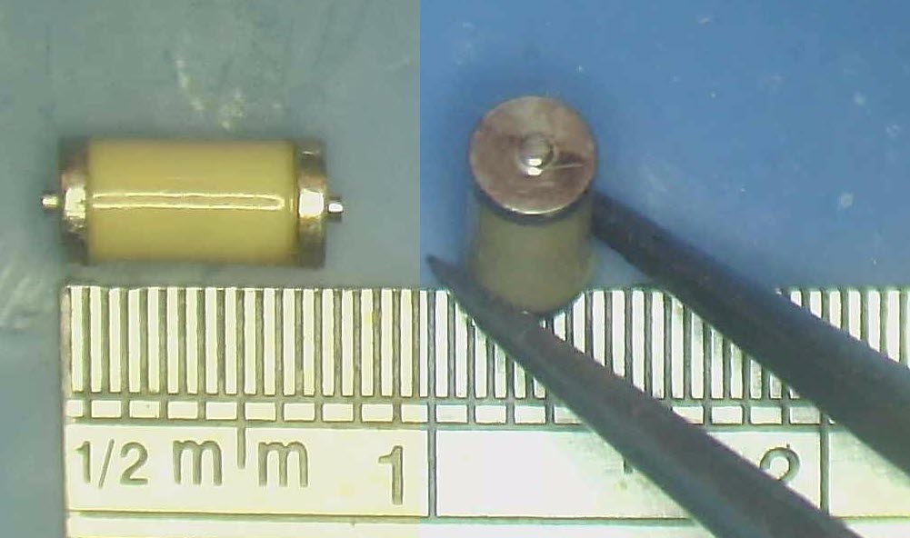

    What is this component? No markings whatsoever.
    Hi All,
    Could anybody please recognize this component? It has no markings and there is no designator on the board. It has no continuity, diode test shows also OL both ways.

    Give more info, what PCB is it on,make/model/part number etc .

      Re: What is this component? No markings whatsoever.
      interesting, it looks like ceramic
      maybe a spark gap - whats it from?
        The part has no leads, it looks like it fits in a socket? Designed to be replaced.
        I would guess a gas discharge tube or higher power RF TX capacitor.
            It's an Earth Bore pointer.
              Ok that would make it a vibration or roller ball tilt switch. It must tell the MCU the tool is up or running.
              Hold it up to your ear and shake it, see if you can hear the ball/roller/spring inside. Or put a DMM on continuity and tilt/shake the sensor see if you get a closed switch reading.
                use a meter,
                if it uses a ball of mercury it wont make any sound
