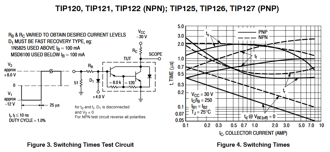

                    I suggest adding a resistor base-emitter to reduce sensitivity to leakage and noise. This is normal practice with regular transistors, and I would think the high beta of a Darlington would make doing so even more important.
                    PeteS in CA
                      #30
                      Re: TIP120 Question
                      The TIP120 has them built in, otherwise it would be even slower switching. Plus you get a free diode too.
                        #31
                        Re: TIP120 Question
                        I sit partially corrected about the TIP120 incorporating B-E resistors. However I think those are to prevent leakage or noise from turning on the Darlington. IIRC, it's a C-B resistor that keeps a transistor or Darlington pair from saturating. Saturating would slow the turn-off time.
                        PeteS in CA
                          #32
                          Re: TIP120 Question
                          As I know, the E-B resistors are mainly to dissipate stored charge and thus speed up turn-off times. If you build a Darlington on the breadboard out of two transistors, they are super slow switching without them. But they also work for keeping the transistors off due to leakage or an Arduino pin floating during RESET.
                          I just noticed the datasheet switching time test is a cheat - they apply a -4V off-bias and +12V pulse to get (force?) the ~1usec rise/fall times.
                          Darlingtons are slow, and lossy because of their high VCE sat. 2V at 4A and 4V at 5A means they dissipate much more heat that a mosfet.
                          I think OP is fine using them for the solenoid driver, but PWM with an LED or running the TIP120 at a few amps it would just run hot and need a heatsink.
                          I haven't seen a C-B resistor used to help with saturation, or a Baker Clamp. I tried making SMPS with Darlingtons and it was awful compared to mosfets.

                                redwire is correct that I was confusing a C-B resistor with a Baker Clamp, which uses a diode to reduce storage time. Lo siento.
                                Basically, transistors' rise, fall, and storage time combine to limit the practical switch frequency of a transistor-based SMPS to less than ~50KHz. Above that practical frequency a transistor is either off or in its dissipative linear region for too much of the potential "On" time to allow the necessary input voltage range for an off-line SMPS.
                                PeteS in CA
                                  #36
                                  Re: TIP120 Question
                                  TIP120 switching times are about 0.5usec on and ~3usec off with a -ve voltage drive to force it off faster. If you're not doing that or saturating it, it's much slower I would say up to 10usec to turn off in the real world. You could not use it to pulse an LED at 1usec say. Note the datasheet complicated test circuit is using +8V and -12V drive, which is unrealistic.
                                  Power MOSFETS are 100x faster and less losses when fully on, so less heat. This is why they are king in SMPS use.
                                  TIP120 is OK as a power switch as long as you are OK with the losses/heat VCE(sat)=2V and not switching really fast.

                                      IRF620 switches in nanoseconds, not microseconds. FAST.
                                      I've tried building SMPS using Darlingtons and it was basically terrible to get past even 30kHz out of them. It's because their gain is so high, bandwidth is low. Turn-off takes forever. I suppose you could add circuitry to lessen charge storage. But the last power transistor having a hFE of 10-20 is no fun either.
