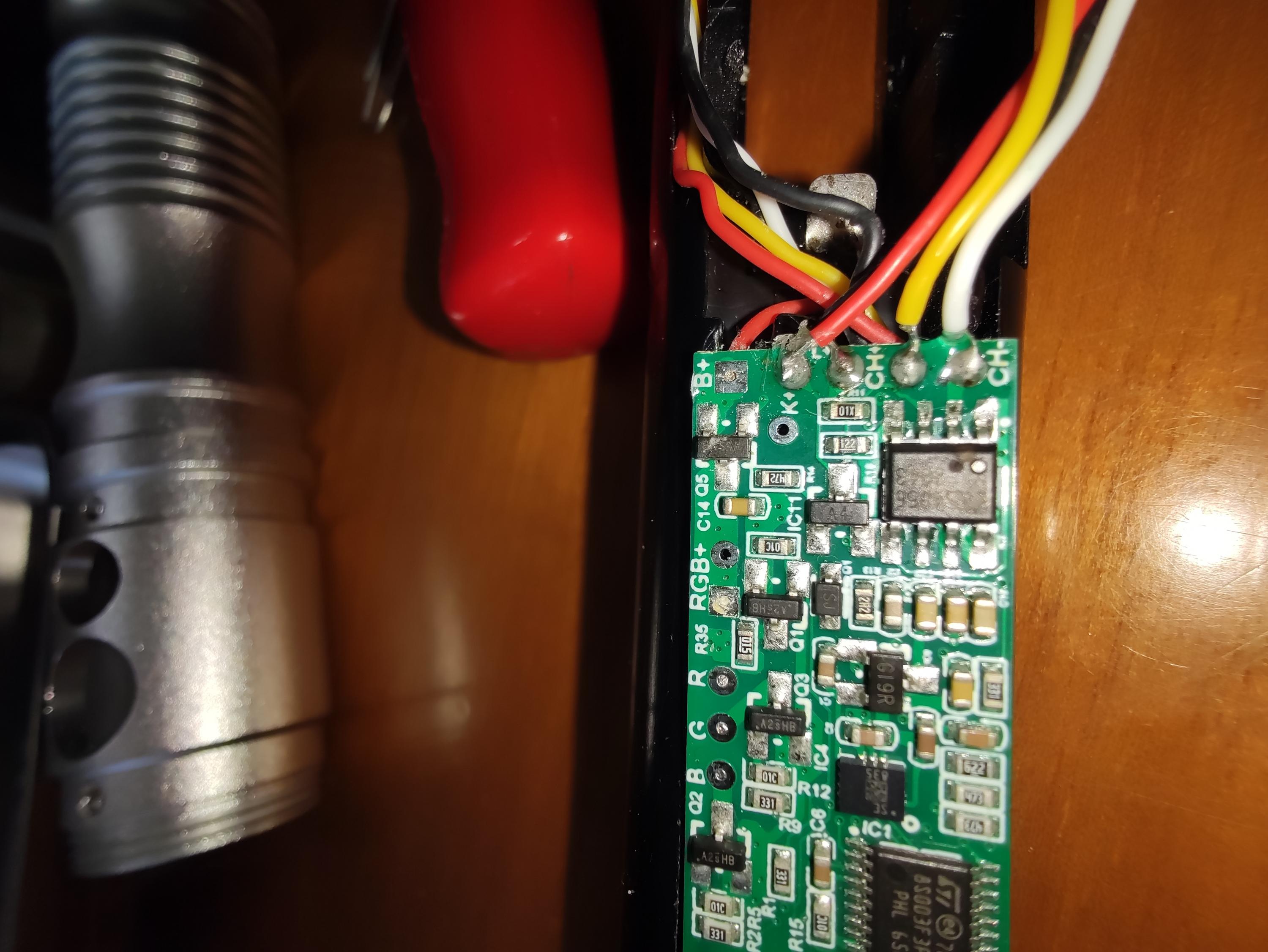

    Hi everyone. I have this laser saber mobo that fails (the sword is totally death). I noticed a hole in the top right chip. I can read from the chip 4056 2043. I don't know the company who mades this chip ( i don't recognise the simbol). I have some questions.
    Is it the chip for the lipo charge?
    Can I replace with another 4056 chip? I found a lot of chip named in that way.
    I found a lot of chip 4056 but with a TP at the beginning of the name. Is the same chip?
    I need some programmer to reprogram it (like bios chip) or not?
    Thank you

    Q5 looks cracked

      Re: 4056 Chip
      Q5 looks cracked
      the 4056 ?

        what is "CH" ?? a speaker?

          the white and yellow lines come to the control button.

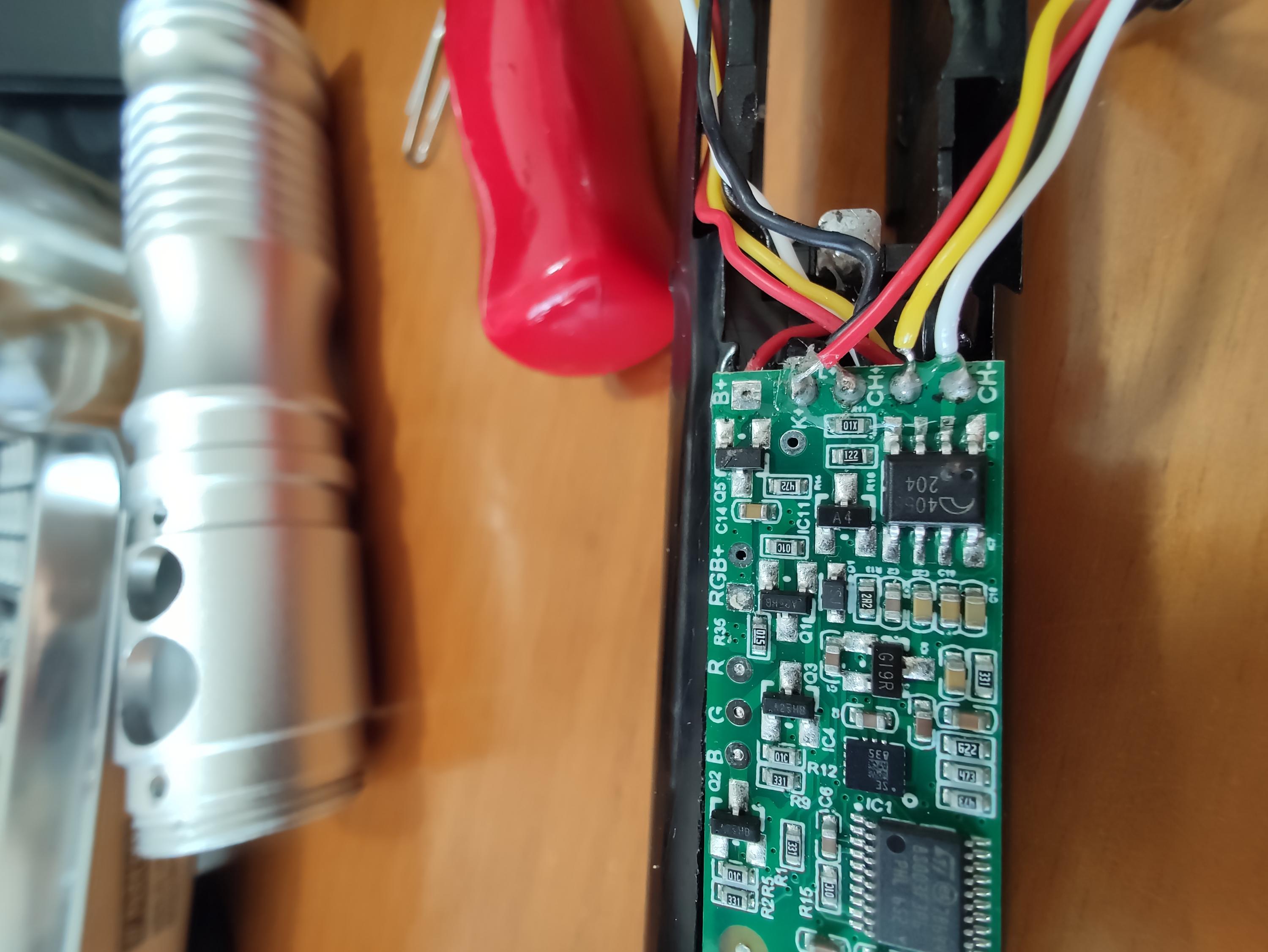

            I see it know. This should be good to replace it
            https://www.ebay.it/itm/173122873712...wAAOSwjXNaa3-b
            My doubt stay for the 4056 chip.
            for exaple this is good?
            https://www.ebay.it/itm/363356997400

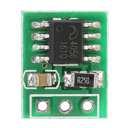

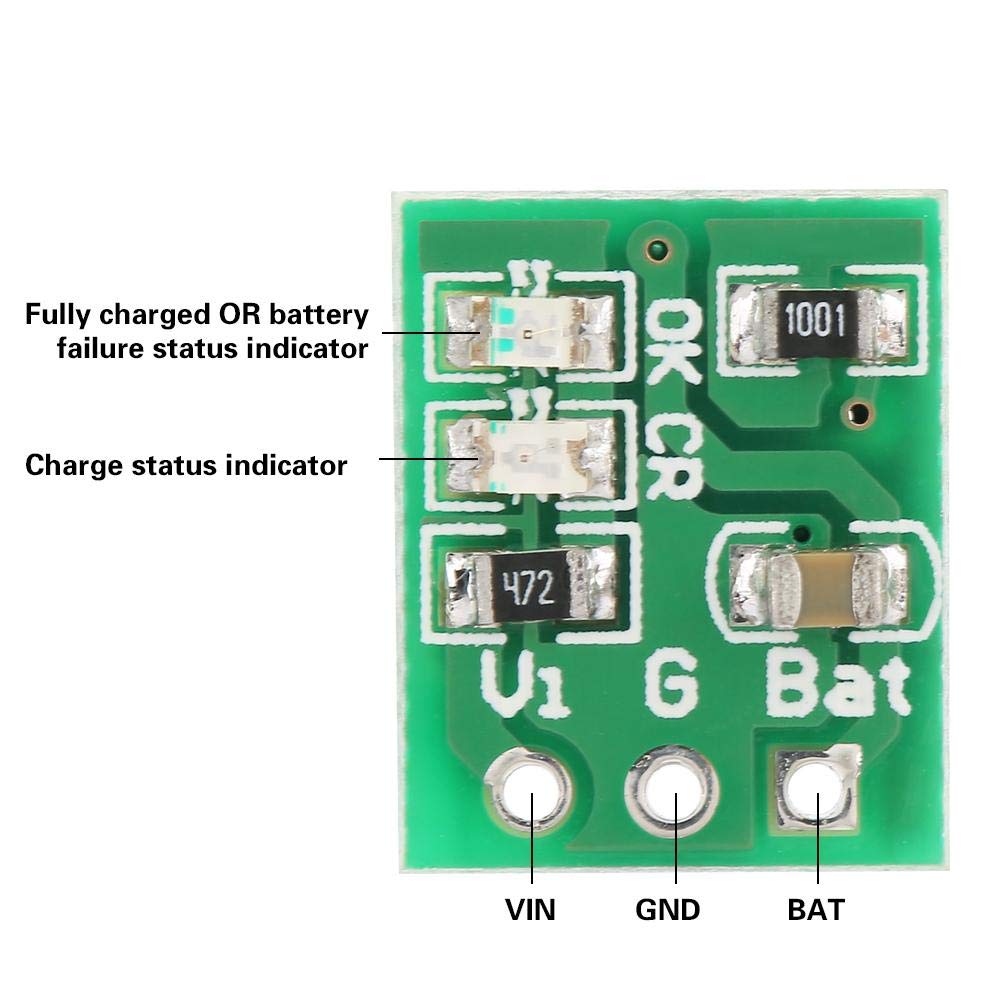

                The tp4056 is a li-Ion charging ic, Here is a link to a charger module with the same brand ic https://www.amazon.com/Battery-Charg.../dp/B07PDLPNDX
                The prog (pin2) is just done with a resistor to set the charge current, no programing required. It looks like a bit of hot glue on Q5 and not cracked

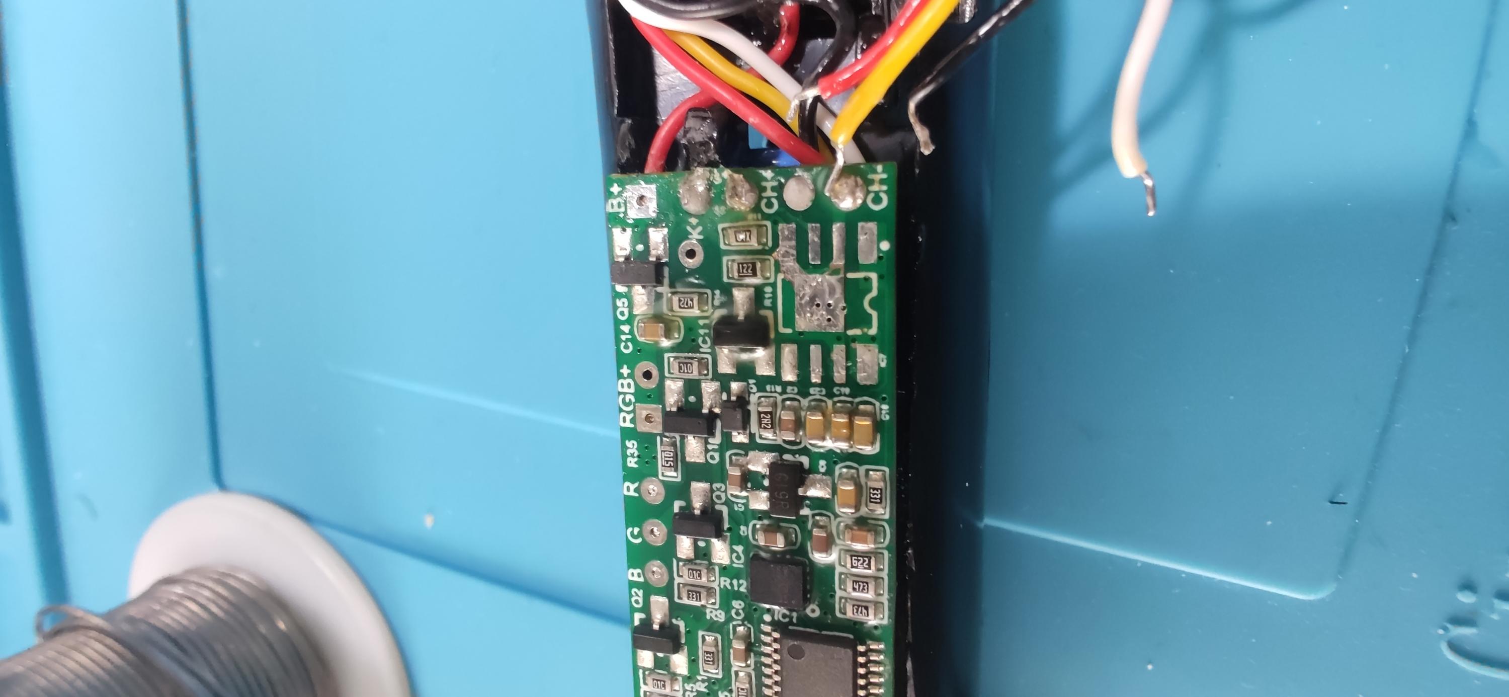

                    I desolder the chip and this is what under. It is normal to have the connection between the Central bad and the top right and the third right?
                      • 31265
                      Re: 4056 Chip
                      that confirms it's not a tp4056 charging chip

                        Is there a chance that cleaning the pads has detached the green layer? That I did damage? Cause the chip in the pics you posted is exactly the same as mine. The only difference is the "1610"

                          It is a ME4056SPG from Microne, here is the datasheet, see page 16 (Suitable for charge status indicator, which the application not need battery’s temperature detection)

                              Yes, That is the same ic, the last number (1650) is a date code.

                                Ok guys I replaced both the IC and the other chip (a diode?). Now the laser saber is charged properly and the light works fine. But I have a problem. The saber doesn't emitt any sound but when it turned off. So the speaker works. It should be make sounds when you move it quickly. Any ideas?
                                thanks
