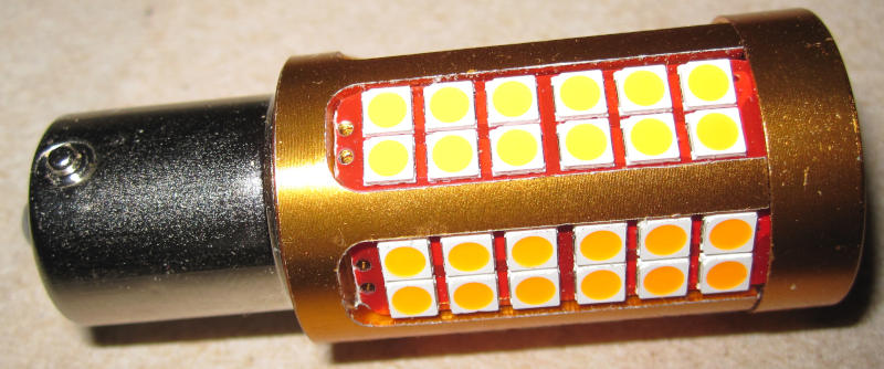

    A 2200lm 7057 LED car lamp...
    I ended up finding one of these bulbs and tried lighting it...
    WOAH yeah I think 2200lm is about right - it's blindingly bright. It's yellow unfortunately, but that's expected to be 7057 replacement.
    From what I found it's 12V 1.75A so this thing is dissipating about 20W, though unsure how much is light vs heat. It does get hot fast - cannot hold onto it in about 20 seconds. Not sure how much of the metal frame is actually functioning as a heatsink or not.
    I do wonder how long this thing will last if I run it 100% duty cycle, I suspect it was intended for blinkers with much lower duty cycle?
    Note that at 2200lm, this is brighter than a 100W incandescent rated at 1600lm.

    Re: A 2200lm 7057 LED car lamp...
    If you were to run it more than 50% of time then put a current limiting resistor or a PWM controller which would be my pick
      have had to dispose of a few that look like that cos they end up falling to bits . then i replace with proper bulbs .
        What was the failure mechanism when they "fall to bits"?
        It looks like a lot of different bulbs are out there, would be nice to tell which specific ones.
        I found out the metal base seems to be conducting part of the heat so it's definitely doing something to conducting heat around.
                    It looks like 3 LED's in series strings and 16 groups of those, for 48 LED. It's to get ~9.6V LED and then resistors to drop the 12-14V down for that.
                    That looks like about 110mA/LED and dissipating maybe ~16W plus the resistors ~5W.
                    It's just the heat is too much if they were lit all the time, i.e. a brake light in a traffic jam.
                        Since it's yellow, it was intended to be for turn signals.
                        There is one heck of a lot of LEDs on the cob: there's 78 total - 6 faces of 12 plus another 6 on the end - so 26 strings of 3.
                        Current limiting Resistor(s) is(are) probably in the core somewhere. Does not appear to be a PWM unfortunately.
                            How hot is too hot for LEDs..
                            Apparently commercial heatsinked LEDs fail the "if you can't put your finger on it you need a fan" test...
                            Then again it seems any LED lamp that produces more than about 100lm (1W) eventually gets hotter than you can leave your finger on.
                                      If there is no duty cycle listing written, 100% duty cycle must be assumed.
                                      Fog, head, dome, courtesy, etc. lights might well be 100% duty cycle...
                                      Aren't yellow lamps frequently used for fog lights too?
                                        I've found it's a heat-limited situation. An incandescent bulb can run quite hot, much hotter than electronics. So expecting to dissipate 20W of heat in an enclosed light fixture, well it's going to just be too hot. Especially on a hot summer day. The limit is melting the socket and reflector.
                                        My limit for touch is around 160°F/80°C and LED's are run even to 100°C in cheap crap.
