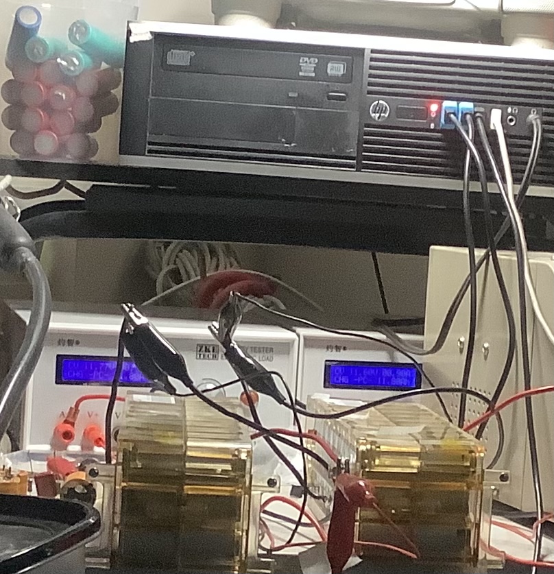

                Update on these battery packs —>
                https://batteryhookup.com/products/2...cents-per-cell
                The results so far is over 9000 milliamperes hours and still at 11.54 ( 12.60 volt battery pack ) [ but only charged to 12.40 before load testing ] volts on the two battery packs under test right now very good results for something that is used and bought for salvage
                I have not decided what I going to do with the ones that the BMS balancing protection board are bad because I do not know what voltage I going to need but I do need a 32 volt BMS balancing protection board for a solar LED lighting yard project that I want to do
                I am having a hard time finding a 32 volt one I can find a 36 ones and if I go this route then I will have to use a PWM controller to reduce the voltage to limit the current to the LED lighting panel which I am not totally against but I would have rather just use a current limiting resistor for this project
                I will post the results when the testing is done with the pictures of the battery pack and how I have it setup
                I would have posted the link to them but they are not listed anymore so they are out of stock or they are getting any more of them ( the price was very reasonable for the name brand batteries ) so I might have bought what they had left
                I also bought some 12.60 volt batteries packs that the results are decent for the way they are set up
                These are nice they have a very simple protection board that seems to work I have not charged them all the way up yet ran out of time yesterday afternoon and did not want them to charge by them self until I have done this a few times to make sure that the protection board works correctly or not
                I also bought some 16.80 volt batteries packs that the results are decent for the way they are set up
                One battery pack was totally useless because 4 cells are leaking or showing signs of leaking and two more of that did not show signs of leaking but all are completely dead no resistance reading which means that the CDI has tripped two of that are left are at about 2.volt something but these are a non brand name batteries which I not going to trust for anything that has any real current draw on it
                BMS balancing protection board on these are simple but I do not have the connector for them so I have to remove the BMS board and replace the connector to what I have and do some testing on these BMS
                I will post some pictures of these battery packs later on today

                  I have a correction to make I was not discharging the batteries I was charging them to 12.40
                  One note these batteries start a about 2.5 volts for each cell or maybe a little bit lower than that
                  When I first started charging them because the battery voltage was so low I only charging them at 80 milliamperes when they reached about 11 volts
                  ( one battery pack at a time because of the software of this battery testing machine I can only see one screen on top I would have to click on to the other screen because I was doing other thing I only wanted to see real quickly where and what the results are at that given point in time and do a temperature check as well )
                  [ someone might think that I could open two screen on the computer and I could have done this but I was also using the IMAX b6 charger at the same exact time but this software for the battery testing machine has slight issues when you open two separate screens it does not always want to behave it self in this mode of operation I do not feel like dealing with it so I don’t ] plus it is more difficult to save the individual screen and bring them back up for use later is another reason I do use dual screen
                  I took off the charger and let them sit for a week to see how much they dropped off in voltage which was not much
                  Through out this hole process the battery have not heated up at all
                  I will load them at 1 amp and charger at 1 amp and see if the results are any different from the way I have been charging them to bring out of sleep
                  When I have finished this charging/discharging cycle then I will discharge at 2 amps and charge them at 2 amp which I will have watch closely for any issues that might arise
                  I have no plans to use any current higher than this for charging or for discharging them
                  On another note I only do battery testing on my days off when working on battery that I am not sure of what and how they will charge or discharge ( so I can sleep in peacefully with out worrying about what happens to them when I am sleeping )
                  Disclaimer
                  Your results might be different than mine if you were to buy these battery packs because I have bought some that all the battery cells have had issues so please be aware of this when thinking about buying some if you have a use for the battery holder and for the outside case then it worth the money as far I am concerned if the batteries are also good but the BMS balancing protection boards are bad you are still ahead and if everything works you get a real good deal for your money but you have to have time to test the batteries and the BMS balancing protection boards
                  and
                  I would highly recommend that you at least have IMAX b6 battery tester or something similar at a minimum and that you use the plotting software so you can see the testing results ( this battery tester is very basic and the software is also very basic )
                  When this comes handy is because I have tested a lot of batteries before and I know what the charge and discharge curves are suppose to be and look like I know right away if the battery that I am testing is going give a headache testing them meaning that I have to adjust the current so that the curve cycle looks correct so I do not have batteries that start heating up on me and I have keep very close eye on them if I have to turn the current way down so the curve looks correct for that type battery because the battery testing machine that I have does not have a temperature sensor ( this a pit fall of this machine )
                  If I known that the battery might have a temperature issue charging them I will use the IMAX b6 charger for those batteries in question

                    Update for the two battery packs that I have been testing for several days now
                    22 amp hour @ one amp load and another 2 hour above 500 milliamperes load of useable power very good results for these batteries well worth the money ( $14.00 each plus shipping $16.99 for both battery packs ) I paid for them unfortunately the BMS balancing protection board was not working correctly so I will be parting it out

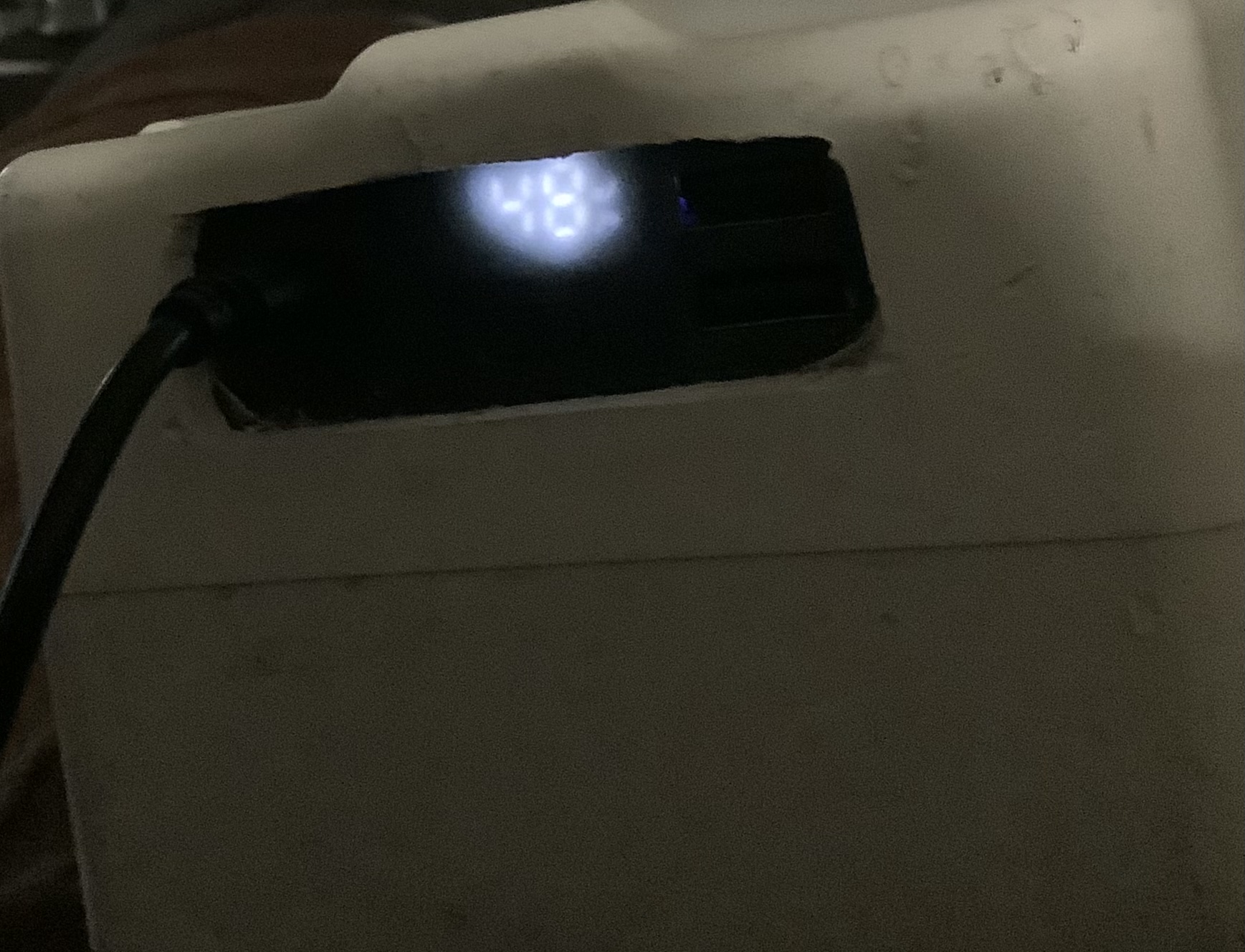

                                    Here is a project for what I did with one of these battery packs
                                    Right now it has the Boston Power batteries in but I am going redo it and use the 18650 batteries in it instead
                                    And repurpose the Boston Power batteries for something else that requires more current and more running time with a better BMS balancing protection board
