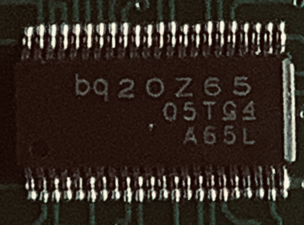

                    Here is an update on this item
                    https://batteryhookup.com/products/n...-2900mah-cells
                    The BMS protection board specifications are as follows
                    Cutoff voltage at discharge is 7.9 volts cutoff voltage on charge is 12.81 volts ( this is a little higher than I would like but it not as bad as I seen before but the lockout feature is what I like about this type of controller )
                    The fuel gauge is weird in that from 9 to about 10.50 volts it flashes one LED light until it get above 11.50 volts when it gets above 12.00 volts all 5 LEDs are on
                    The last picture is of the controller ic chip
                    Here is the data sheet for the controller ic chip
                    When I put the power supply wires on the BMS protection board and put it back in the enclosure I will recharge the battery pack again to 11 volts and then start the charging cycle again but keep pushing the fuel gauge button to get a more accurate idea of what specifications this part of this circuit has for my own information I will also post the results
                    One final note about this BMS protection board is that when it has reached the cutoff point and you discharge it a little bit to reactive the charging mode it is still locked and will not allow you to charge it until you get below 12 volt before it reactive the charging mode very interesting the way this BMS protection board works
                    I will post some pictures of the BMS protection board and the power supply wires and what it will look like after it is put back together
                    I have a couple of solar panels that I want a BMS protection board that would not allow the batteries to become over charged I found what I was looking for in a BMS protection board
                    One note the cutoff voltage is not 2.640 volts the cutoff voltage voltage is actually 7.90 volts
                    The amp hours are 9.604 which is what the data sheet says that it should be for 3 cells in parallel
                    This is the best battery pack that I have bought from Battery Hookup so far
                    I only had one other battery pack that I like the BMS balancing protection board unfortunately I only have one pack that is this way the other battery packs were only BMS protection board but it was only a 8.2 volt battery pack not going to be able to use it on a 12 volt solar panel because I only have one battery pack that is that way
