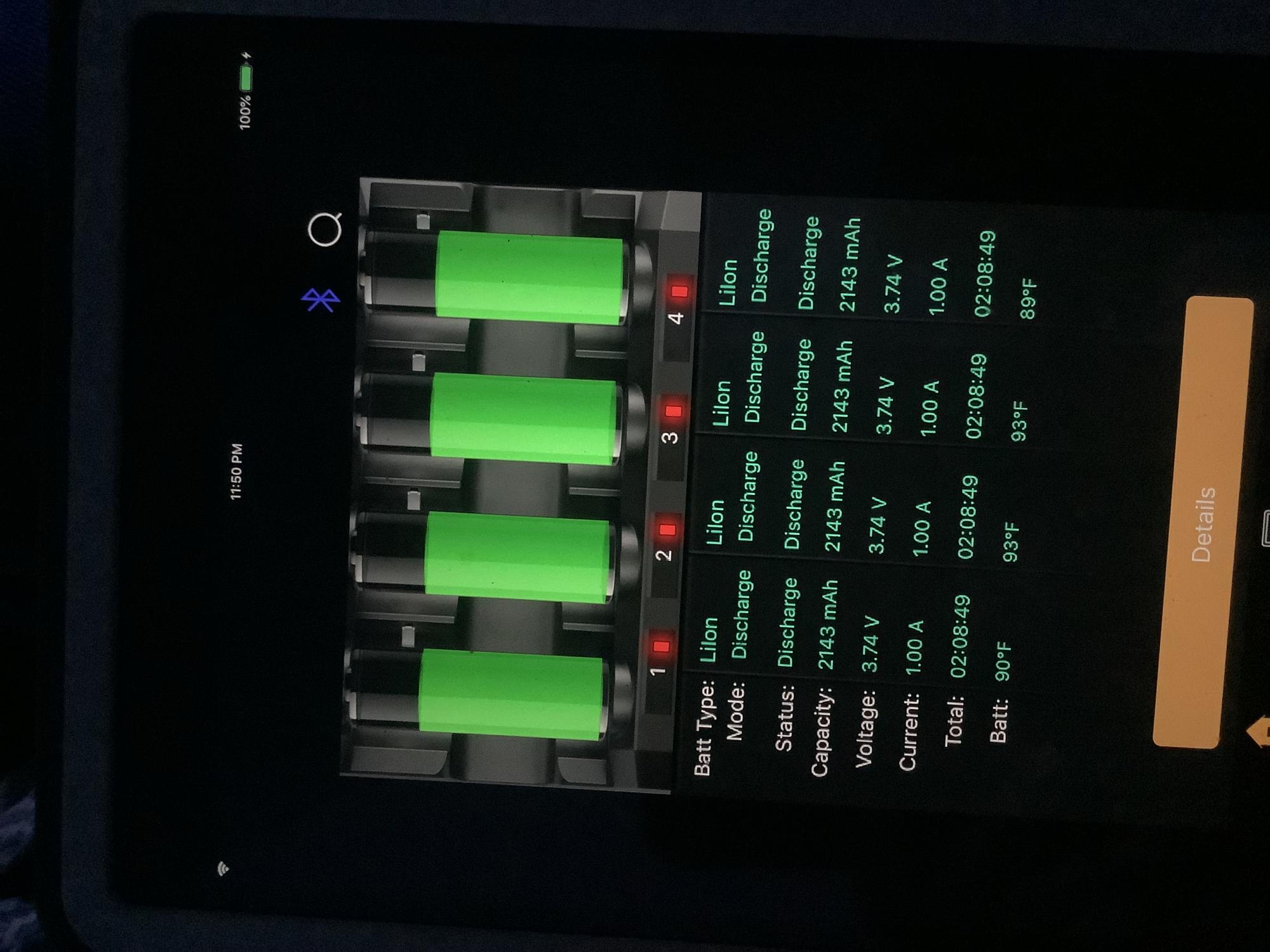

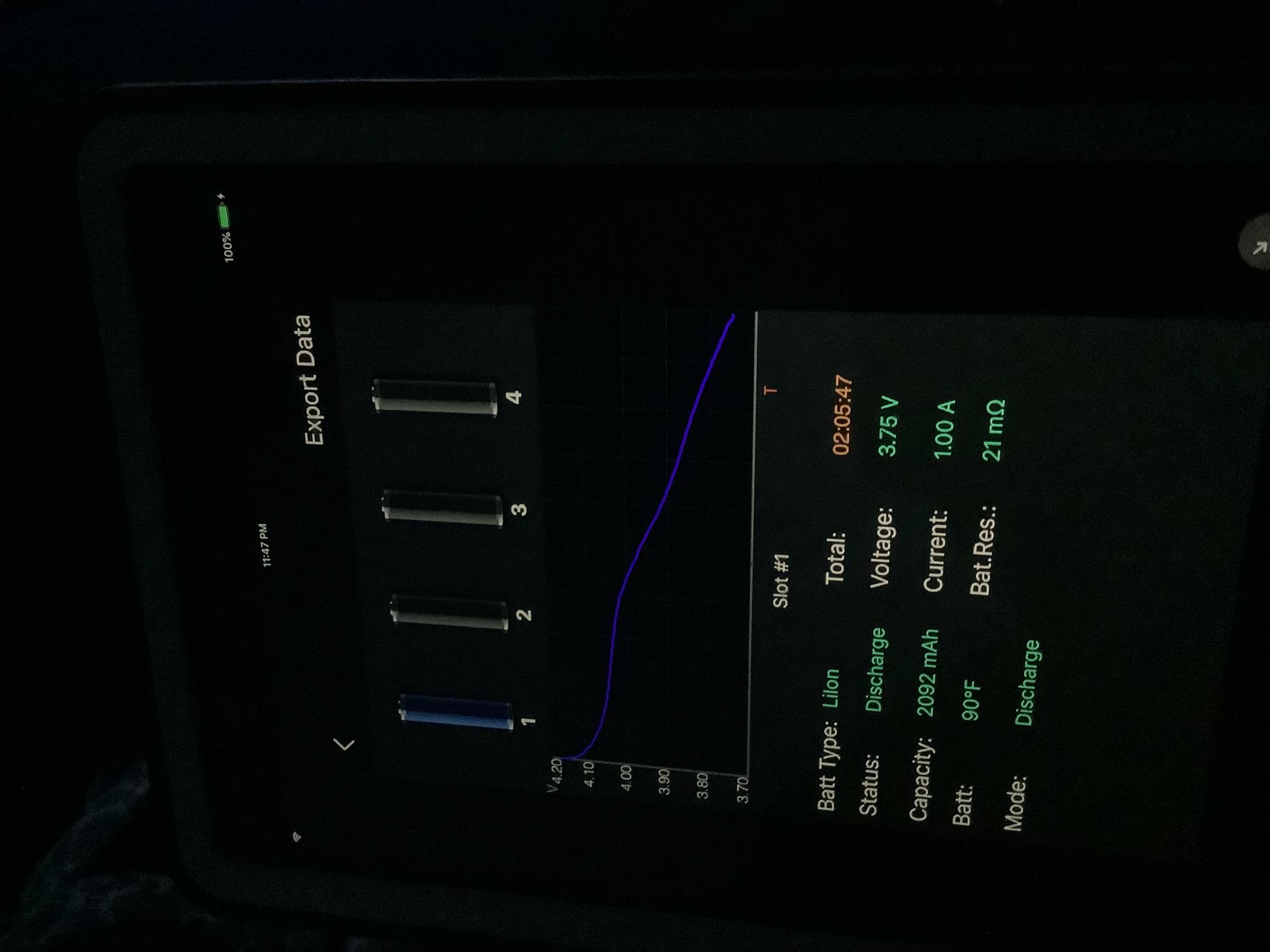

          Re: Here is a good used source for 18650 batteries
          Originally posted by sam_sam_sam
          Here is another offer from Battery Hookup
          https://batteryhookup.com/products/1...0-3-7v-5000mah 21700 battery cells $1.64 per cell X 110 battery cells in battery pack = $180.00
          I bought one of these to replace some tool battery packs that are very unbalanced
          It took a few hours to disassemble this battery pack but well worth the money because I have already charged up four of them and from 3.1 volts to 4.2 volts was well over 4 amp hours now discharging them down to 3.0 volts where the normal voltage roll of voltage usually is
          The voltage looked good on each battery cell bank very balanced between battery cell banks
          The temperature of the battery that you are seeing in normal for these battery cells it is set to read in *F instead of *C
          Test results so far are 1744 milliamperes hour at 3.83 volts @ 1.47 hours
          Parameter are as follows
          The graph function is very primitive but gives you enough data information to know if you have a problem with the battery cell
          SkyRc MC3000
          charging voltage 4.2
          resting time is 240 minutes to allow enough time for battery temperature to reach room temperature again for the second phase of the testing
          discharging voltage 3.0
          amperage is set to 1.00
          battery temperature cutoff is set 40*C
          The temperature that you are seeing for this type of battery cell is normal it set to display in *F but you have to set it in *C
          One note the temperature reading on the last battery cell is always a couple of degrees off from the other battery cells I am thinking that just a little off because even when there no battery in it it always shows a couple degrees different
          One other note the results are being shown on a very old iPad that is not supported by Apple anymore but it good enough for doing battery testing for this battery testing machine iPad screen is set to not to shut down the screen meaning that it set not to shut off unless I use the power button to turn it off / because if it not set this way when you wake it back up sometimes it resets it self and you lose the data
          My other SkyRc battery testing machine is also the same way you have to keep the screen from going off or you lose all the data as well it the one that can do 6 battery cells for up to 24 volts battery packs
