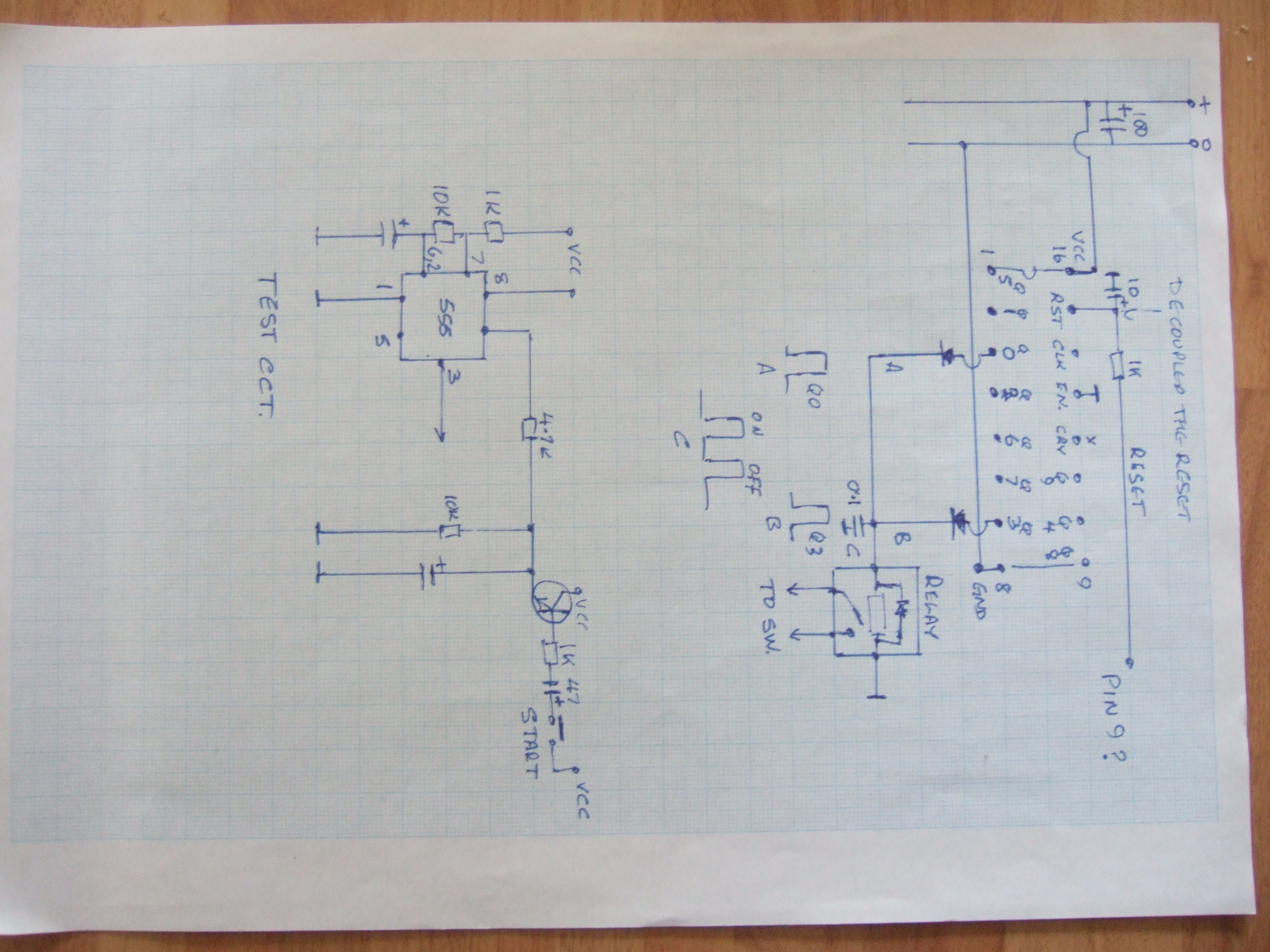

    I have been trying to make a counter for my vehicle alarm .I need to reduce the pulses that operate the hazard warning lights.
    Because of the ECU you cannot connect directly to the lamps ,so I fitted a relay across the hazard switch. This works ,but because the number of pulses are odd this causes the lamps stay on ,and you have to switch them off by pushing the switch once.
    I had a couple of ideas ,one was to use a couple of 74121 monostable ICs to give me 2 pulses.
    The circuit I came up with is a Decade counter that uses counts 0 and 3 summing these together gives me the 2 pulses I need if I feed back count 4 or 5 as a reset
    Occasionaly the second pulse returns to a high causing the relay to stay on, ,it seems like the reset might the the problem .
    On the TI data sheet it does show a circuit using a 4001 to reset the IC.
    Any thought on how I could solve this ?

            • barry wilkins
              • Aug 2009
              • 172
              Re: 4017 counter reset problem
              Here is a picture of my first design

                    In your first circuit, I would make some changes, such as adding a driver transistor for the relay because a 4017 has weak output drive a few mA. It would be a circuit that either counts to one or two. It depends if the alarm has a signal with a level for when "on", so you could add a gate to make the counter go to one or two depending if the alarm is set on or off.
                    • barry wilkins
                      • Aug 2009
                      • 172
                      Hi think you are right about the transistor ,just knocked up a circuit to try ,a capacitor about 10 uF and a IRFBC30 mosfet (got lts of these) .
                      The output from the counter is now AC coupled so if the last count stays high it should not matter
                      Been thinking I am using the wrong type of counter,perhaps one that has a clear input would have been better
                      Been very busy last couple of day sorting out the SOVOS Tv for a friend ,what a pig to work on.
                      What I do need to do is to get Multisim working on this pc which is new.
                      Barry
                      • barry wilkins
                        • Aug 2009
                        • 172
                        Thinking about it I decided to use two transistors in a darlington configuration .seems to work OK .
                        Next step is to try it out.
