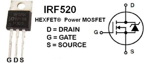

    You're using a p-channel schematic drawing again for the n-channel irf520...

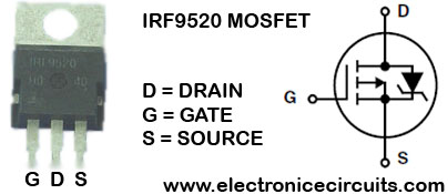

                  The simulator is out to lunch, the 10MEG is too large and the mosfet drawn as P-ch, and the body diode would just stay on, never letting Vout go above 0.7V but the graph does not agree. It looks like a poor simulator.
                  The Falstad simulator is better for understanding circuits:
                  https://falstad.com/circuit with many examples https://falstad.com/circuit/e-index.html
                  IRF520 has leakage current of over 10uA so a 10MEG would not work.
                  For sanity, the IRF9520 is not a IRF520.
