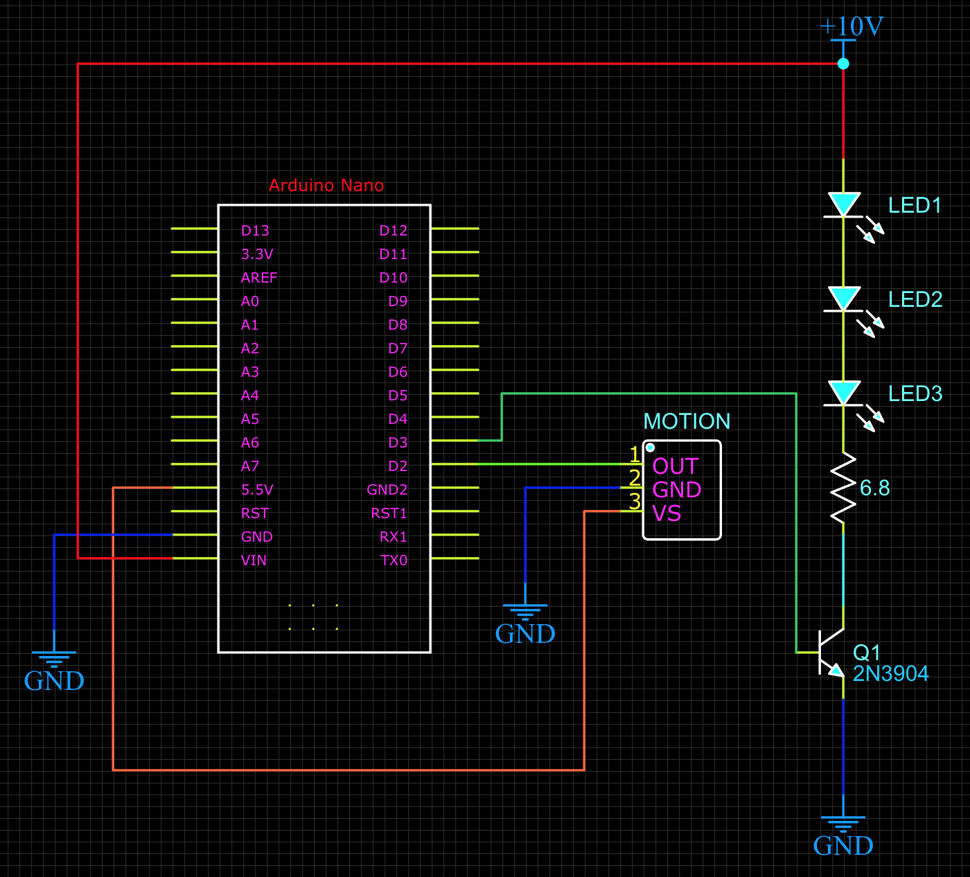

    I made a small project where a motion sensor triggers an Arduino pin and when the pin from the motion sensor goes high, another pin that's connected directly to the base of a 2N3904 goes high, which switches some LEDs through a 10V source.
    When I breadboarded the project, it worked perfectly. But now that I have it soldered onto one of those generic project PCBs when the circuit is idling and there is no motion triggering the pin, the LEDs light up ever so slightly, indicating to me that the transistor is still allowing current to flow from emitter to collector even when the base is at 0 volts. I even tried shunting the base directly to ground and the behavior did not change.
    Any idea what the problem might be?
    Here is the schematic:
    sigpic
    • 31283
    Re: Current flowing through transistor even when base is shunted to ground.
    i dont know the issue, but you may have damaged the transistor - you need a resistor between the base and the mcu
      You need to have bias resistor for he Base of the Transistor.
      When is the Voltage at the B-E when the D3 is LO?
        Transistor is now damaged and leaking due to missing base resistor. Nano's output voltage should be low enough to keep it in cutoff.
        Probably should have used a 2N7000 if you really don't want to put a resistor there. That is also to possibly protect the Nano's output, too.
          That would just serve to limit the current through the BE junction. Presumably, the output impedance of the MCU is high enough that the "resistor" is actually part of the MCU.
          (The OP would note that the output of the MCU swings between 0V and ~0.6V as the BE junction clamps Vo(h) to that level.)
          A wiser approach might be to add the resistor AND a pulldown at the base to cover the case when the MCU is "in reset" and the pin may float before the software has a chance to configure it as an output -- assuming that is a possibility (I don't use arduinos)
          Note that you want to size the pulldown so that it "soaks up" any leakage current from the MCU.
          Also, looks like the OP is driving those LEDs pretty hard... a few hundred mA?
              I assume you mean a resistor between pin D3 and the base of the transistor. What should its value be, and what does that resistor do?
              The B-E voltage when D3 is low, is 0.002 according to my Fluke meter.
                    It limits the current going into the Base. It's the same reason you don't connect an LED directly to a power source without a resistor or some other type of circuit to limit current - the diode/LED will draw a lot of current and burn out.
                    For the purpose of driving those LEDs with that transistor, a 1-KOhm resistor should do fine (though I imagine anything in the range of 510 Ohms to 5.1 KOhms would work OK too.)

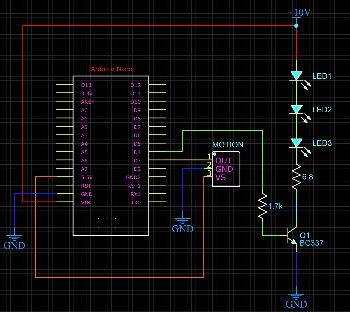

                                I did change the circuit. Here is the updated schematic:
                                Based on what you're saying, since the output of pin 4 is roughly 5 volts (minus the .7 for the B-E junction), then when I divide that by 1.7k, I get a current of 2.5ma ... which shouldn't be enough to saturate the transistor. However, the LEDs are plenty bright enough (so much so, that you can't look at them directly without causing some discomfort - but they will be diffused in the final application of the circuit) ... so since I'm only driving the base at 2.5ma (the source is capable of 40ma), does that mean that the LEDs are not getting the full current that I originally intended?
                                sigpic
                                    "Which is technically what I'm doing here. However, hypothetically, if your source voltage for the base of the transistor was ... let's say 5V but it was capable of supplying 5 amps of current, without that base resistor, wouldn't it fry the BE junction?"
                                    Do the experiment, set power supply to 5V with 5A limit then apply it to the E-B junction of spare Transistor you have and see what happen.
                                    " so since I'm only driving the base at 2.5ma (the source is capable of 40ma), does that mean that the LEDs are not getting the full current that I originally intended?"
                                    Just check the Vdrops on the resistor and the Vdrops on E-C junction then you can calculate what the current flow is and if the Transistor is in saturation or not.

                                      I followed everything you said here, thank you. I get it now... my final circuit has a BC337 and its datasheet lists Hfe as a function of collector current. The range of Hfe being from 100 to 630. Since I'm using a resistor at the base of 1.7k and assuming a 5v output from the Arduino pin, my Ibe would be 2.5ma. The minimum gain is 100 so worst case, I can have 250ma at the collector, which would be limited by that 6.8Ω resistor in series with the LEDs, so since my actual source voltage for the LEDs is 9.8, and considering the voltage drop Vce, I am most likely giving those LEDs less than 150ma, which means they are being driven well within tolerance.
                                      What I also realized reading your post, is that it would theoretically be possible to drive LEDs without a series resistor by properly selecting your base current and knowing exactly what your H value would be at that base current and voltage... which would take some experimentation to determine, but in theory it would be possible, would it not?
                                        [I]"Do the experiment, set power supply to 5V with 5A limit then apply it to the E-B junction of spare Transistor you have and see what happen.
                                        Do I need a complete transistor circuit to perform the test? In other words, do I need a circuit to complete C-E before B-E will saturate? I'm thinking not???
                                        sigpic
