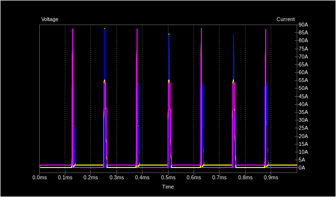

      Is this okay? (Simulation of H-tree crossover current...)
      Well, no, but I probably can fix this in software if I can't speed up the edges
