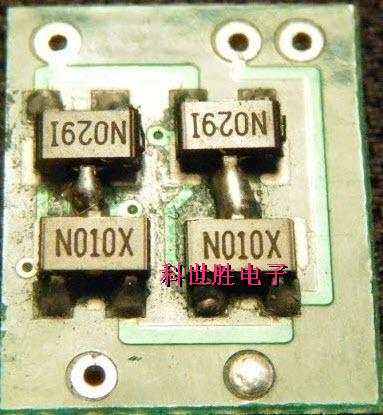

    i have a video switch box with 3 AV outputs, this is a rear double screen video system in my car, the switch box started to smoke so unpluged the 12v supply,
    on inspection of the internal board, i have a N010X SOT23 that has burnt,
    my problem is that i can't find any of these transistors with the same markings,
    i have no idea of the values.
    maybe someone here will know or maybe there may be an alternative, that i can replace with. added this pic that i found with google.
    thanks for any help you can give in advance

    They seem to be NK2302A
    • redwire
      • Dec 2010
      • 3910
      Re: SOT23 transistor HELP!
      I find:
      N010X alternates APM2302,SSS2302,ME2302,AP2302,STS2302,MT2302.
      N029I alternates STS2304,Si2304,AO3406,NDS355AN,AP2304,APM2306,CES2304.
      Is there a pic of the board, to see if these switch power for battery charger/camera or what. Some mosfets are only 16V rated which is too low for a car if switching 12V power.

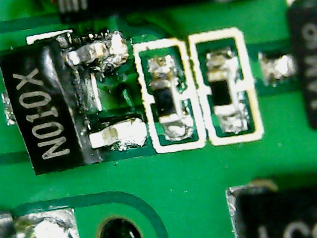

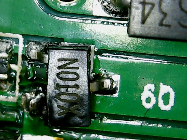

          here is a pic of the board, i have arrowed the N010x,
          i thought it was N channel, but during my search have also come across P channel ?

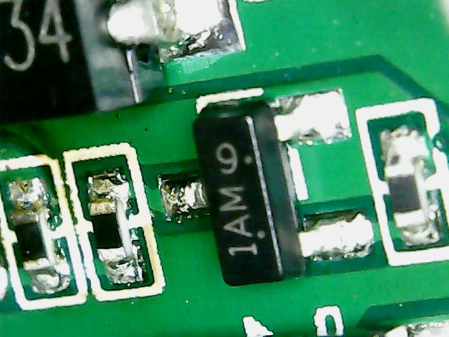

            also taken some close ups

              I would guess it is a P-channel mosfet, Best to check the voltage on the source and drain pins, with respect to ground.
              The 1AM seems to be a (S)MMBT3904L
                It looks like a mosfet switching remote power to something. I would check the load it supplies/wiring is not shorted, like a second camera or the LCD screen. The mosfet would not just cook like that on its own because there are gate resistors. I would say it was overloaded and where is the fuse.
                You would have to check the drain and source traces, where they go to confirm if it is P or N channel. Cathode of D1 looks like +12V power so if Q9 source goes to that (power) and drain goes to the load, it is a P-ch high-side switch. Q9 drain goes to three vias, so I would follow those- they probably go to the load so that means it's P-ch.
                Samhop semi taiwan does not give marking codes, they have a STS2301 P-ch. I would put in AO3401.
                Lisen PBC3117-1-01 Main V1.1
