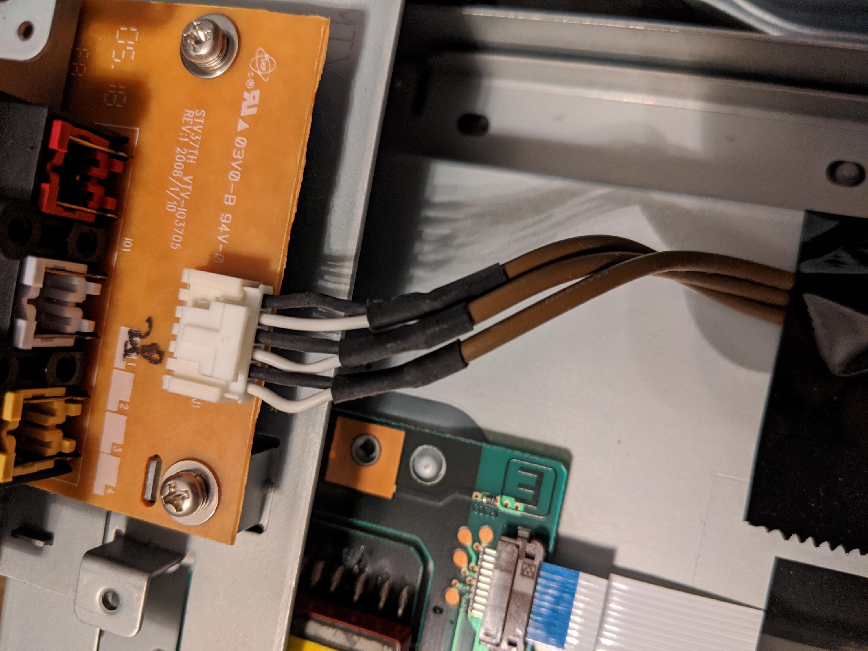

Where to buy shielded cables like this one?
  • zape
    • Jul 2017
    • 176
    Where to buy shielded cables like this one?
    For audio and video applications.
  • eccerr0r
    Solder Sloth
    • Nov 2012
    • 8697
    Re: Where to buy shielded cables like this one?
    I don't know about 75-ohm (RG179?) typical for video, but RG174 which is 50 ohm and available everywhere is usually really cheap if you want to make your own cables.
      • 30983
      Re: Where to buy shielded cables like this one?
      that;s probably lap-screened audio cable
      • zape
        • Jul 2017
        • 176
        Re: Where to buy shielded cables like this one?
        I will be using these for RGB mod. No connectors needed as i will be soldering these anyways.
          AO4601 AO4601L Transistor (Applications Laptops) Datasheet
          AO4601 AO4601L Transistor (Applications Laptops) Datasheet
          Complementary Enhancement Mode Field Effect Transistor
          The AO4601 and AO4601L use advanced trench technology MOSFETs to provide excellent RDS(ON) and low gate charge. The complementary MOSFETs may be used to form a level shifted high side switch, and for a host of other applications. Standard Product AO4601 is Pb-free (meets ROHS & Sony 259 specifications). AO4601L is a Green Product ordering option. AO4601 and AO4601L...
          11-05-2024, 08:21 AM
        • Ama Chur
          Panasonic Viera LC470EUN (SE)(M2) T-Con issue?
          by Ama Chur
          After watching some youtube videos and checking some forums, I'm at a loss. With both ribbon cables connected, we have no image. With the left one pulled out, the screen is black and white, split down the middle. With the right cable removed, it is all black. Backlight is working fine and we have sound and can open applications. We are strapped for money right now and are hoping to repair whatever the issue may be. I think the TV was manufactured in 2012, so I'm aware that may not be possible. Edit: Found a single vertical line of blue pixels on the left side of the screen with one of the ribbon...
          02-21-2025, 08:12 PM
        • Tr0ll
          by Tr0ll
          Original T-con:
          First replacement T-con:
          10-07-2023, 07:48 PM
        • japlytic
          Certain "Class 2" HDMI cables can be marginal at 4K 60 Hz
          by japlytic
          For some time, a "Class 2" HDMI cable (part number BN39-01583B) supplied with a Samsung 4K 60 Hz display sometimes causes the display to overlay a few horizontal lines of flickering pixels of random colours and sometimes drops out, particularly on content requring HDCP.
          Since changing the cable to a thicker Class 2 unit, this problem has not occured again - do you know of other marginal "Class 2" HDMI cables supplied with displays?
          09-06-2023, 08:50 PM
        • magicpc
          Patents for service cables
          by magicpc
          Hi, will you share your patents for connecting e.g. xbox or ps4/5 to a laboratory power supply? I'm curious how these cables are made. Or maybe you have other patents for connecting other equipment?
          04-24-2023, 04:24 PM
