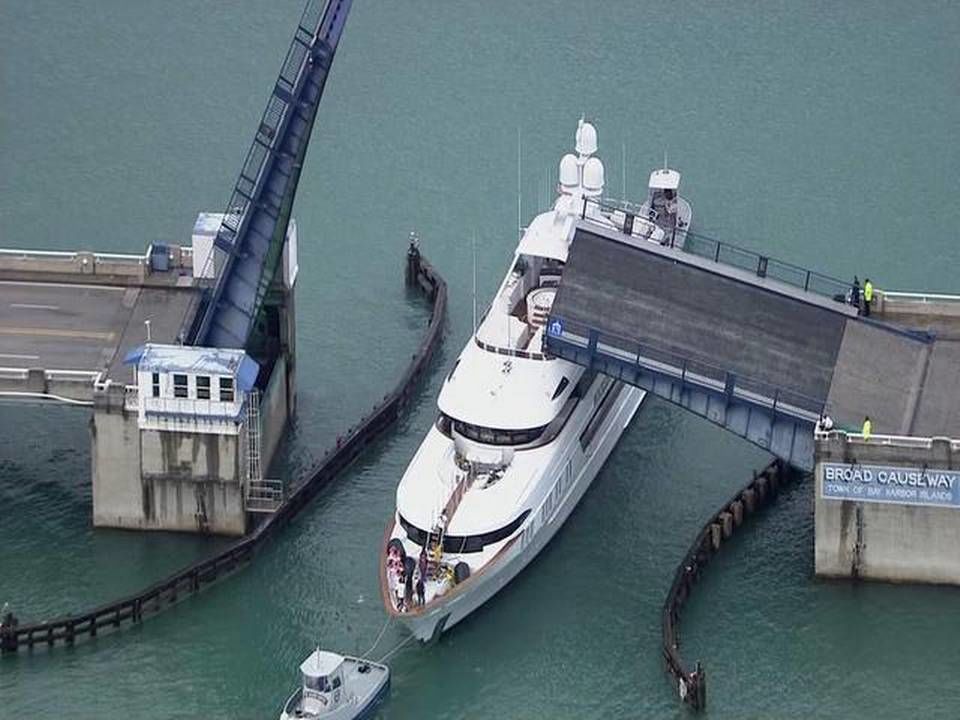

                              Is this a split bridge? There's extra code to deal with one end malfunctioning (thanks for wrecking my yacht) and collisions, power failures etc.

                                No, it's not quite a split bridge like the one pictured, though one of the compounds DOES have a single-leaf (?) drawbridge as part of its system. This is actually a water-lock: it lowers or raises the water level depending on where the ships come from - either upstream or downstream. The waterway is split into two right down the middle, so there's one water lock on either side, that means 4 individual gates, plus other devices to regulate pressure and water level and stuff. The control tower sits on an island in the very middle of this whole setup, between the 2 locks. The bridge I mentioned is used to allow vehicles to get to the middle part if need be. Having visited this place many many times so far for other duties, I noticed this bridge is kept raised almost all the time because vehicles need to cross over only on very rare occasions, so it makes most sense to just keep it out of the way all the time, to decrease the waiting time for the ships. Personnel, on the other hand, crosses from the control tower in the middle to the banks and back by walking across the top part of the gates themselves, where a pedestrian bridge forms once they close. That's just backstory to better explain this whole compound. It's all academical really, because there's no way you can be expected (make that "ALLOWED" ! !) to run all this willy nilly like that or even get close to the heavy duty machinery that runs it all. It WILL happen though, slowly but surely
