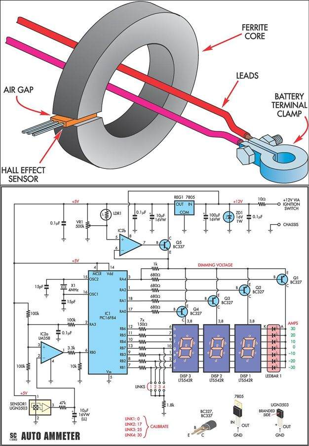

          Re: Car Ammeter
          OP I think you've asked the same question before:
          https://www.badcaps.net/forum/showthread.php?t=68684
          https://www.badcaps.net/forum/showthread.php?t=45512
          I remember seeing a circuit in an electronics magazine years ago, but can't find it. I was looking here American Radio History
          It's just an op-amp you need biased at 1/2Vcc to read + or -.
          This pic appears to be from Silicon Chip magazine 2002, where you make your own hall sensor.
          There are some cheap chinese car ammeters on fleabay and ali. They are all hall-effect sensor based.

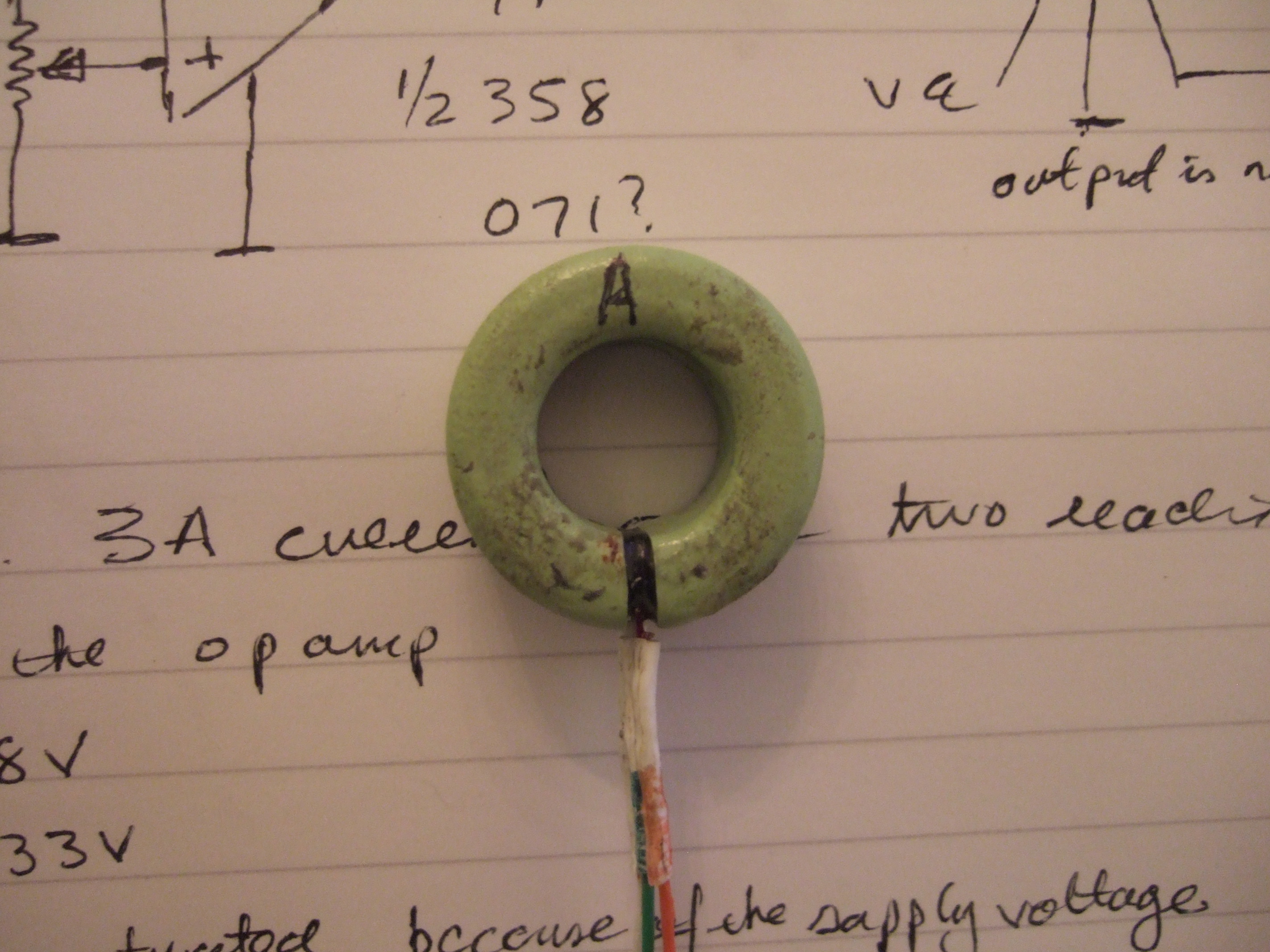

            Re: Car Ammeter
            Hi guys thanks for your posts
            Attached a pictures of the ferrite txr I made ,the output varies by about 3mV at a current of 3 Amps.
            Barry Wilkins

              Re: Car Ammeter
              How did you cut the air-gap in the ferrite, it looks very well done.
              You are using Allegro UGN3503 analog hall sensor? They are discontinued many years ago and the newer versions look interesting. F.W. Bell also has some I've used.
              1mV/A into the LM358 or OP-07 should work to make an ammeter.

                Re: Car Ammeter
                Sorry about the delay in answering
                I used a Dremel with disc looks like a normal abrasive wheel to me.
                The txr works OK not sure if there is some remance in the core ,having a slight zero drift ?
