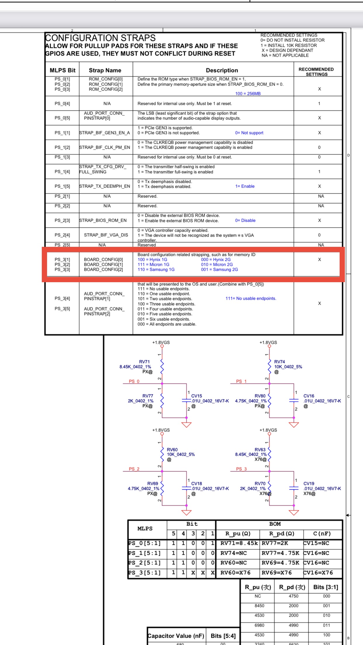

    Hi all i've been repairing discrete gpu on laptop lenovo g40 45
    The memory vram fail. And i decided to replace it
    The original memory is skHynix and i only have micron to replace
    But i'am struggling with memory strap
    I have an schematic but its unclear where the exact location to instal 10k resistors
    I also have the boardview but it's pdf version (not .brd or something like that)
    So basically it only show image and pad name no detail information
    Is there posible way to find where this strap location?
    I provided link for schematics
    Schematics: https://drive.google.com/file/d/1Iiz...0lnvz6hHJ/view
    Boardview PDF: https://drive.google.com/file/d/1J4K...sQ8PbSA9C/view

        Re: [Help] Finding dGPU memory strap on lenovo g40 45 laptop
        They are not 10k resistor. Resistor values are indicated in the bottom right table, to choose according to the desired configuration strap bits in the top table and to place according to the reference designators in the middle table.
          Sorry but in the top right corner was suggesting this 10k?
          • piernov
            • Jan 2016
            • 4435
            • France
            X = DESIGN DEPENDANT
