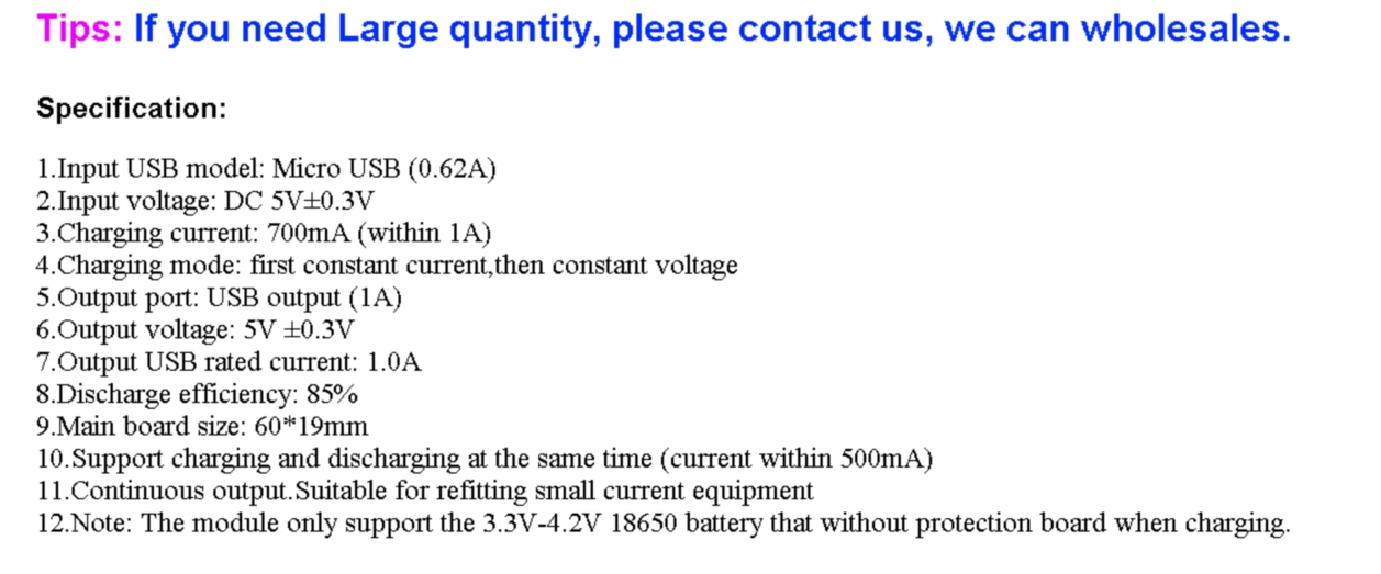

          You might find this USB charging board interesting
          https://www.ebay.com/itm/5V-1A-USB-3...53.m2749.l2649
          I bought some to try out
          I will post the results after I do some testing

            Looks like for 1S, and it's limited to 500mA output?

              If scroll down to the details of the board it says 1 amp unless you charge and discharge at the same time then it is 500ma
              When I test this board I will post the results and let you know what it really is

                500mA doesn't do justice these days... hoping for at least 1A preferably 2 or more...
                Then again 500mA is better than 0, I had a box that shuts off charging when itself is being charged...

                  Funny Chinese spec:
                  input Micro USB rated at 5V 0.62A
                  USB output rated at 5V 1A

                    Yeah, it looks like it charges slower than it can discharge?

                      Well here is some results for the USB charging board that I posted earlier
                      The one thing that is nice about this board is that it has a LED that lights when you have a load on it
                      But I think it has a few small problems the first one is that when you charge and have a load on it at the same time the charging current drops down to 350 milliamperes and a load I could not see how many milliamperes it was putting out because my tester was in the way but the board gets warm fast
                      When you have a one amp load the board gets warm fast but it put out one amp
                      When you just have the charger on it only it charges at 500 milliamperes and board is some what warm but nothing to worry about
                      So in the end results are if you keep the load under 750 milliamperes you might be alright
                      If you do not try to charge and have a very big load on it you might be alright
                      Is worth the money I paid for maybe depending on how and what I want to use it for
                      If I use it on non name brand batteries and not put a heavy load and do not care how long it takes to charge and do not want to spend a lot of money on test of concept yeah this fits the bill
