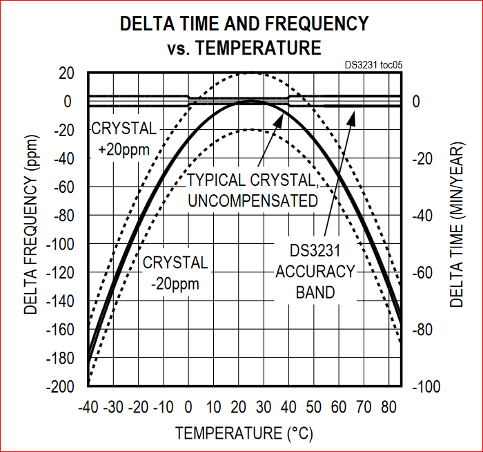

          A modern RTC like DS3231 has built-in crystal oscillator and tuning etc. and is very good I set mine maybe once a year.

              I can't afford the heating bill, lol. It has to be hotter than the highest ambient temp, say 35C and only HAM gear has it.
              I tried to calibrate a Casio watch, but it's cold sitting on the dresser and warm when you are wearing it, so I gave up.

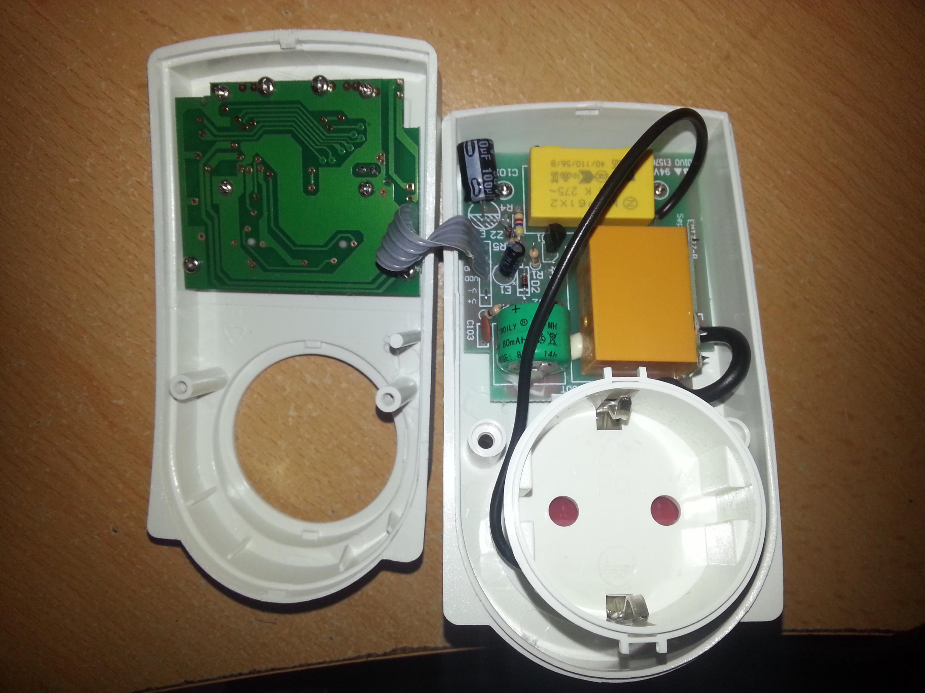

                        • Dannyx
                          CertifiedAxhole
                          • Aug 2016
                          • 3912
                          • Romania
                          Re: Improving a slow/fast digital clock
                          does the timer involve mechanical parts ?

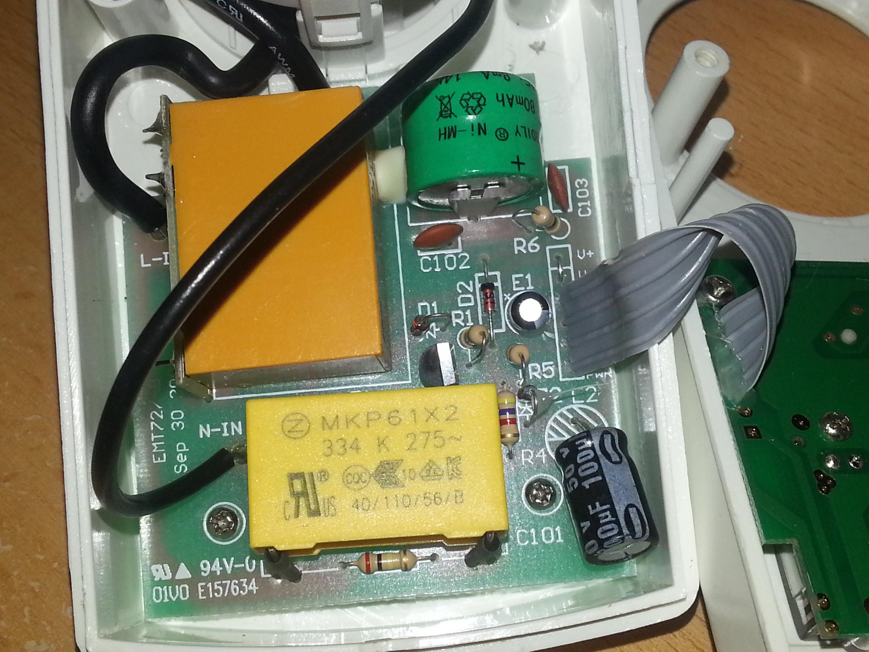

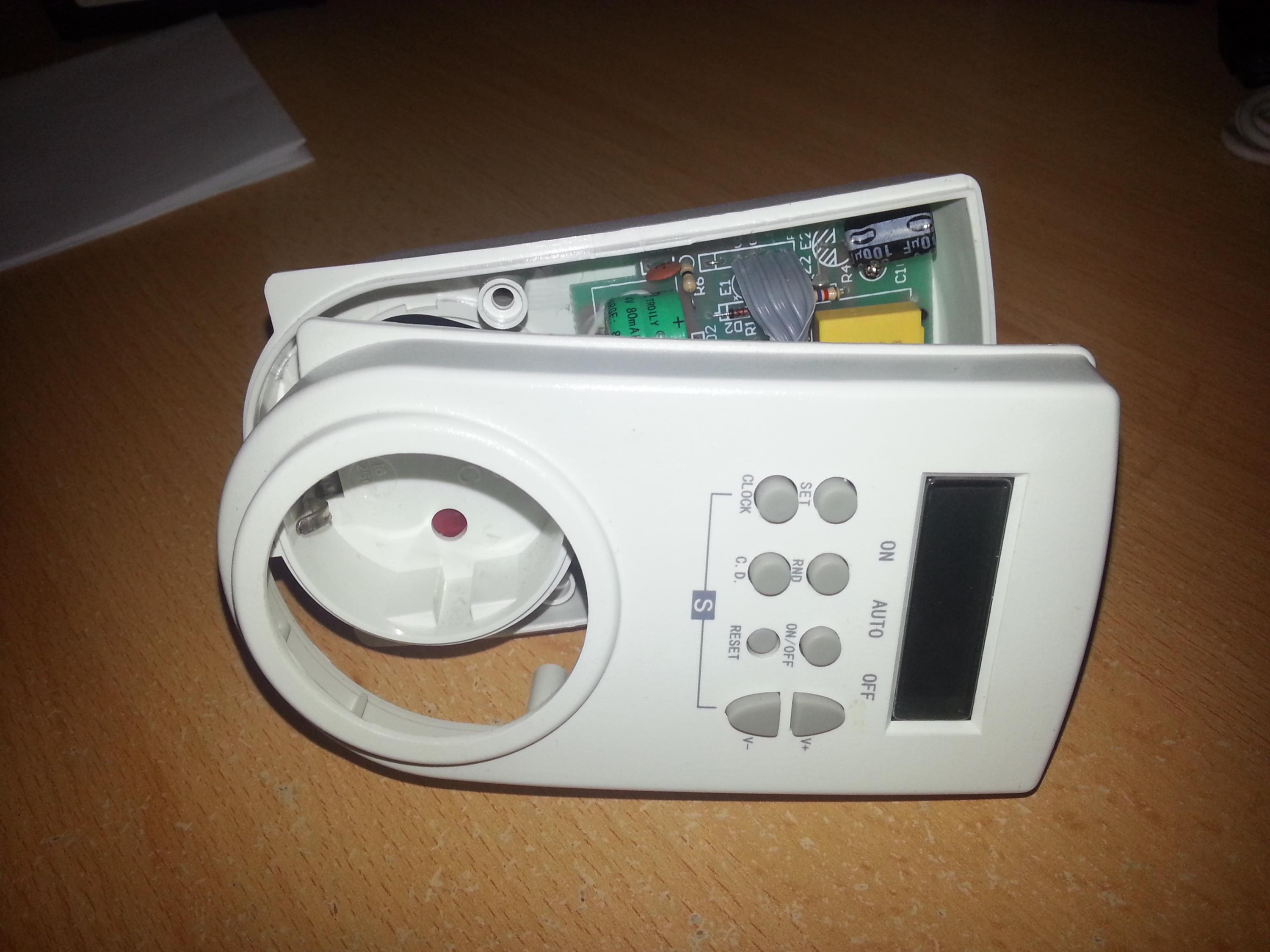

                          No, it doesn't. In fact, here's some pictures of it...not much going on inside. There's a cap dropper, a relay and a couple of capacitors as far as the power side is concerned, so I reckon the brain of it all is on the board on the left where the buttons and display are. The flex cable going between the boards has its pins labeled "VDD, GND, J and PWR". Three of those make sense right away: VDD power for the chip, GND and I would surmise PWR stands for the signal going to the relay trigger circuit. That J is a bit of a mystery and although I haven't taken the board out to see where it leads, I think it might be where it's grabbing the 50Hz sync pulse for the clock ?
                          This particular one is not the one currently in service, but an identical one I had laying around for some unknown reason (I actually had no idea I bought TWO ), so I'll pop this one in to see if it drifts as well over, say, one month's time.
                            One thing that's weird is that the battery is on the power board, does the controller know whether or not AC is applied (when you unplug it, does the LCD go blank?)
                              No, it doesn't go blank when you unplug it, so it's a backup battery to save the clock and settings. However, when the battery finally dies out, like this one has after it's sat in a drawer for so long, the next time you plug it in, the display doesn't come on right away like you'd expect, so when I first bought it and brought it home I thought it was defective, but it turns out that battery must reach a minimum lever first before the thing can run, so maybe the capacitor dropper is only charging the battery and the IC runs ON the battery itself rather than on mains...I'll have to do a bit of a dig to find out how the traces are connected to find out for sure.
                                Ah okay, so it charges the battery and powers to the microcontroller, so that J wire remains a mystery that could be some sort of sync pulse. Need photos of the bottom side of the board, and/or see if there's a crystal on the LCD board...
                                  It would need to use a crystal for timekeeping from the battery. This unit looks like good quality.
                                  I think there is no voltage regulator (maybe just zener Z2) and they wear out the NiMh battery because it's always charging. J might be the battery. It's big at 80mAh for some reason.
                                  It could be the crystal needs tuning or that VCC moves up when the relay is off.
                                    Well, not necessarily, those old alarm clocks used RC oscillators to "keep" time when the power is out...they are HORRIBLE in accuracy when power is out, but better than if it didn't have an RC oscillator. It'd have a clock error equal to at least the amount of time the power has been out...
