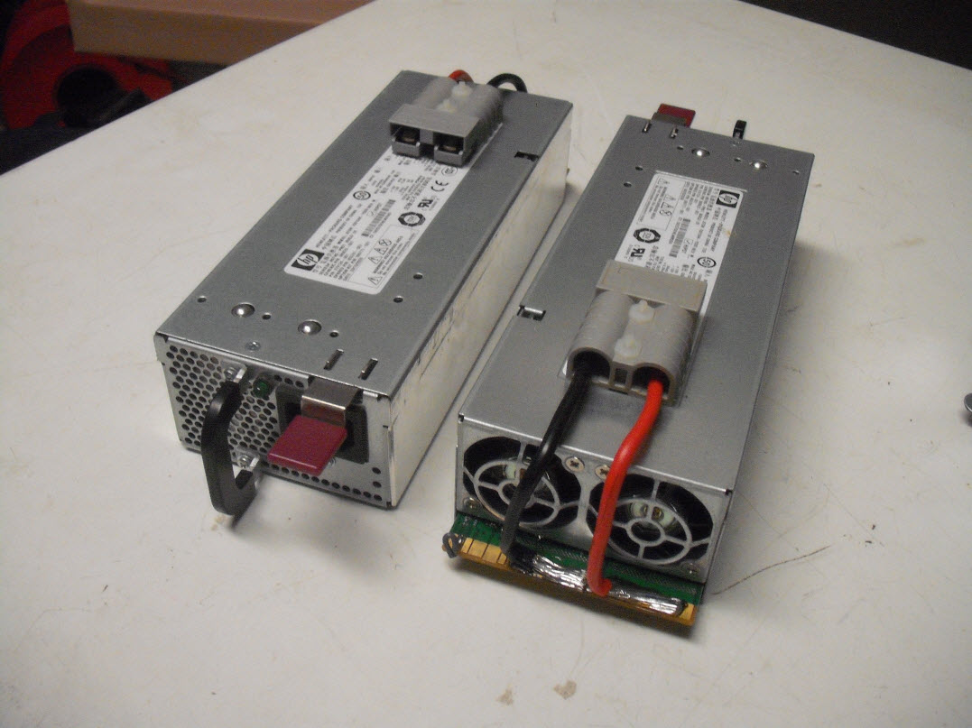

          I have a rack-mountable triple supply that is digitally programmable. Its handy when I'm dealing with something "unknown" as I can type in voltage set and max current limit -- then monitor the voltage and current without having to drag out a meter to see if the "unknown" is, perhaps, toast!
          Most of the time though, the PSU's I deal with are just from old pc's. Because I'm "the boss" I worry that taking server type hardware home would set a bad example. (We often sell our old server stuff to reseller types.)
          We break-down servers and other bits of kit -- power supplies just get tossed into a Gaylord. So, fish through the Gaylord for something that "looks about right" (chances are, it's perfectly functional).
          Biggest problem is dealing with the edge connectors that are commonplace on enterprise kit. Solution is just to solder directly to the fingers. Attached pic of the supplies I use to test powerchairs -- "(BIG) battery eliminators"). Anderson connectors are common on the chairs (high current rating, ease of connect/disconnect)
