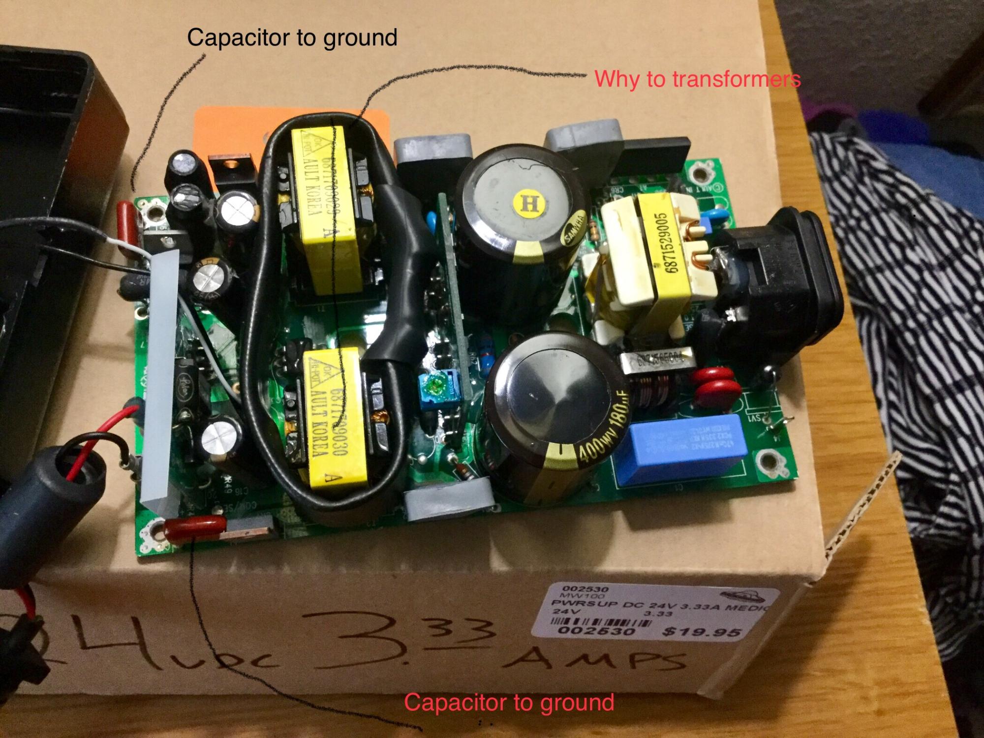

        Look at the picture and tell why there is two transformers I have only seen this a few times before and wondered why it was done this way
        I know if the switching power supply has stand by power it would be setup that way or if you have more than one voltage it might be setup this way also
        I can not seem to spell correctly ( to ) was suppose to be ( two ) in the photo

          AULT is made in Korea?
          It looks like it has an extra stage for PFC, so there is an extra inductor and power mosfet and two (different) primary capacitors.
          If that is wrong, they used two transformers to keep the unit low profile. But they each have different part numbers so that does not make sense.
          It's weird there is a loose coil wound around both of the magnetics, going to the white and black wires. Are they cancelling some EMI or something.

            It looks symmetrical to me, almost like it's a design for +/- 12v or 24v (2 x 12v in series)
            Transformers seem the same size and shape, just one digit different in the number, I see to-220 transistors or diodes on both sides , capacitors on both sides... almost like two identical circuits.
            There's an extra inductor and what seems to be a minimum load resistor near the top corner but that can be explained as additional filtering.
            It's a "medical" grade power supply, so it could be they made it this way to reduce AC leak on the output from the transformers, maybe to reduce EMI (also has that extra shielding stuff)

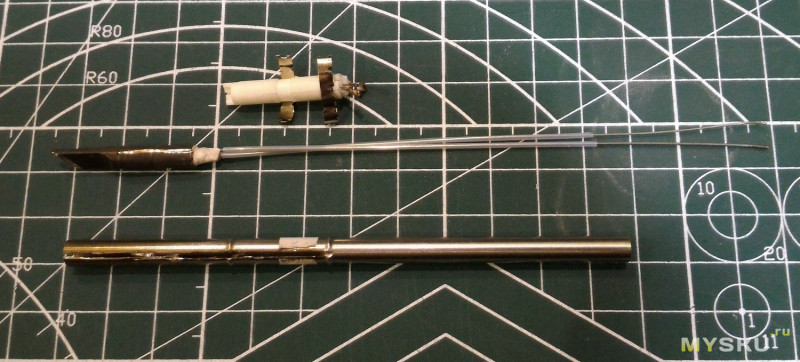

              The problem I am have I have two T12 tips one works the other one does not
              The one that works has a heater ohm reading of 10.something and temperature sensor reading of 50 megohms ( T12-K )
              The one that does not work has a heater ohm reading of 10.something and a temperature sensor reading of 2.5something megohms ( T12-B2 )
              What is the temperature sensor reading should what range for it to work in ohms

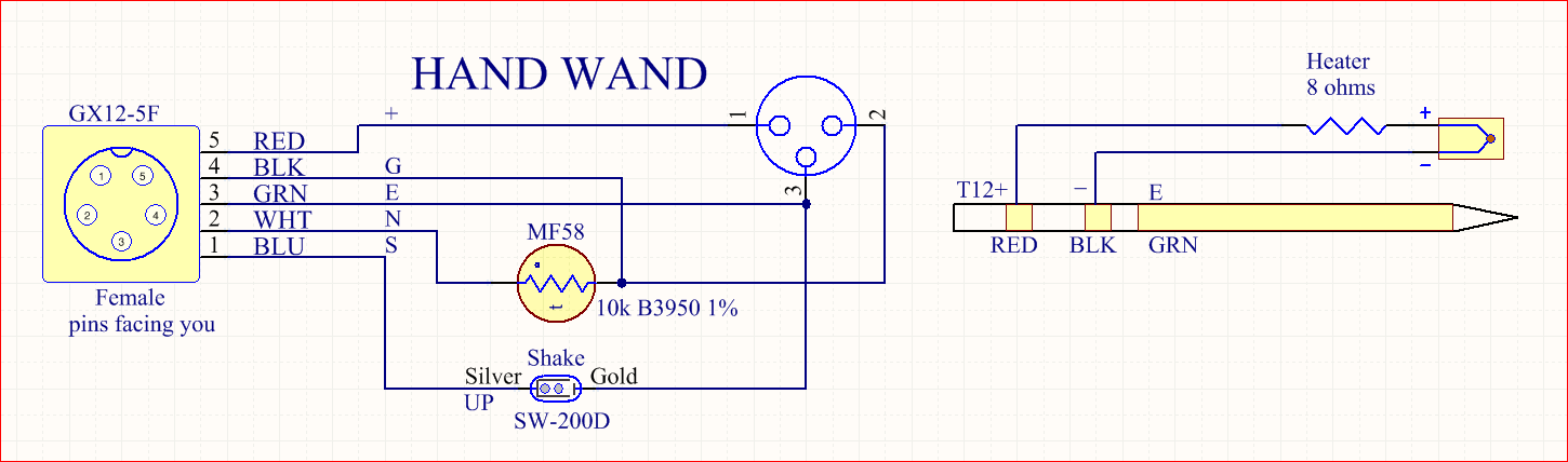

                What problem are you having with the T12 tip? I find it's usually the socket in the handle making a bad connection. Mine read 8R for the heater and about 2.5MEG to the tube, I think the cement has this resistance.
                Inside, there is a heating element in series with a thermocouple. It all ends up two wires, this is the ingenuity that Hakko came up with. The tube is a ground, for the tip.
                You get 4.5mV at 450°C from the thermocouple. It is very a tiny voltage and the T12 controller amplifies this 250x.
                There is also a NTC thermistor in the T12 handle to read socket (cold junction) temperature.

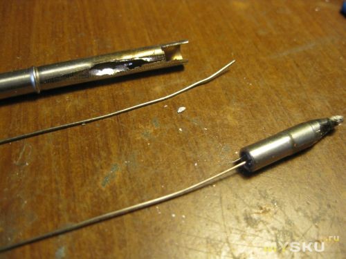

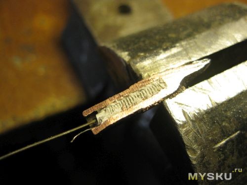

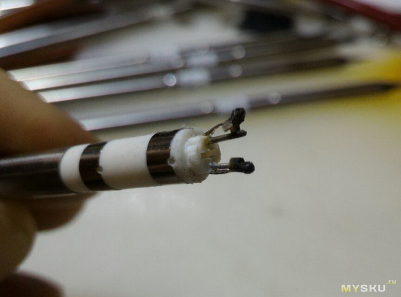

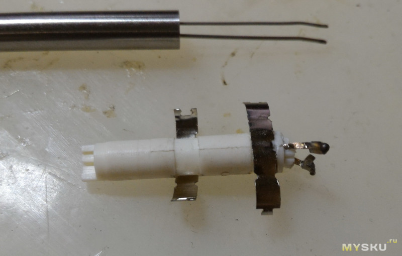

                    look at the ring connections on the bad tip,
                    i have seen pictures of them with bad connections to the wire
                    • redwire
                      • Dec 2010
                      • 3912
                      Re: 24 volt @ 3.3 amp switching power supply
                      It looks like the heater wires are crimped (or spot weld?) to the collars.
                      If you're sure the socket is working and the tip pushed in far enough, I guess take it apart.
                      I have aluminium FX9501 handle and you have to push the tip in so the tube crimp cannot be seen.
