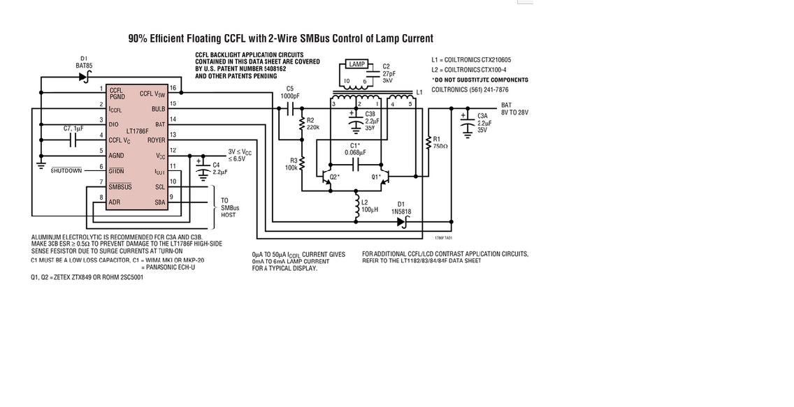

    Dim backlight CCFL Ok...
    Best method (s) turning lamp current up without letting the white smoke out based on this diagram. not using SMBus Host.
