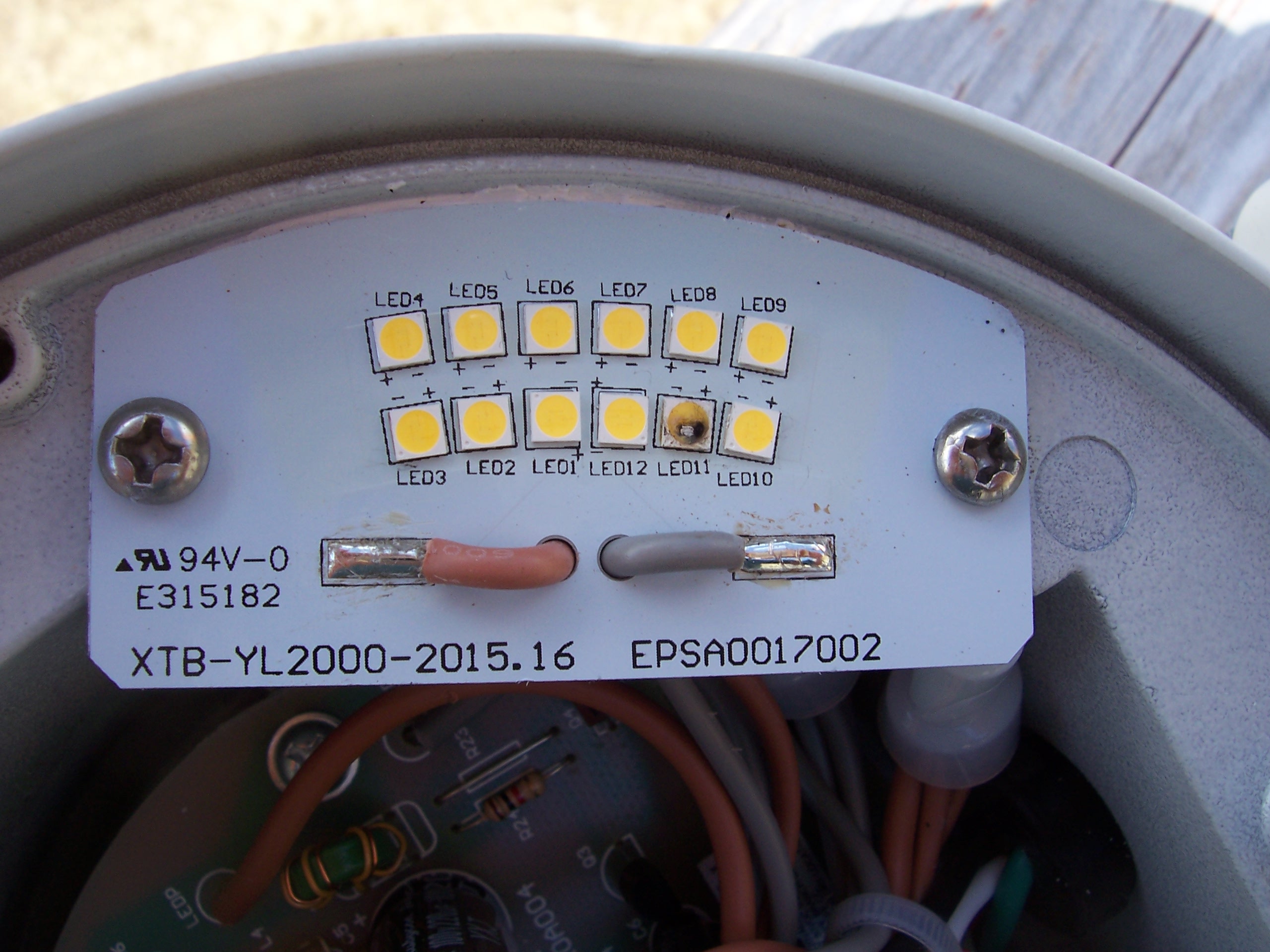

    LED Circuit Aluminum Base
    This is a LED circuit from a Outdoor light. One of the diodes has failed and I am wondering if that would cause that complete circuit plus the other two circuits to fail?? The DC voltage on the brown and grey contacts of all three boards is not stable?? It is jumping between 150 volts and 85 volts (not just one reading) that can't be normal?? but what would cause the voltage to be like that?? The Driver rating is 120 volts AC input/80v DC Output so I am guessing I should be reading a consistent 80 volts DC on all three light boards??

        Q1 is a HFS5N60U
        • mariushm
          • May 2011
          • 3799
          Re: LED Circuit Aluminum Base
          The power supply is designed to limit the current once it reaches a certain value.
          However, because that particular led is faulty, the circuit is either open (no connection between the leds where that faulty led is) or closed (the led is shorted and behaves like a wire between + and -, or behaves like a resistor)
          If the led is open, the chain of leds is broken.
          The power supply starts with a low voltage and keeps increasing the voltage while monitoring the current consumed - it tries to reach the precise voltage when the current reaches a certain value, let's say 100 mA
          So let's say each led consumes 6v (two diodes inside the led each with 3v forward voltage) and you have 10 leds, so there's basically 20 diodes with 3v forward voltage, so 60v.
          If everything was right, the power supply starts at a low voltage and quickly goes up and when it gets to around 60v, the leds start lightning and current flows and once that 100mA of current is measured, the power supply keeps the voltage at that 60v level.
          As the leds warm up their forward voltage may change a bit, like for example it may go down to around 2.8v ... so now the leds only need 10 leds x 2 diodes per led x 2.8v forward voltage per diode = 56v
          Without any adjustment, as the forward voltage of the diodes inside leds goes down, each led consumes more current and gets hotter. However, the power supply detects this increase in current and reduces the voltage to 56v or to whatever voltage is needed to measure again only 100mA going through the chain.
          That's how these power supplies work.
          The first step you should do would be to desolder that faulty led. Easiest would be to heat the circuit board from the bottom (using a hair dryer for example, or a paint stripping gun) and once it's hot, you could use a soldering iron on the sides of the led to add a bit of solder and then push the led off the board.
          If you don't care about the faulty led, another option would be to just get a flat screw driver and just rip the led off - put some pressure on the side with the screwdriver and the led should break off.
          As a temporary measure, you can simply solder a wire between the + and - pads where that faulty led was, and now you have the chain of leds again ... minus one led. So instead of 10 leds, you have 9 leds.
          The power supply should still monitor the current and keep it to that preset value and should simply output less voltage.

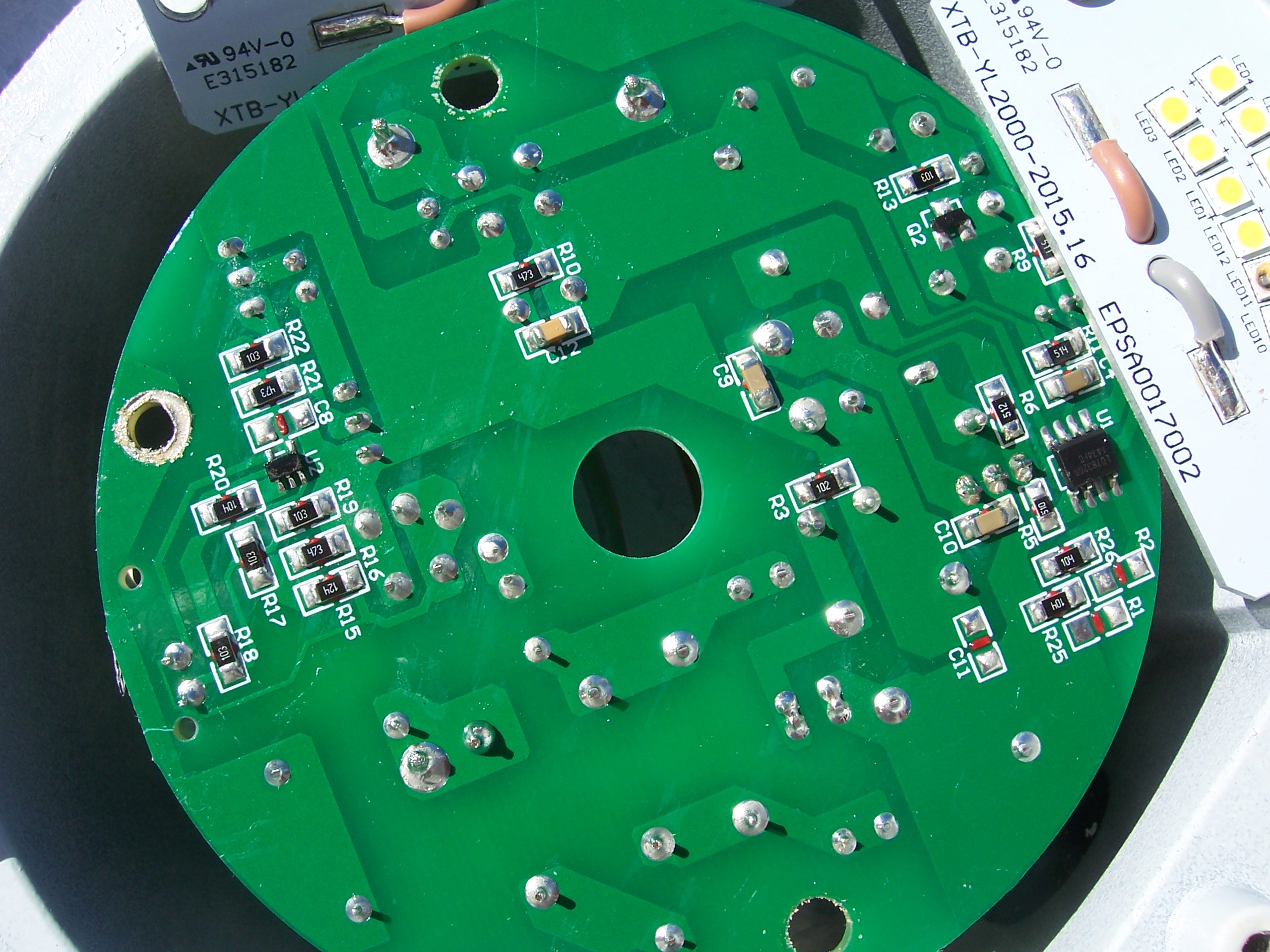

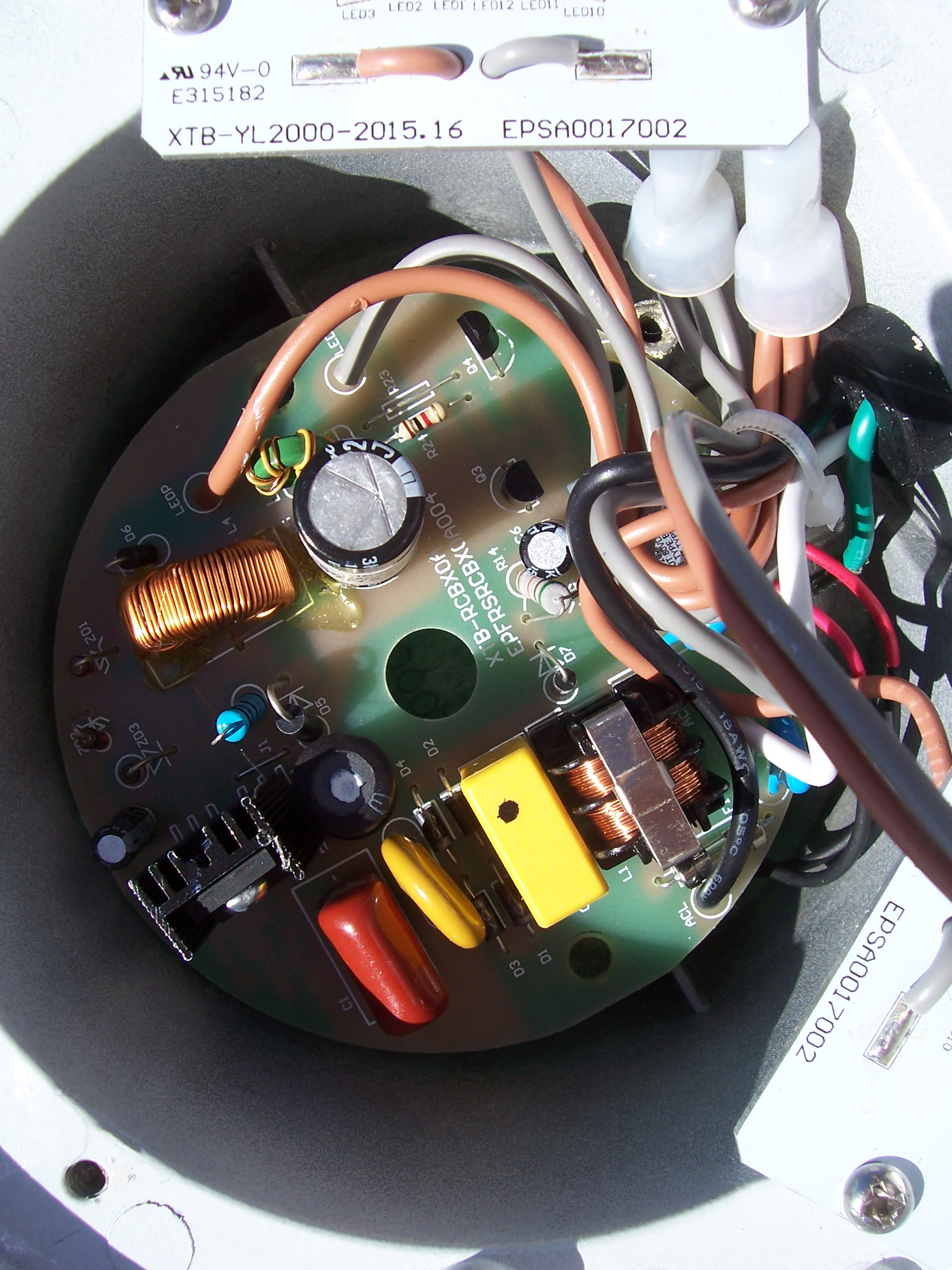

                                  • 536
                                  Some pic of the front and back of the board. The # on the IC is LD7832GR 1434FC

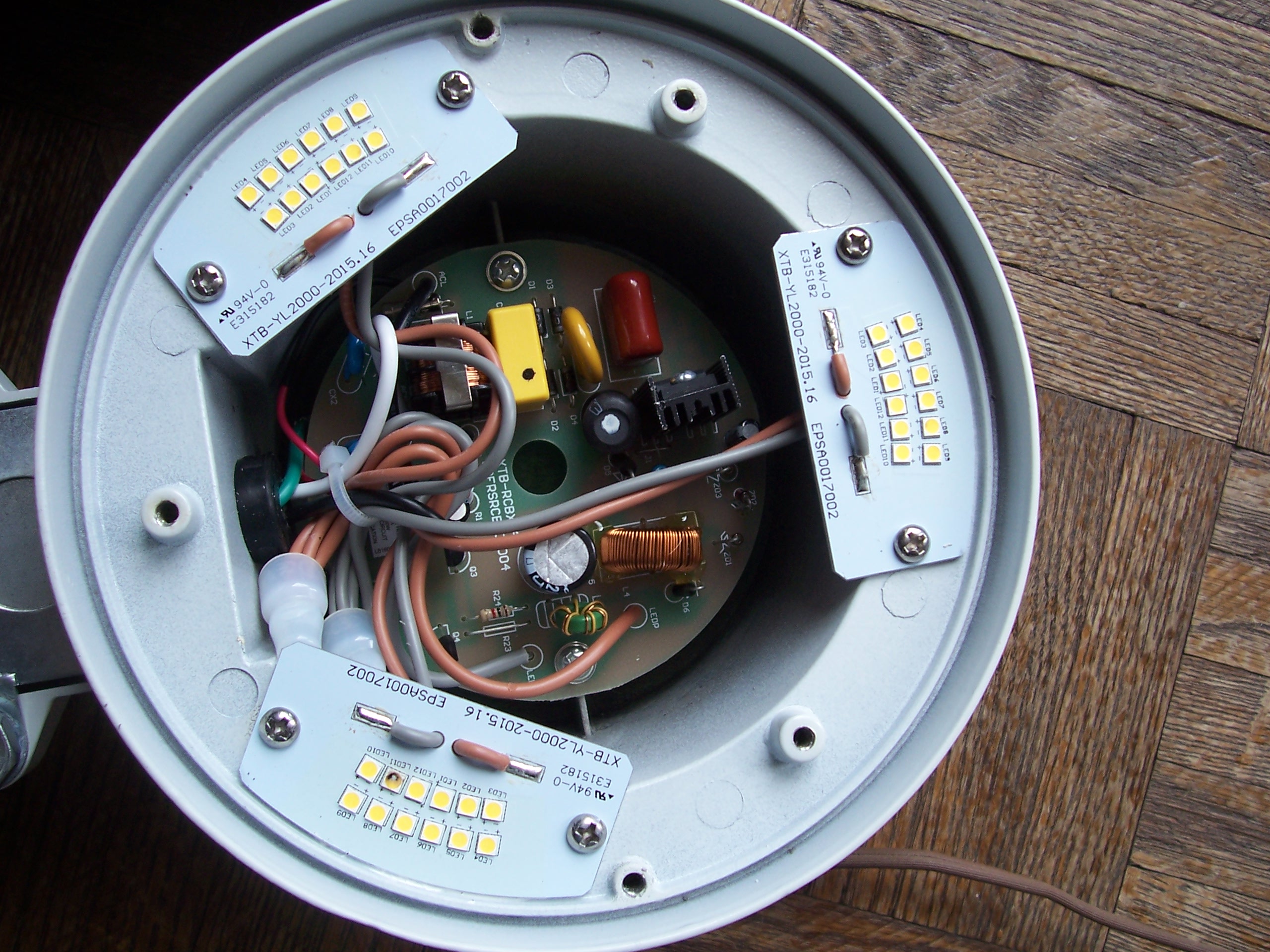

                                  • kc8adu
                                    • Nov 2003
                                    • 8832
                                    • U.S.A!
                                    looks like you have at least 1 led bad on each board.
                                    i would replace all leds with ones from a major brand.
                                    and this gives you the opportunity to select color temp and cri.
                                    the issue is that 1 goes open and takes that module out.
                                    this raises the current to the other 2 by 33%.
                                    when the next one goes the remaining module is overdriven 3x.
                                    and when it loses a led that led gets fried when it opens due to the driver raising voltage in its attempt to hold the current setpoint.
                                    this would be the burnt one you see.
                                    • davg
                                      • Sep 2008
                                      • 536
                                      Tks kc8adu that is what it appears. With the known faulty board (with the burnt LED) removed there no attempt for the other two to light up? I wouldn't mind replacing all the LED's but are they available as a module? where are they available? What major brand?
