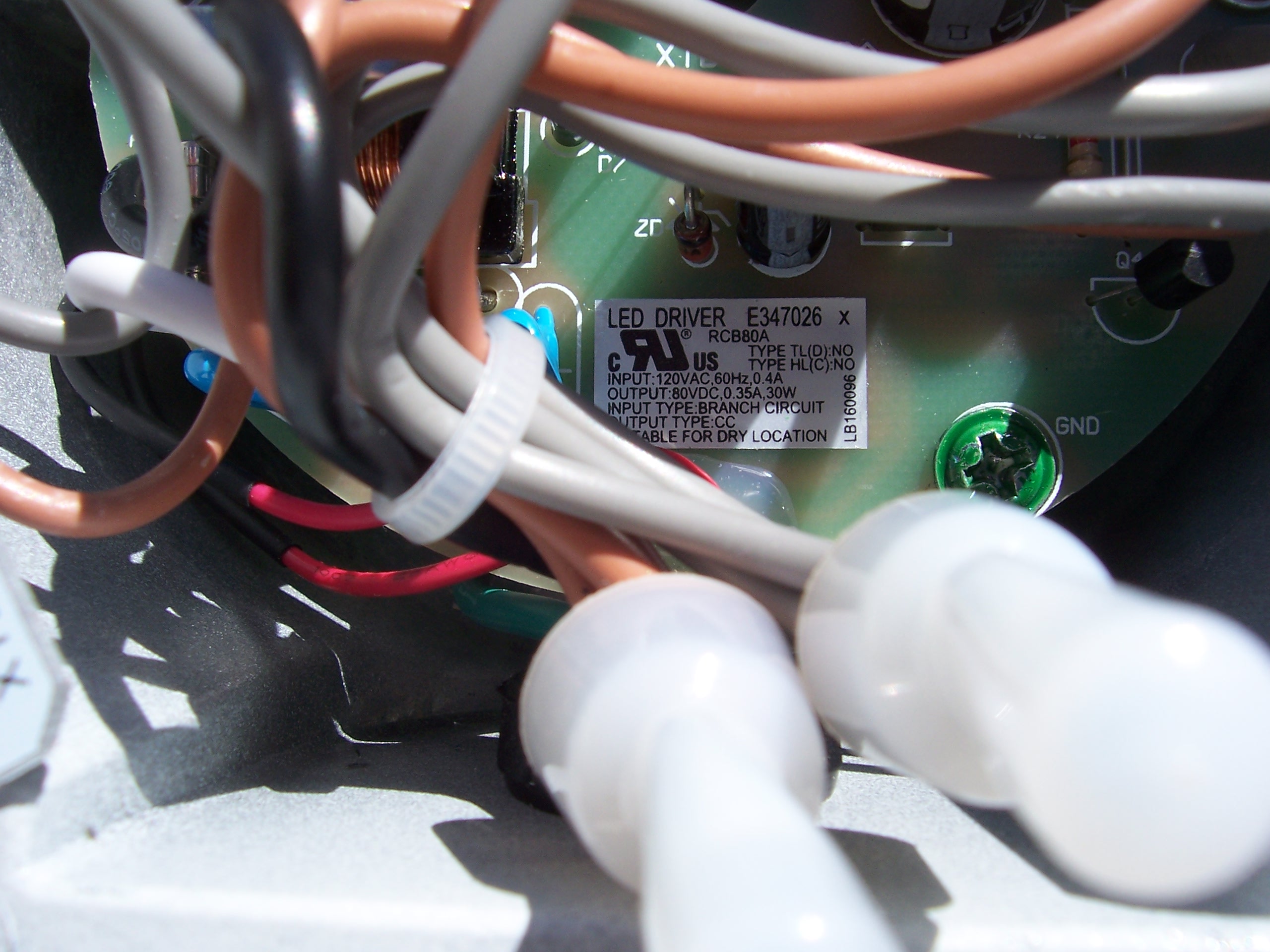

      Re: LED Circuit Aluminum Base
      Here is the label on the driver
        It is constant current (CC) power supply: 0.350A as printed.
        if all 3 boards has perfectly matched then each board will have .350 A/3 = 0.117 A (116.667mA)
              The Voltage will go up higher than the spec (80V 350mA) when it sees no load, that is how CC power supply function, it adjusts its output Voltage to maintain current through the load, and if the power supply is well built the it will go into OV shutdown.

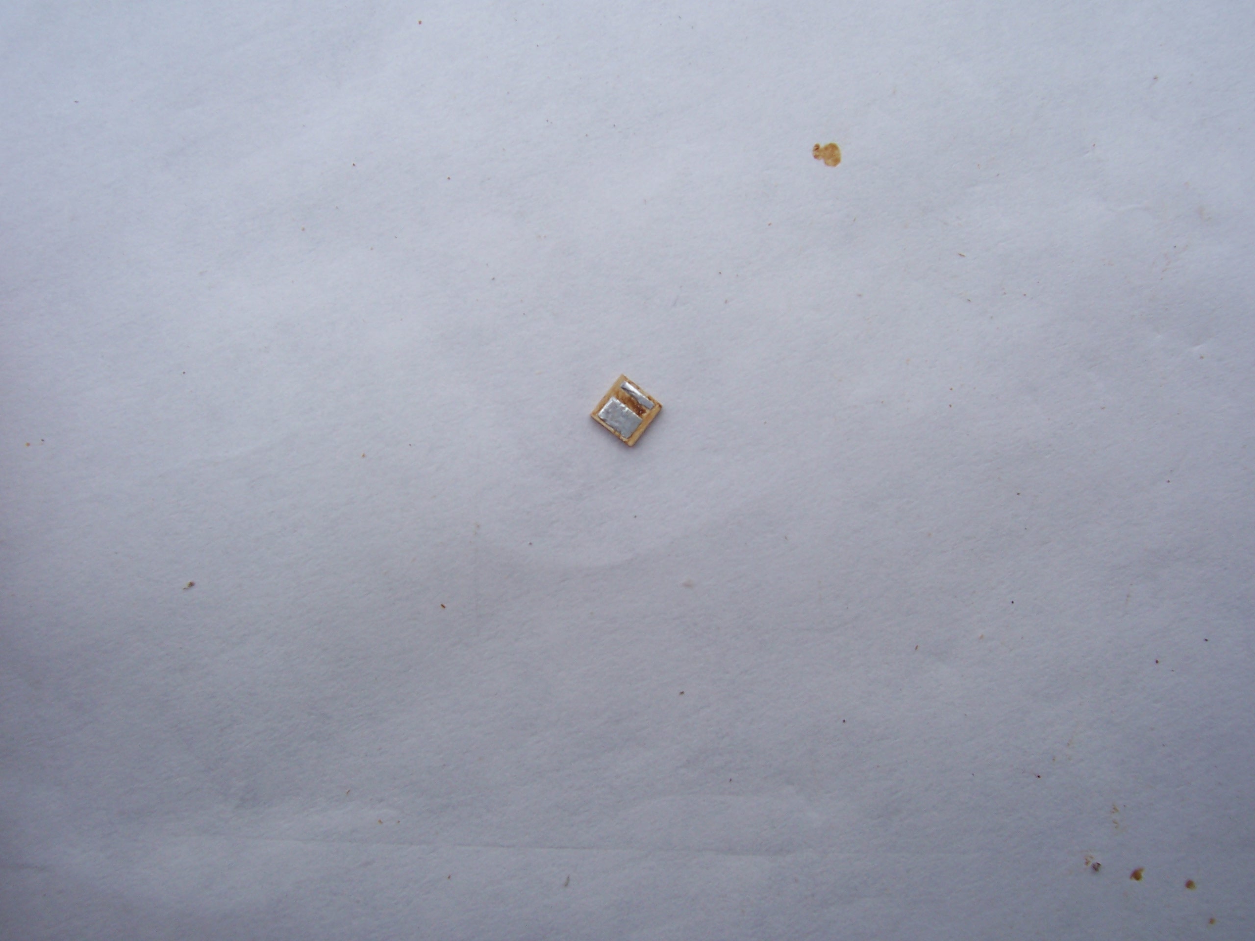

                                    Would this be a good replacement for these SM LED https://www.digikey.ca/product-detai...1CT-ND/3074387
                                      #38
                                      You should remove the LED to find out what kind of footprint it has first, the rating of the one form Digikey is 3V, not 6v.

                                        • davg
                                          • Sep 2008
                                          • 536
                                          #40
                                          Here is a pc of the LED Footprint the large pad being negative
