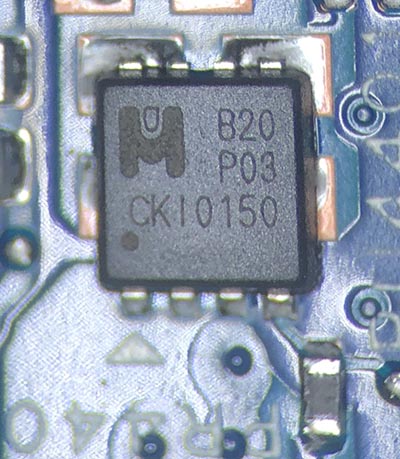

    Hi guys,
    I am fixing a motherboard and I have a shorted Mosfet. I am not able to find anything in Canada. It's a Toshiba TPCC8131. Could you please tell me if you can find an equivalent on Digikey or Moser?

    Re: Looking for equivalent for a MOSFET
    Hi, I found another exact board which uses another part number at that location. I attached a picture. Please help me to find an equlivant on Digikey.com or Moser.com.
      Hmm.... tson advanced 8 packaging? Hmmm... You could maybe use this..
      https://cdn.badcaps-static.com/pdfs/...6a772ad420.pdf
      It's a Power-33-8 form factor, but it's footprint is the same as the tson advanced 8 it seems. (3.3x3.3x0.8mm) Pinout seems the same as well..
      What do you guys think? Spec wise I think it might work, but I might be overlooking some stuff.. (Probably am)
