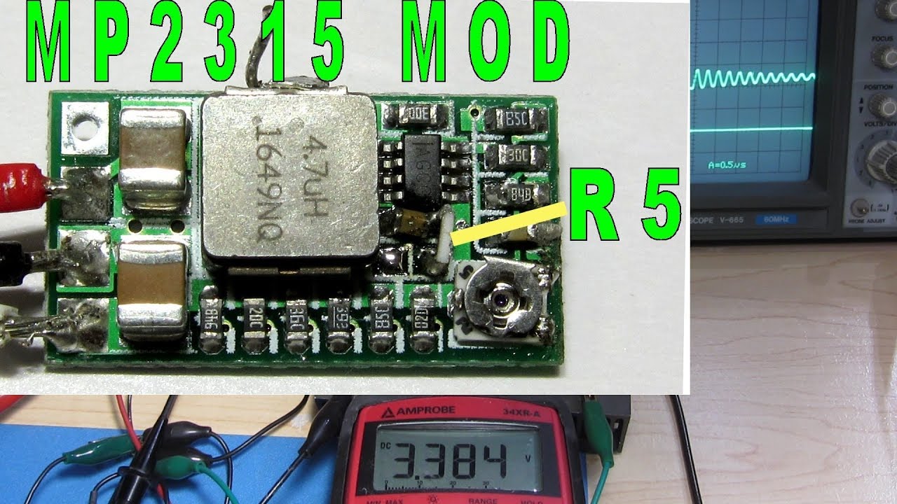

            #85
            Re: Running a microcontroller in car - power supply aspects
            Ahh thanks I forgot which one you are using. That module uses MP2315 IC which has a low power mode set by a resistor to GND on pin 1. It's claimed to draw under 1mA and you get 10mA? I haven't tried one. You cut the tiny jumper?
            This guy found it has an instability and he did some mod. for low voltage I think https://www.youtube.com/watch?v=yyrgW5dNUIo
            I'll bet a bigger capacitors in/out would fix it.

              #86
              Yeah, OK, I never noticed the instructions when I got mine (the original link is gone anyway). I just assumed that track's just part of the board and is supposed to be there all the time, so I didn't mess with it, meaning I was getting BOTH the pot AND the fixed voltage resistors connected at once.....which means the same is going on in that monitor right now *fail*
              Ok, knowing that, I'll probably give it another go and report back. Keeping the power consumption of this whole thing as low as possible is very important.

                #87
                the mod i do on some is to replace the pot with 5k (original is something like 200k)
                and cut that track - then solder a resistor across it i salvage from the top for 5v.
                this gives me something like 5v-5.5v ajustment range!

                      #90
                      exactly, it's in series so you can fine-tune the resistance but only by 5k

                        #91
                        Ok, I cut the track and indeed it works correctly now: bridging the 5v pads, actually gives me 5.1v, since the pot is out of the loop now. Still, the power consumption is 11mA...maybe it's related to that low power state on pin 1. I'm not sure these modules are suitable though because of the 24v limit of the MP2315 IC.

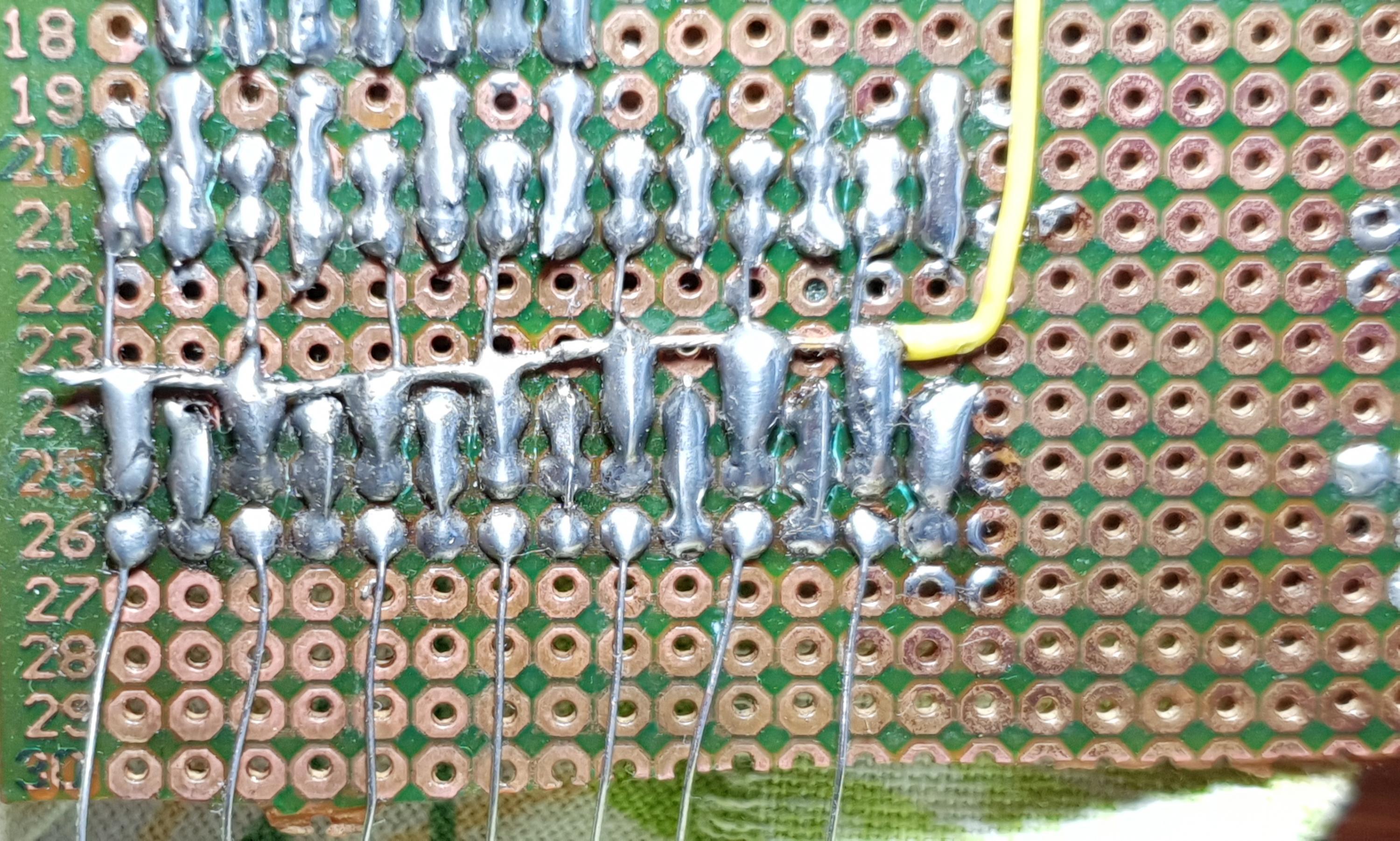

                                Just for those who are curious, here's what the project currently looks like on its perfboard The "power" section will go where that empty space is, opposite the optocouplers and the unused headers will be trimmed off, of course. 7 inputs, so 7 optocouplers: UP, DOWN, UP, DOWN (left+right), IGN. LOCK, UNLOCK.
                                Wattevah...

                                    #97
                                    I'll take a shot of the back as well. The way I do it is leave as much of the component's lead as possible and bend in the direction I want to form a track and then solder over it, which ensures the leg of the component IS the track It's safer but can get ugly when you need to replace something....VERY ugly
                                    I WAS thinking of a 7805 when I first started, but thought a switching regulator would be more efficient in the long run. Noise on the 7805 would still exist though, as I learned from a video of Dave. It doesn't quite help filter out the noise AFAIK, though probably less than the switching one.

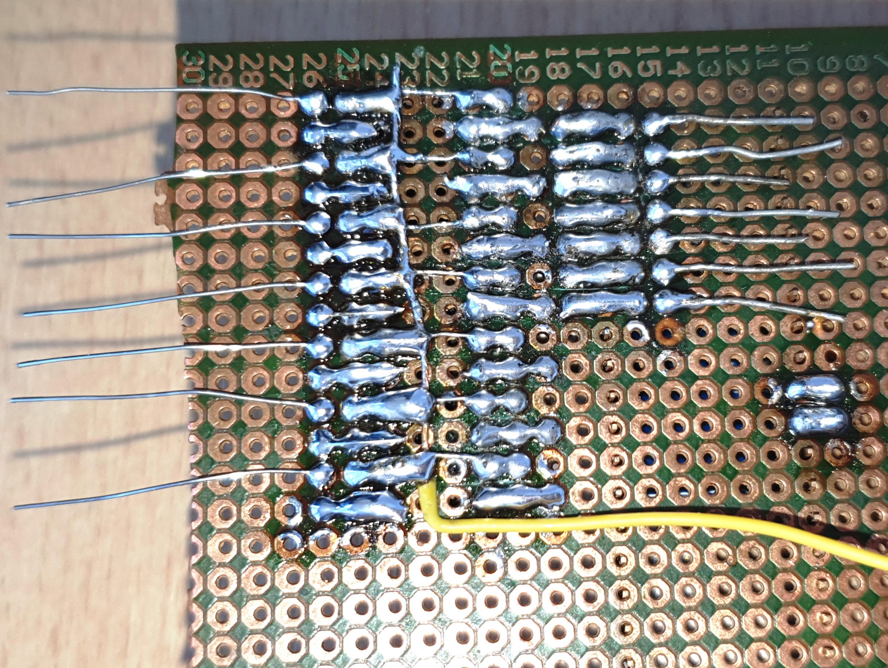

                                      #98
                                      Here's what the solder side looks like. The perfboard is janky, I know, it was a leftover piece that I just had to use to get rid of The leads to the left are the 2k resistors in series with the anode of the LED in the optocouplers and essentially serve as our "inputs" - when pulled to 12v, the LED turns on and the pin on the arduino is pulled low via the C-E path in the optocoupler.
                                      The leads to the right are the 10k pull-ups which hold the pins high to 5v again - they'll all go to a "bus" rail when I get to that part.
                                      The yellow wire is a GND wire which will be soldered once I sort out the layout of the power section....not sure whether I should go with the switching regulator or a simple 7805 as suggested....

                                        • 31288
                                        #99
                                        clean the flux off, it's hard to tell if i'm looking at reflections or solder bridges!

                                          #100
                                          Probably went a bit overboard with the lighting, but I can assure you there are no bridges Here's a hopefully better shot. This Galaxy S10+ that I'm using seems to have a lot of potential, but I can't seem to get stuff just right. Seems it's either too dark or too bright and not in focus....
