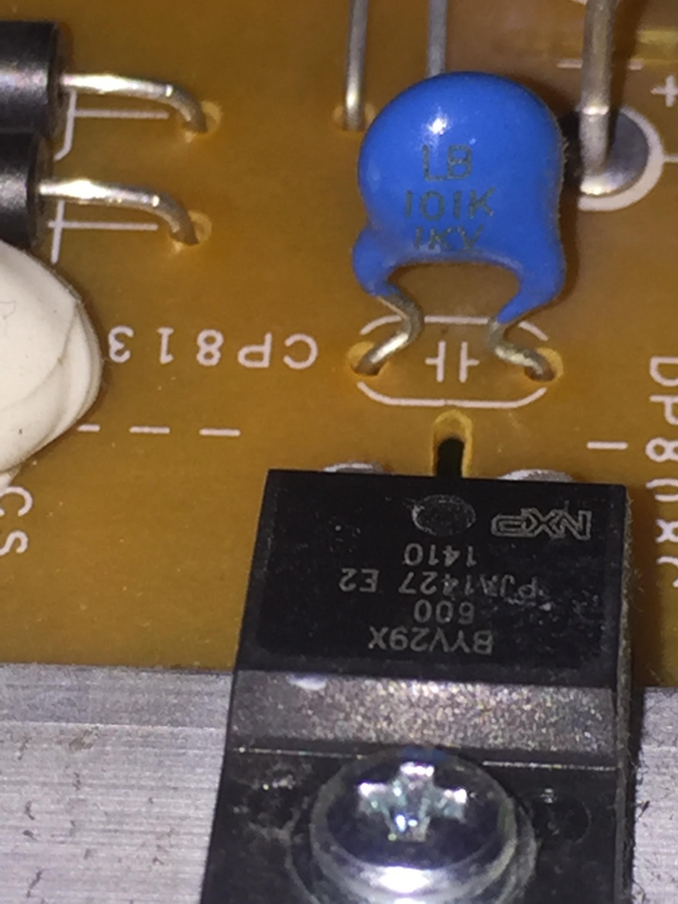

    Hello everyone I'm trying to identify the blue capacitor in the pic. I was at the electronics store today and they gave me the ones in the package also in the pics. They seem to be half the size of the blue ones in the board now. This capacitor comes out of a LED TV.

    Re: Help Identify Capacitor
    It should be ok, it is the right value and the voltage is 1kv, I would have used a 2kv if available but it should be fine.
      R_J thanks the blue one blew the back out for what ever reason. So a 2KV would have worked also?
        It would be better to use 2KV, that is snubber cap and it is common failure cap.

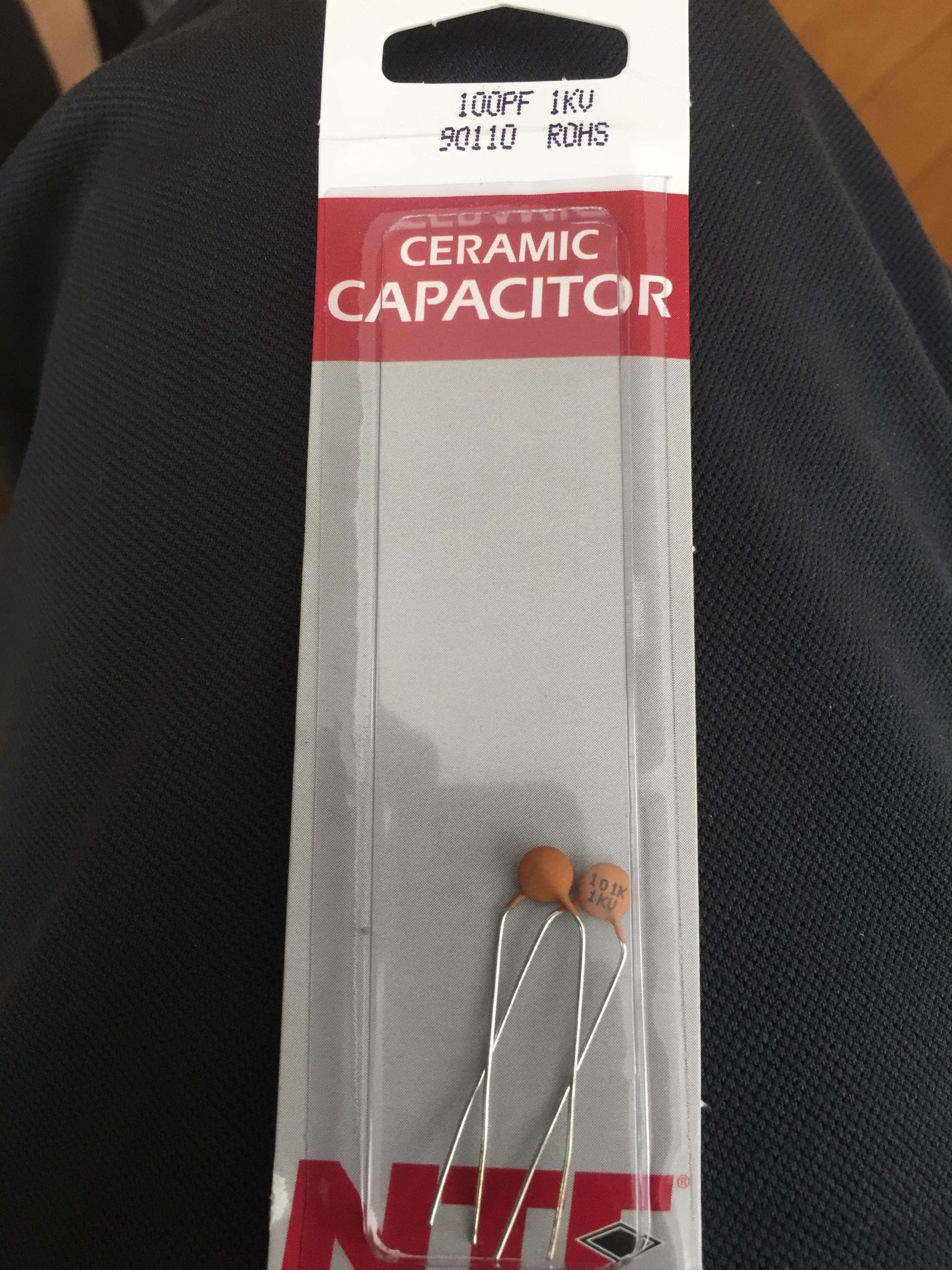

          i seriously doubt those new ones are 1Kv,
          they look too thin.
          i never trust NTE, they started as a company buying obsolete/surplus parts and re-selling them with there own numbers on them.
          a good excuse to sell a lookup-table.
                    Sometimes the fet can go also, if its not shorted, put one of the nte caps you have and try it. Then you will know. Its a snubber capacitor, its value is not that critical. If you want to replace it with a 2kv, any of those from digikey will be fine.
                      R_J think i can just use the NTE I bought as pictured in a previous post just as a test to see if the thing turns on? Then I'll go get the 2KV.
                      Or is that NTE not a snubber cap?
                        The capacitor is used as a snubber in that circuit, It is used to suppress any high voltage spikes created by the switching circuit. It protects the fet from any high voltage spikes that could damage it. The nte will work. its just good practice to to use a 2kv as it will handle the higher high voltage spikes.
                        the nte cap can be used anywhere in this case it is used as a snubber.

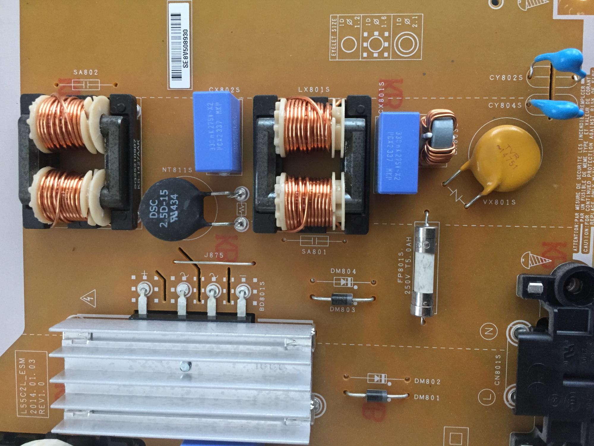

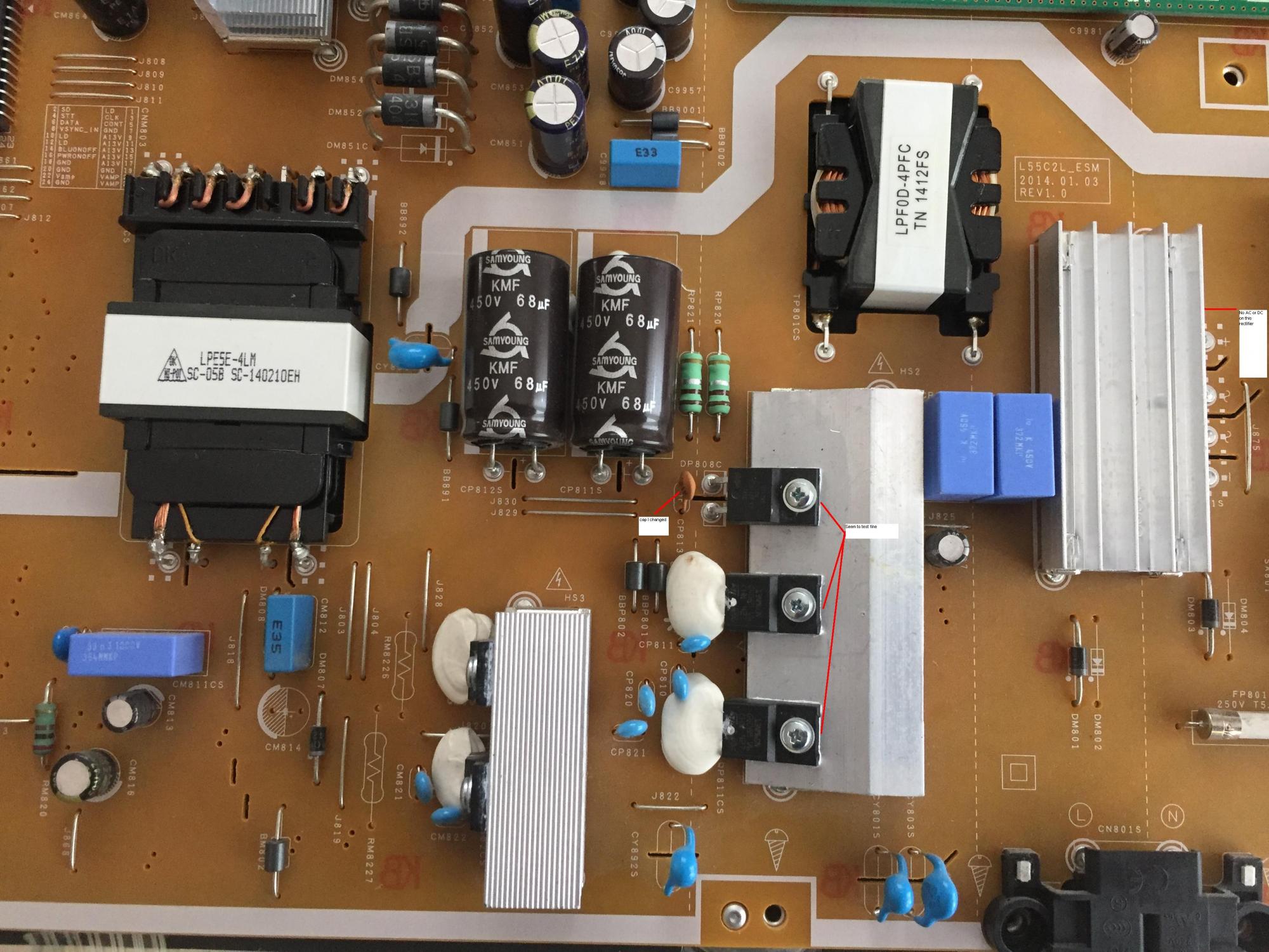

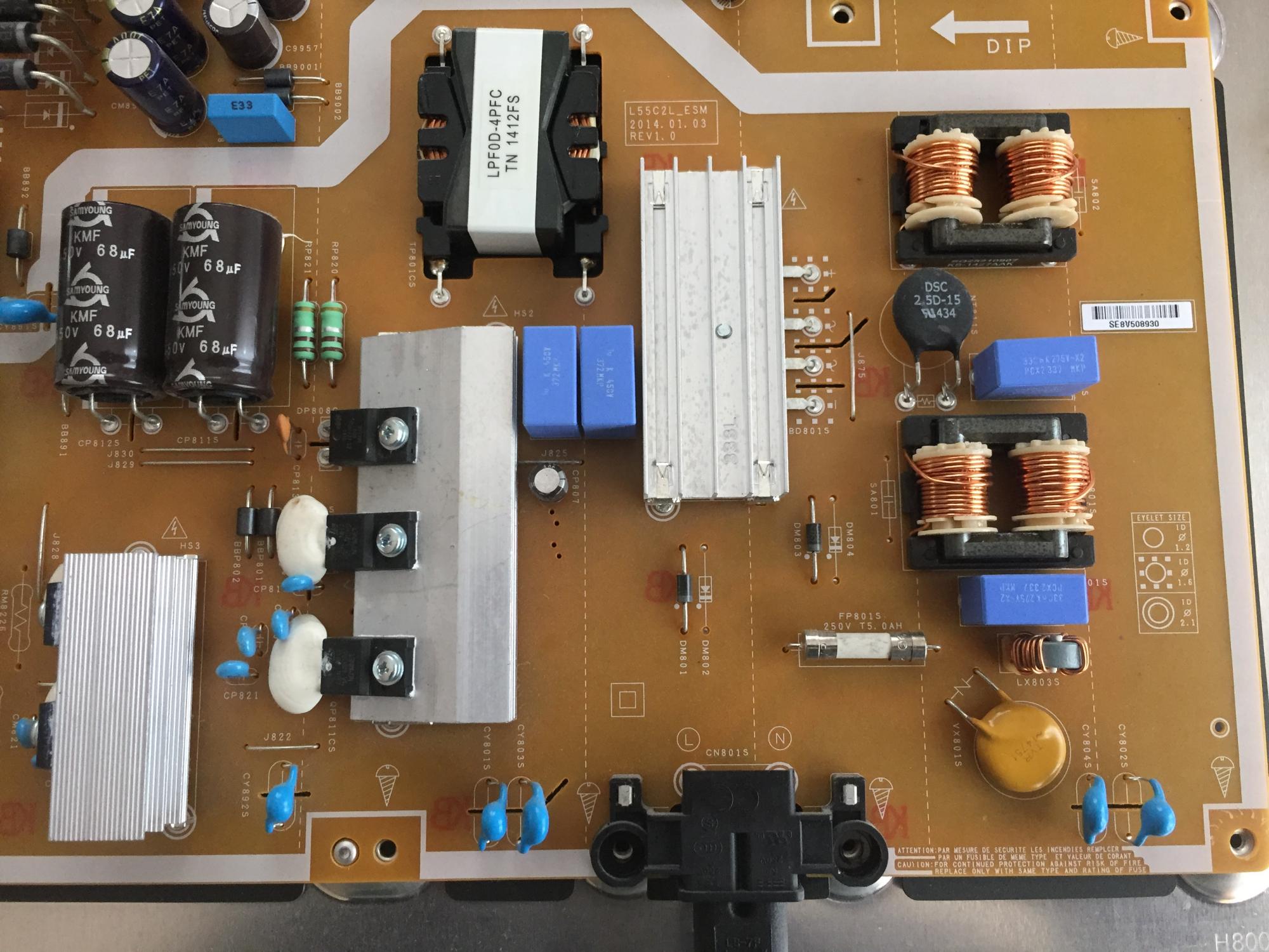

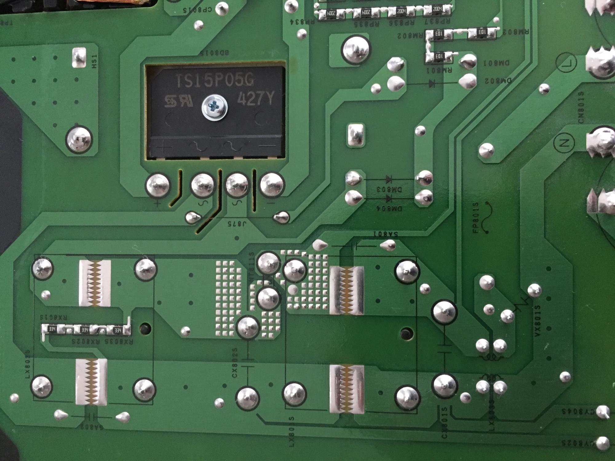

                                Hi all well, replaced the cap and nothing. Checked some pins that lead to the logic board which have about 4 pins stating 13VDC, but nothing. Then went back to hot side of board, and the fuse is good, get 120V, checked a bridge rectifier, I get no AC or DC on it. On the hot side of the board, I get low voltages all around the board about 8.3 volts.
                                i attached some more pics of the board.

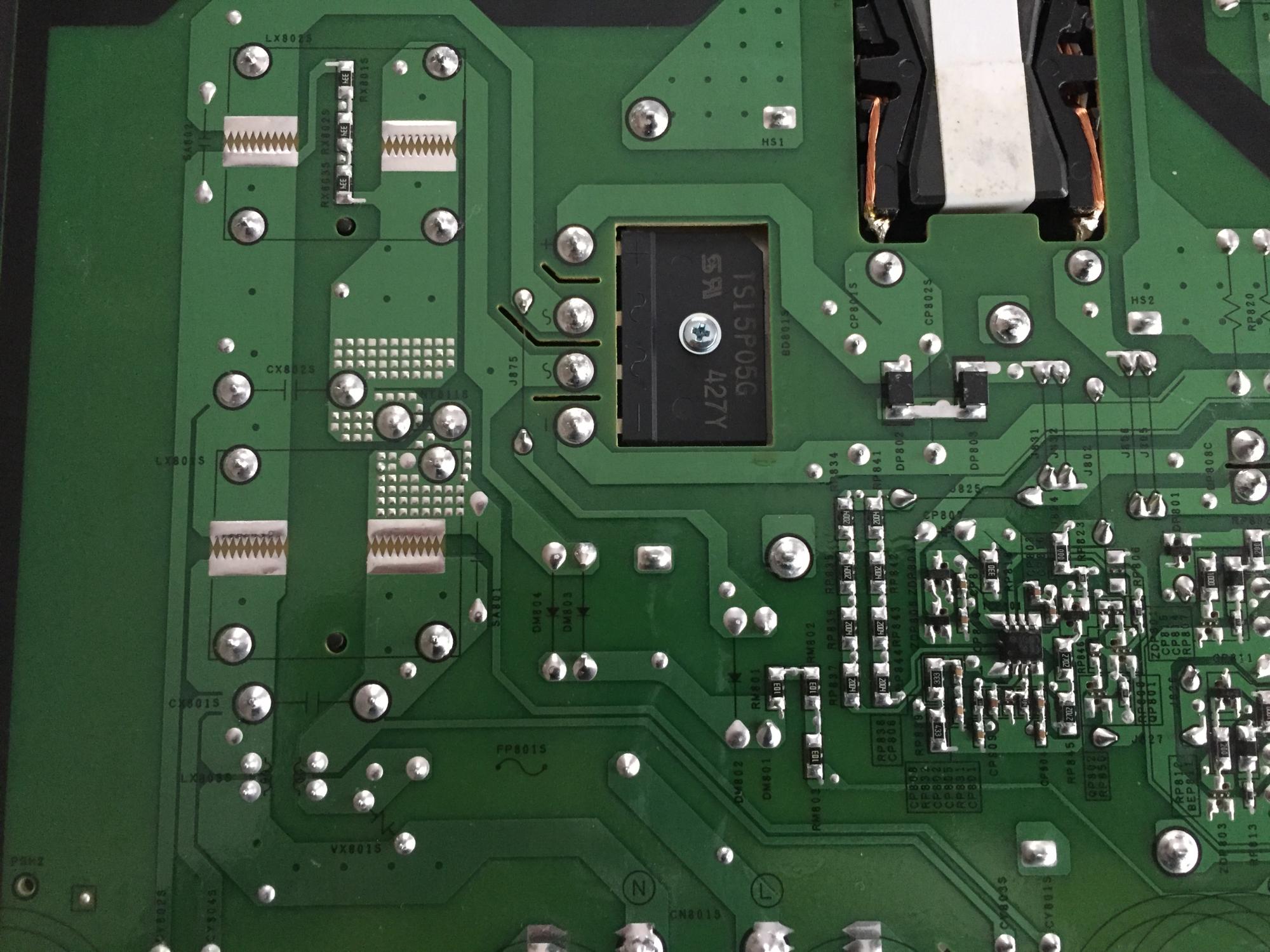

                                  Attached is the bottom of the board
                                    I am guessing this is a samsung board, bn44-00740a, If you have no a/c on the bridge you will not have any voltage at all, anywhere. are you sure your meter is working?
                                    Check the fuse and then check VX801S
                                    What are you using for ground when checking voltages on the hot side?
                                    You also need to tell us which pins you are checking that have voltage "Some pins" does'nt mean anything.
                                    I see that cap was just across a diode, I thought it was across a fet like on some power supplies
                                    • Gladiatorx
                                      • Aug 2016
                                      • 95
                                      Yes correct it's a samsung BN44-00740A...maybe I should have started another thread under the TV troubleshooting?
                                      So on the hot side I just used one of the board screws.
                                      Not sure how to test that mov while it's in the board can that be done with a multimeter, I found not good youtube videos on those while in circuit
                                      • R_J
                                        • Jun 2012
                                        • 9578
                                        When checking DC in the primary, always use the (-) of the main bridge rectifier, that is refered to as HOT ground
                                        Correction, The mov VX801S will check open, NT811S should check low (2.5Ω) I got mixed up looking at the top and bottom pictures.
                                        To eliminate a bunch of checking, measure the DC voltage across the (-) and (+) of the bridge rectifier.
                                        Next measure the voltage across the main filter CP811S
                                        You said you measured 13 vdc on CNM803 plug, This voltage on the secondary CAN be measured to ground, You can check this voltage on any of the JP808-11 jumper wires.
                                        If you have 13 volts, then Unplug the tv, disconnect CNM803 from the main board and plug in the tv and see if the backlights come on (they may or may not)
