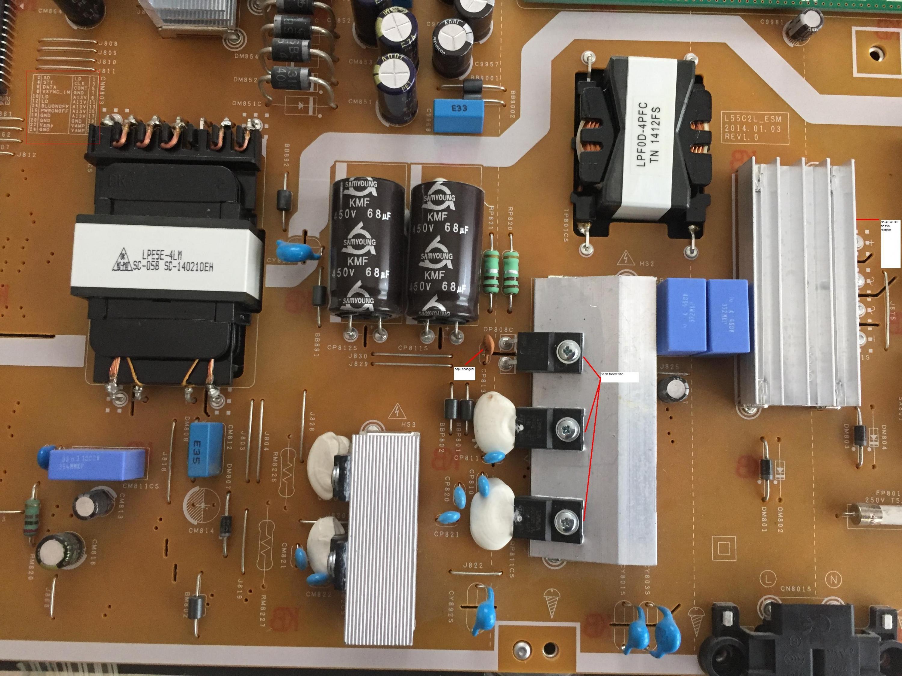

      • Gladiatorx
        • Aug 2016
        • 95
        Re: Help Identify Capacitor
        By the way in the attached pic isn't one of those suppose to be standby power? Not sure with the marking which it is.
        • R_J
          • Jun 2012
          • 9623
          If you have NO dc across the bridge rectifier I will bet your main fuse is open.
          with your meter on ac volts, check the voltage right where the plug connects to the board, then check across ~ & ~ of the bridge

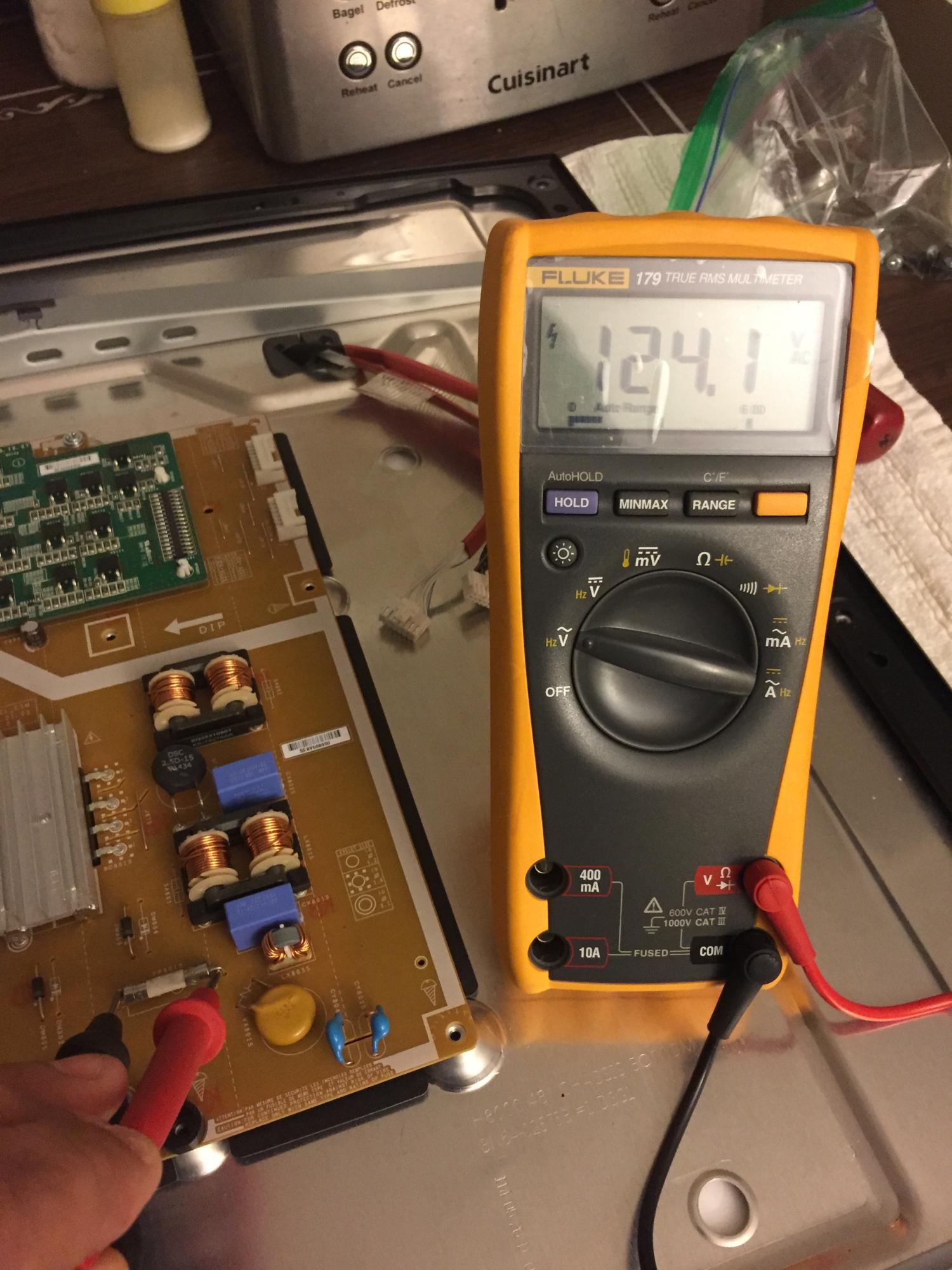

          • Gladiatorx
            • Aug 2016
            • 95
            at the main fuse 124Volts. At rectifier No AC voltage

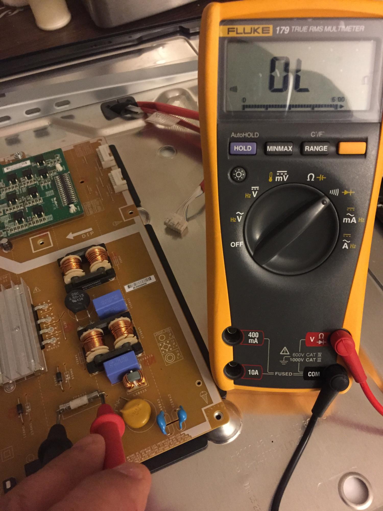

            • Gladiatorx
              • Aug 2016
              • 95
              So I must be doing something wrong, negative lead on one side of fuse, positive on other i get 124V
              But using ohm meter it shows OL
              • R_J
                • Jun 2012
                • 9623
                which side of the fuse? both sides?

                • Gladiatorx
                  • Aug 2016
                  • 95
                  I tested as you see in the below pics. CX801s, can't get to the pins from above the board.
                  One pic shows me testing voltage the other ohms
                  • R_J
                    • Jun 2012
                    • 9623
                    #29
                    Your fuse is OPEN !!!
                    • Gladiatorx
                      • Aug 2016
                      • 95
                      #30
                      how come it reads voltage the way I have the meter hooked to it?
                      • R_J
                        • Jun 2012
                        • 9623
                        #31
                        Because the fuse is open, That is just phantom voltage, the ac is likely being coupled through CX801S, or the 3 resistors RX9-35,25,15, and shows up on the other side of the fuse.
                        Remember a fuse is basically just a piece of wire,
                        To check voltage properly you need to be able to access the other side of the board, then with one probe on [N] a/c neutral, you probe across [L] line, thats how you check for a/c voltage, the next step would be to leave one probe on [N] and probe each side of the fuse. then you would see there is a/c voltage on one side but nothing on the other side of the fuse. resulting in... open fuse
                        Because the meter does not really draw any current from the circuit, there will be no voltage drop across those 3 resistors, so the full 120vac shows up across the open fuse

                                • R_J
                                  • Jun 2012
                                  • 9623
                                  #36
                                  It should work for a test but pico fuses are usually fast blow, give it a try. maybe disconnect the plug to the main board and see if you get the 13 volts, without the main connected it will limit the current. If you get the 13 vots, unplug the tv, connect the main and try the tv
