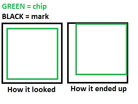

            Well guys, believe it or not, I'm back on this thread. If you remember, a couple of years ago, I was talking about different techniques for reballing and the state of this operation in our shop. A lot has happened since and through a series of crazy events I won't go into just now, I ended up doing it myself just today for the first time from start to finish ! Yes, that's right, after all these years, I had a go on the T890 machine, since the guy I was talking about apparently lost more and more of his eyesight to the point where the asked me for help because he can no longer see such small details...
            Anyway. I wick, I flux, I ball, I flux some more until it's finally time to put the damn thing back on the board. It was all going well until disaster struck: after the 8 minute profile ran I went to inspect the chip and it was a good 1-2mm out of alignment ! For some reason, it slipped to the top-right of its boundaries ! (see the doodles, exaggerated for clarity) WHY ??? I lined it up by eye as best I could, so it sure wasn't perfect, since I'm not a friggin' machine and there's no way to SEE underneath it, but I wasn't THAT far off for sure ! I was expecting it to snap in place on its own and even the old guy told me I should just be "close enough", but it didn't happen - it was a sh!t fest ! Not even close ! What's going on ? Too much flux, unequal heat from the lamp, some problem with the balls...slanted table ??? :| I left it like that over the weekend since it was getting late, but it sure ruined my day.....such a disappointment, since I almost had it...>_> I didn't SEE it happen, but I imagine it happened when the balls melted. Truth be told, I asked G if the lamp should be carefully positioned above the site, but once again, he told me "close enough" is "good enough", which leads me to believe it was off-center and heated up one side of the board more than the other, so the chip was pulled over there instead of equally from all corners...
            This is the kind of thing that never seems to work for me but always seems to work for others and it's extremely annoying: components lining up on their own once solder melts ! NEVER been able to do it, even when I'm dealing with QFP stuff which in theory is more manageable since it has actual leads you can SEE ! Imagine how insane it is for me to try and land all those tiny 0.5mm balls without even seeing them ! Even with QFP, 9 out of 10 times, the chips slides to one side, like it's not heating up evenly, even though I try to hit it as close to the center as possible. Either my equipment or my technique sucks...or both....

              You don't know what happened as you weren't watching what was going on!

                Re: Reballing discussion and tips
                Which sucks even more, because now the experiment has to be repeated again and see what goes wrong for the -2ND- time in a row.
                A few of the reasons I can think of for this to happen:
                - someone bumped into the station or the table on which it is on
                - thermocouple wire sitting on the chip? Maybe it tugged onto the the chip? I've seen this happen when doing RAM, so I never place a thermocouple directly on the RAM chip itself, but only on the PCB close to it.
                - new balls on the chip were never fully soldered and as a result, chip "rolled" once the flux heated (especially if the table has a slight incline.)
                - G was messing with ya the whole time.
                My advice: whenever you do something for the first time on a machine that you have not used before, never let the machine "do its thing" and assume all will be good afterwards.
                  There was nobody around but me at that time, plus the table is reasonably sturdy, so even if it did happen, it would have to be a goddamn earthquake to move it THAT far off the target
                  G taped one thermocouple close to the corner of the chip using aluminium tape, but it wasn't touching it, plus it's taped to the side where the chip actually drifted, so if anything it should've STOPPED it from going that way
                  This is the more likely scenario. After I applied the balls through the stencil for him, G used his old, rickety, nasty hot air station he probably got when the joint opened 30 years ago, to melt the balls in place. The thing barely seemed to put out any air, though I could see the element glowing inside, so I'm not sure if the balls stuck properly, or they were just barely hanging there. They appeared to be shiny and none of them fell off when he peeled off the stencil, yet this is a more likely scenario, combined with the uneven heat from the lamp. Not sure how precise this has to be positioned above the chip....
                  No, he was out smoking a fag at that time, so he couldn't have, plus I was the one who positioned the chip, since he can't see properly. He insisted I must've F'ed up and didn't position it right to begin with, claiming there's no way it could've drifted, even though both me and another guy looked at it beforehand...I protested, he kept on going, so we left it at that - the damage is done....it's the cause I'm most interested in. Next time, I'll let him do it so it hopefully drifts again for him
                  Wattevah...

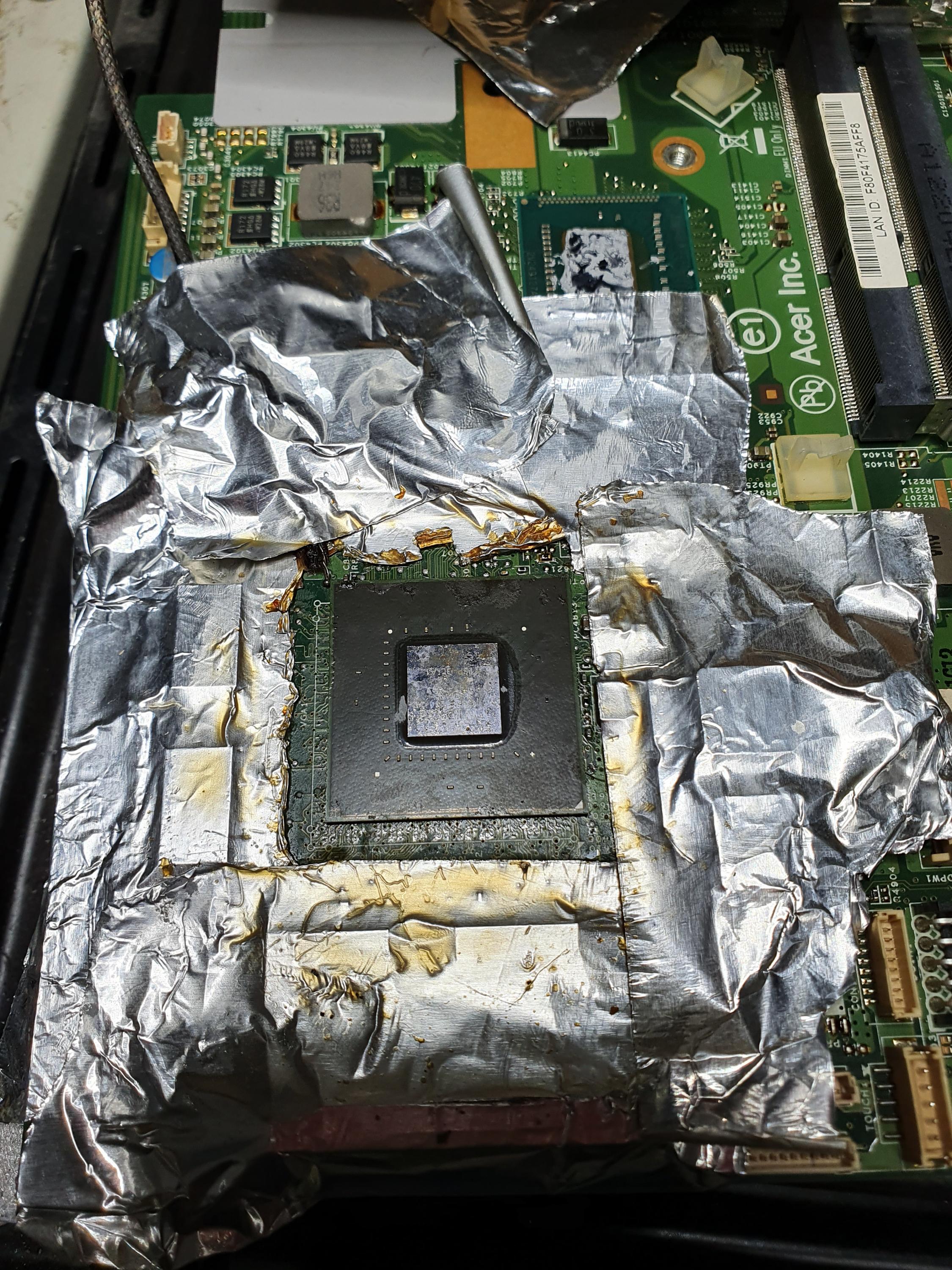

                    Here's the actual result. I took it off again, but had to leave shortly after, so haven't had the chance to put it back to see if reoccurs. It's probably a good idea I took the picture because some of the components to the right also got knocked out of place, so at least I know where they should go...provided someone else didn't mess them up even further...

                      Why do you have all that tin foil on the board? When I use my BGA rework station it never desolders (as in moves) anything nearby, it just removes the intended part, and I don't put anything on the PCB to stop it from happening
                        Not my idea - the old guy put it there. It's sticky tape usually used for taping ducts together, which makes it worse IMO because you can peel it off with other components and it leaves a nasty residue behind to boot....
                        The thinking behind it is not to blast heat into nearby components...if that matters at all...
                        Wattevah...

                            #53
                            This reminds me of way back in the early days of BGA "rework" and Youtube videos when the "trend" with the aluminum foil/tape started and hardly anyone knew what they were doing. Mostly it was people doing the "oven baking" tricks on Xbox 360 motherboards and video cards... but it spread to laptop boards too. Most competent repair shows will NOT use this technique.
                            Looks like it's time for old G to retire from BGA work. (no offense to him.)
                            In any case, DO NOT use aluminum tape or aluminum foil on boards.
                            As you noticed, indeed it leaves a nasty residue and will usually cause more harm than good (actually, I don't think there is anything good that it does) by moving SMT components around as the board heats up. The only time I ever use it (aluminum foil, NOT aluminum tape) is if I want to protect nearby electrolytic capacitors. But if that's done, don't wrap the foil tightly around the board or any components. Just simply put it loosely around like a heat barrier/wall/shield. More often than not, though, you should never protect any nearby components from heating up - especially with this technique, where the foil is cut only around the part your heating - BAD idea. Essentially, you're trying to heat up a large chip but not the nearby area, and that can cause the chip to loose heat through conduction through board traces. This in turn will usually make one crank up the heat, because it just won't desolder otherwise... and that's the danger - you're running the risk of overheating the chip. You'd be much better off letting everything heat up. Also, you're less likely to cause board warping. Now, if there are any nearby plastic connectors that might melt, then use Kapton tape, as lotas suggested above. It's heat-resistant and won't leave residue when removed.
