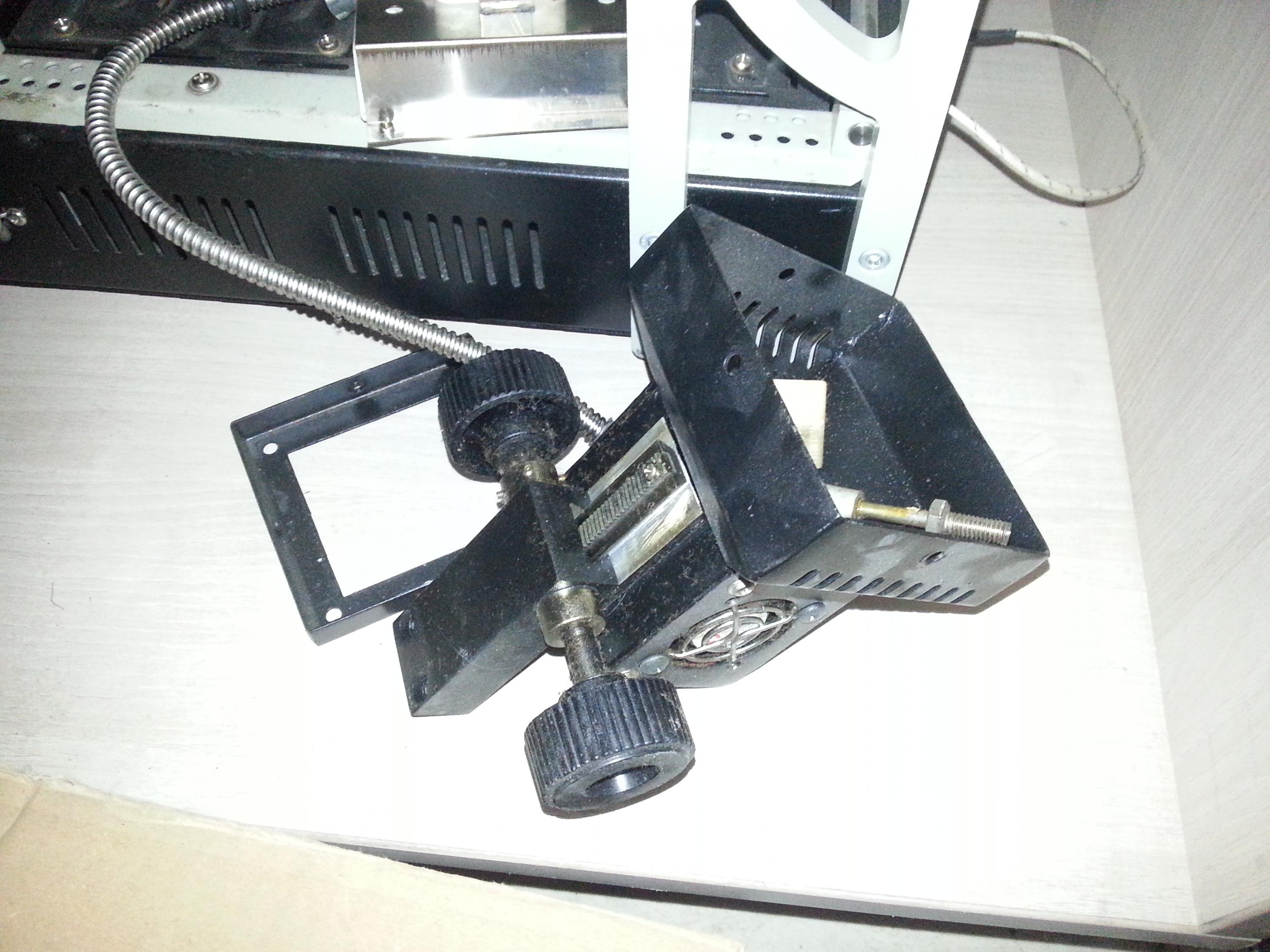

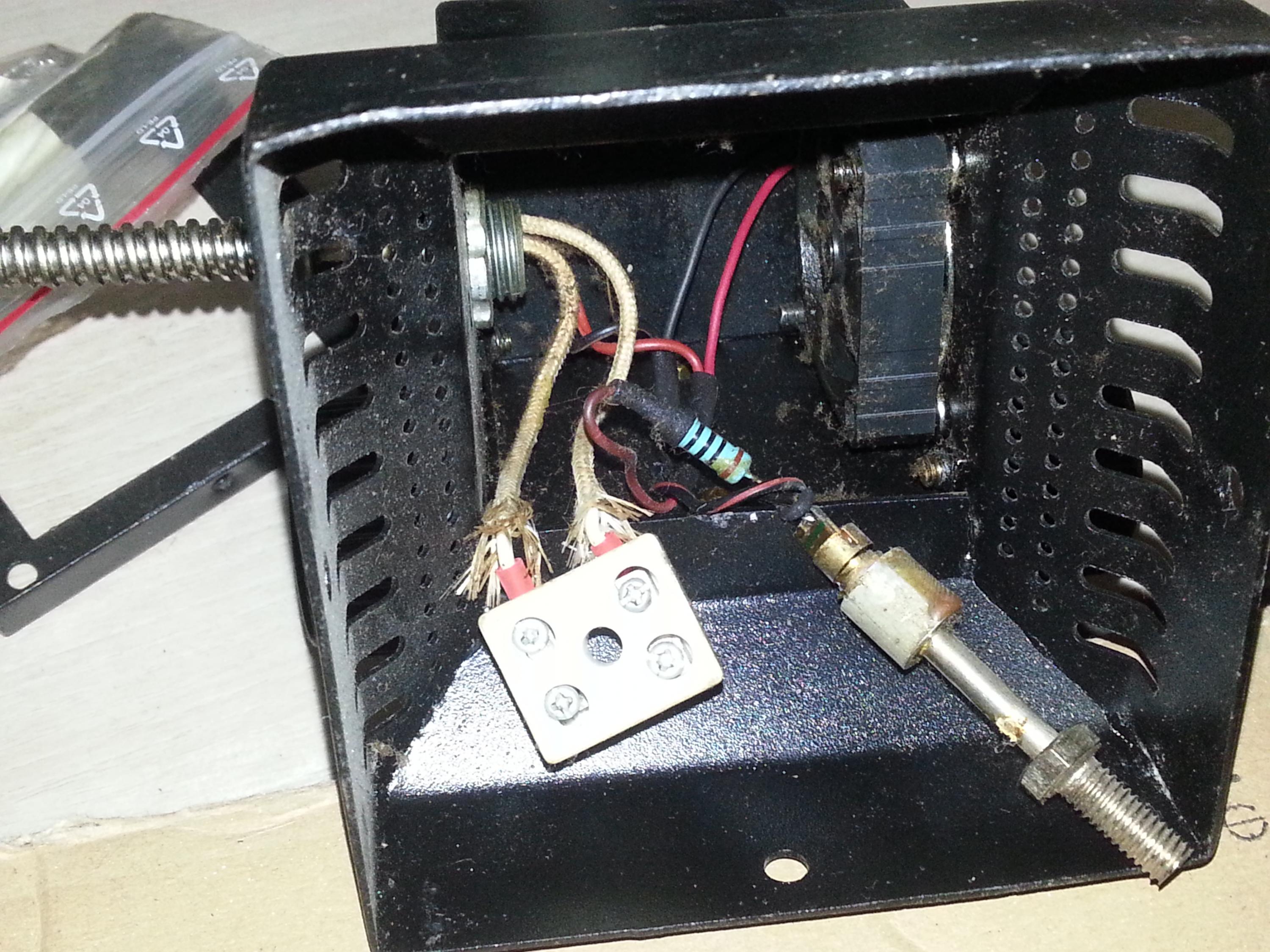

                            #33
                            Re: Reballing discussion and tips
                            Hmmm....his doesn't seem to leave any gunk behind. Either that, or he simply doesn't clean it afterwards
                            EDIT: I learned a while back that we have a second T890 reballing machine around here that's dead. Apparently its "lamp" died. Not having looked into these things before and not actually seeing the device itself up close, I had no idea what this "lamp" truly is or what it looks like. I know it's the "head" that actually heats up the board from above, but had no idea what the active element inside it is, that is until I looked it up on Ali and found THIS....looks like a heating element. How is that an IR "lamp" exactly ? Could be a mistranslation after all Not only that, if that's the only thing wrong with that machine, for 20 odd dollars I could make myself a functional BGA machine...

                                With everybody gone from the shop during lunch break, I sneaked around to where I know the dead machine lies to have a look at it and snap some pics for later use I shouldn't have to do this - I friggin' WORK here - it's like I'm thief around here Unfortunately this might be a bit more of a hassle to restore than I expected - the head has a couple of other loose parts dangling around inside, so it's not as easy as bolting in the replacement element - these guys may be clueless half the time, to the point where I'm screaming internally, but even they are not SUCH blockheads to not have thought about replacing the heater. A new head assembly is too expensive for me to purchase on my own. From what I understand, they thought about replacing the whole head assy like that, but for some reason chose to replace the entire machine because they claim the price difference between the two was too small to warrant replacing the head: around 200$ vs. 400$....not that small a difference, but anyway....
                                Originally posted by diif
                                Actually my wildest tech fetishes pictured something just like that a while ago (hell, even before I went into the field ), but I never thought it existed until I eventually looked it up, further confirmed by your video now: a machine which replaces the shaky human hand by having a head which can carry all sorts of tools on it and uses them with pinpoint accuracy like that: soldering, wicking, fluxing, balls, you name it. After all, there's no reason why it CAN'T exist: it's just a slightly more advanced CNC in the long run....turns out it DOES exist (and I was certain it did, but only in highly professional environments). I'm sure our shop could afford something like that - it's a HUGE business - but it would take years to pay for itself due to the relatively low prices one can charge for a reball operation.
                                Wattevah...
