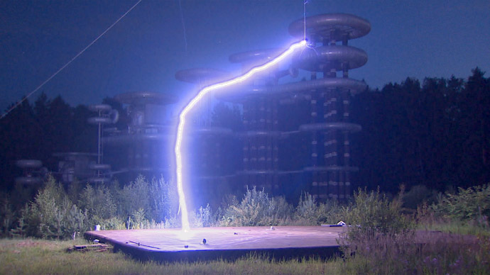

        Those tesla coils in the pictures will need to get to millions of volts to break through the dielectric strength of air, the resistance of an animal/human is much less and is negligible. Let's say there's about 30 meters between the target and the generator, at 30kV/cm, one needs to hit 90 megavolts to break a spark.
        After a hit, resistance will drop to 1/100th of its level, so only need 900KV or so to maintain the spark. However one needs 20mA to feel something versus just see something. So this contraption needs to expend 18 kilowatts for the duration of that person standing in the field. If a caravan went through, you'd have to multiply the wattage by number of people.
        And all of this can be circumvented by just wearing an aluminum foil shield. Want to go 20A to fry the aluminum foil (slowly)? Can you supply 18 megawatts for a few moments to melt the foil (which can worked around with 10 gauge copper wire)? This would also require a whole power plant on standby, and if that person doesn't have the metal, it's death...
        Remember these 18KW/18MW numbers are not dissipated within the person, but within the air making the blue lighting. Much less is frying the person. Man made lightning, that's ultimately what one wants?
