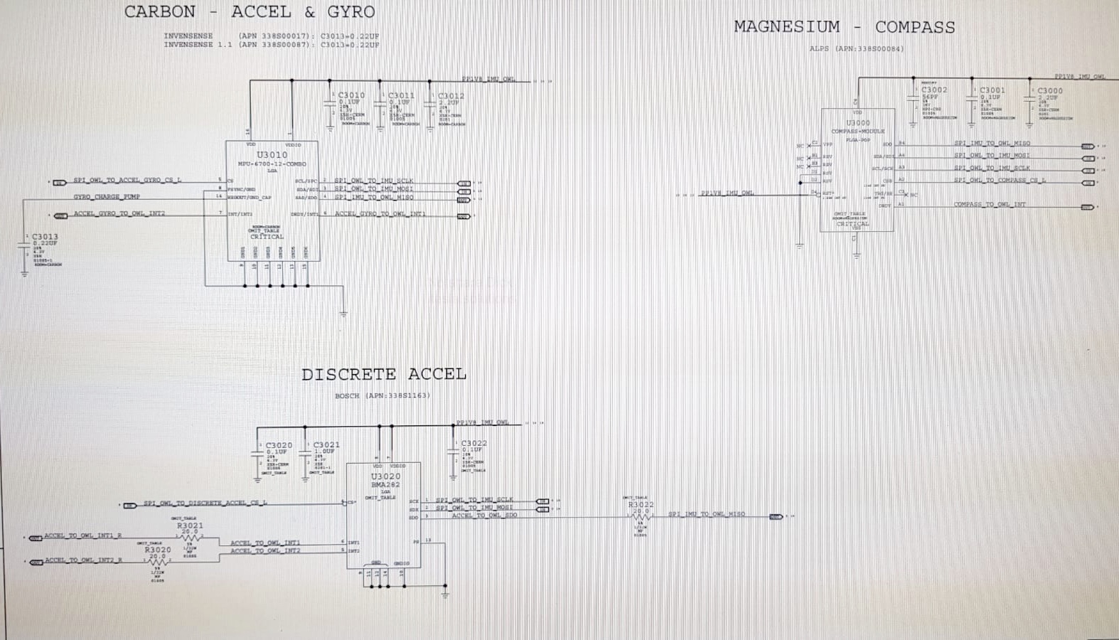

    Accelerometer, gyro, compass: Which one for orientation?
    Have an iPhone which screen orientation doesn't work and is stuck in one direction. The compass app also doesn't work.
    Tried a restore and no change so its hardware related but I don't know which one is responsible for the issue. Do they all work together? I figured it'd be the gyro circuit but since the compass doesn't work as well I'm wondering if it's the compass circuit?

    Re: Accelerometer, gyro, compass: Which one for orientation?
    compass, the others detect movement.
    although if they share a databus one could silence the others.
      No (I read the OP's post as "his screen is stuck in landscape/portrait mode and won't switch to portrait/landscape when he reorients the phone").
      The accelerometer tells the phone which way is DOWN; the compass tells it which way is NORTH!
        Thanks. So the gyro isn't responsible for screen orientation?
          no, the compass indicates actual direction in relation to the planet,
          the gyro detects movement in 3 axis - but not relative to [up] afaik,
          the accelerometer detects how fast you move the phone.
          so the gyro and accelerometer are used together to tell if you move the fone, and how fast - but not which way it's facing.
            So the compass and screen orientation issue are separate?
                            I replaced the accelerometer and screen orientation was fixed. However compass still doesn’t function. So I suppose they’re not one in the same
