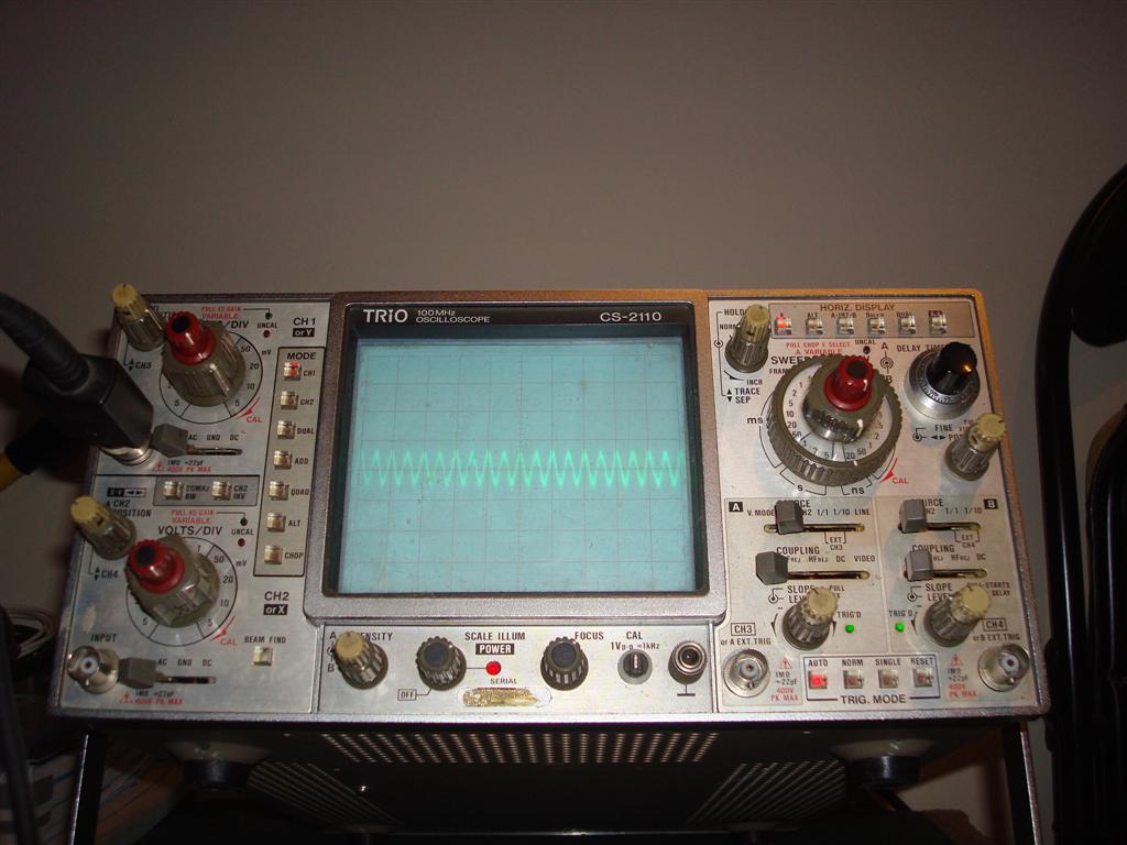

    Hi Guys,
    So I borrowed a 100Mhz scope and decided to try and visually see the effects on voltage of bad caps. I got myself a old Piii mobo with some leaking caps, although the computer itself never blue screened.
    This brings me to my first question: Will bad caps menifest themselves by excessive ripple current?
    And my second question : If so should I measure ripple current with the scope on AC?
    My method so far was to hook up the scope to a cap near the CPU. I have got the V/div setting on 5mV and the time/div on 20ns. I am using 10:1 probes.
    As a result my trace is peak to peak about 1.5 div, so I calculate :
    5mV = 0.005V = 1.5div * 0.005v = 0.0075v but now factor in the 10:1 probes gives 0.075v.
    The actual volts coming out of the Cap is 1.63 and 0.075/1.63 is 4%. So I am not sure if this is the correct terminology (or hell even if my methods are correct) but I estimate 4% ripple current.
    Now would I go to the Intel Piii spec sheet to see if this is within limits for that processor?

    You are correct, you have set the scope on AC, not DC. And a minor quibble. You are measuring ripple voltage, not current.

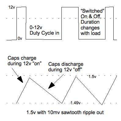

          • KeriJane
            Mac Enthusiast
            • Sep 2008
            • 681
            Re: Ripple Current
            Hi BigAINZ
            Back from the Pool!
            Anyhow, here's the idea of SMPS as I understand it in drawing form.
            The upper trace represents the 12v supply. It is "switched" on/off at a fixed frequency, but of variable duration.
            The switched 12v charges the Filter capacitors until the microcontroller sees the output voltage is high enough (1.5v in this example). Then, the 12v is shut off and the caps discharge into the circuit until the next cycle begins. Since the caps store a charge, they supply current until the next cycle begins and the output voltage only drops 10mv.
            The lower trace represents a sample 1.5V circuit with 10mv ripple in a nice sawtooth pattern. The microcontroller senses the output voltage and adjusts the 12v duty cycle to maintain the desired voltage average.
            If the load increases, the average output voltage goes down and the controller increases the duty cycle. opposite for reduced load.
            Bad caps do not store a good charge, so the output ripple goes up to maintain the average. If the caps go totally "open" the Inductor will still provide a little filtering but the ripple can increase to very high levels and cause instability or damage circuits. The controller will often shut down in such a case but not always.

                          Ok - but (a) you agree that I should be able to hook the probe up to the leg of a cap, and the clip to gnd and then use the v/div setting to zoom in on the trace and work out the peak to peak voltage ripple? And (b) that a good VRM system should have no ripple?
                          Trying to get my head around all this..
                          -Al

                            Yes that's how you check.
                            Adjust scope for the frequency you expect to see.
                            200kHz is a good place to start for SMPS.
                            At other [higher] frequencies there will also be a small amount of RF noise but that is handled by the tiny caps in the CPU socket or in the CPU itself depending on what kind of CPU it is. [Off the top of my head, for those I've looked up they were ~22uF and were 20+ of them.]

                              Thanks for all this. It really sounds like a scope my not help much when looking at Vcore . I really should pull my finger out and get one of Atlas ESR meters.

                                Scopes can help a lot but you have to use a little math and figure out what your looking for to set them right.
                                On the other hand you still need an ESR meter because caps in Vcore are in parallel and if only some or one are bad you'll never figure out which one(s) without removing them and checking ESR.
