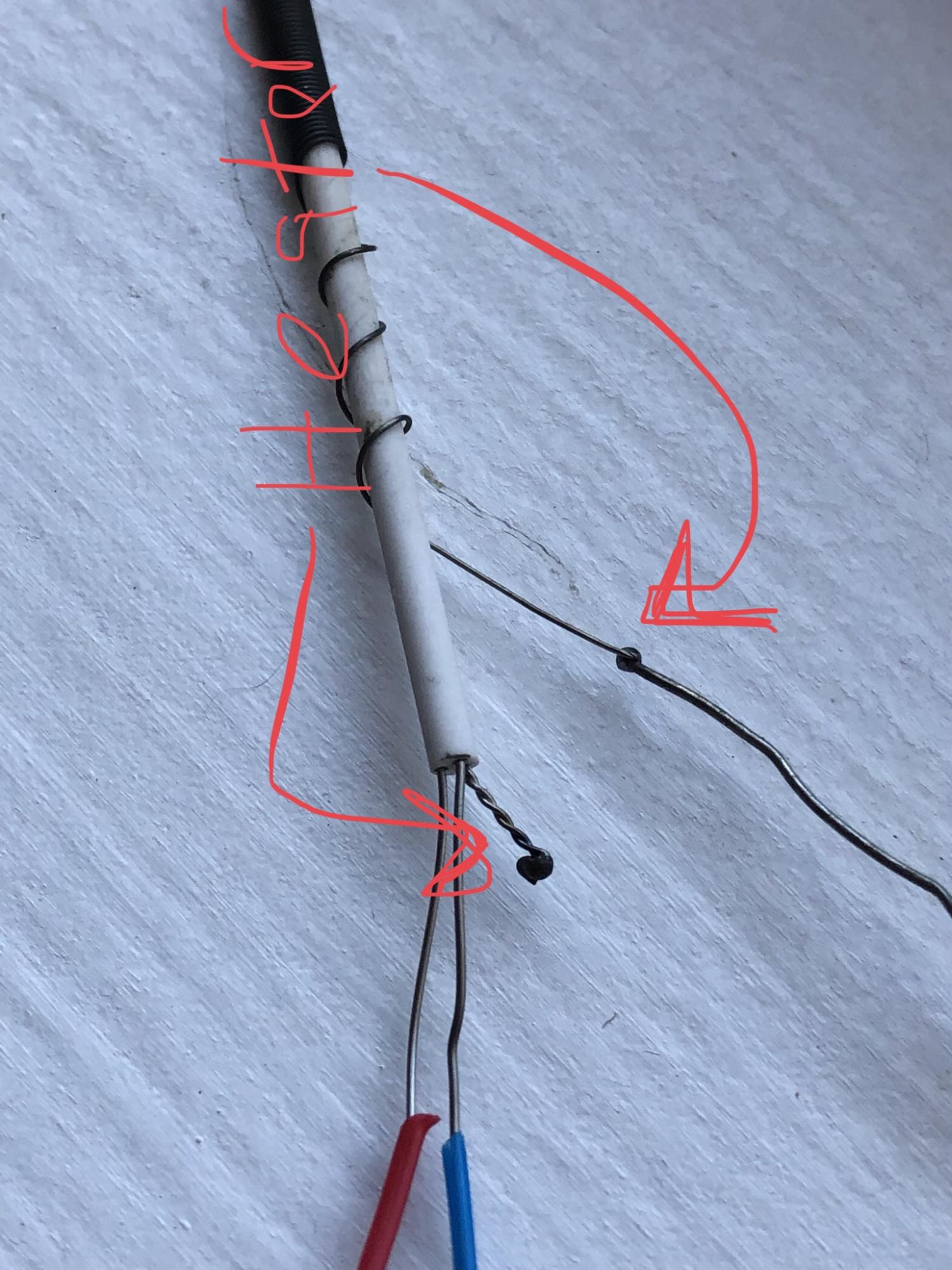

    I have a variable soldering iron that uses 24v 50w heating elements.
    I'm wondering how the temperature is controlled, is the 24vac constant and pulsed per setting or is it like a light dimmer where it operates in any range up to 24vac?
    Also the heating element itself, I noticed one end has another wire twisted to it which is then spot welded to the wire that is soldered on the PCB of the iron. Curious why only one end is twisted with another wire and not both sides?

      The wires are coming from the heater element not the thermocouple. The thermocouple wires are the red and blue

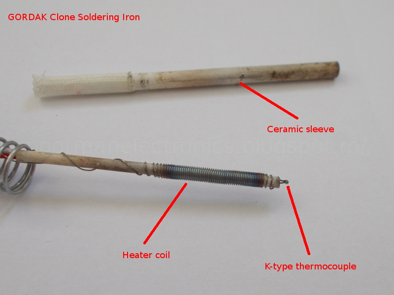

          Usually thermocouples aren't wound in a tight spiral like heater elements, but don't know, that solder iron heater looks weird.
            • 31254
            Re: Variable soldering iron heater construction and operation questions
            interesting picture.

              It's not fair, I didn't see it clearly. Because I used my mobile phone at work, I went home and saw it with pc, I found out the heating coil was out side the ceramic tube. WOW....I lost my bet.

                  Yes the outside ceramic tube is removed. And if you notice one end of the heating coil I had another wire twisted around it but the other end doesn’t. That’s what I’m curious about, is there a reason for that?

                    I can't see the other end, but I think the heater wire is doubled-up for the center run, so it doesn't heat up. You want the outside coil as the heater, not the center run glowing orange hot.
                    It's still odd because there are three wire ends, where is the fourth
