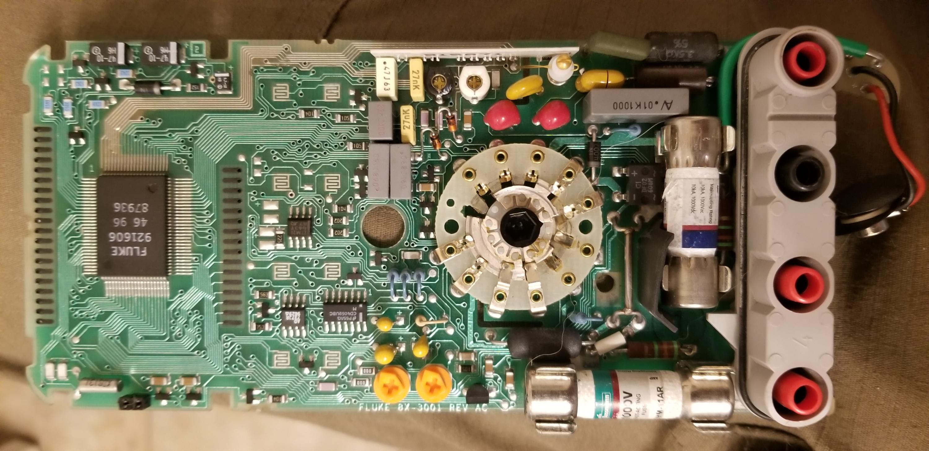

    Somehow my fluke went out. I checked the normal things, fuses, etc and upon opening it all the way, found what looked like old water damage. Anyway, Ive narrowed it down to two bad surface mount resistors. A blue 1073 and a similar 2103. I'd like to order these but I have no idea, where or what kind they actually are. They are .3 mm long. Any ideas?

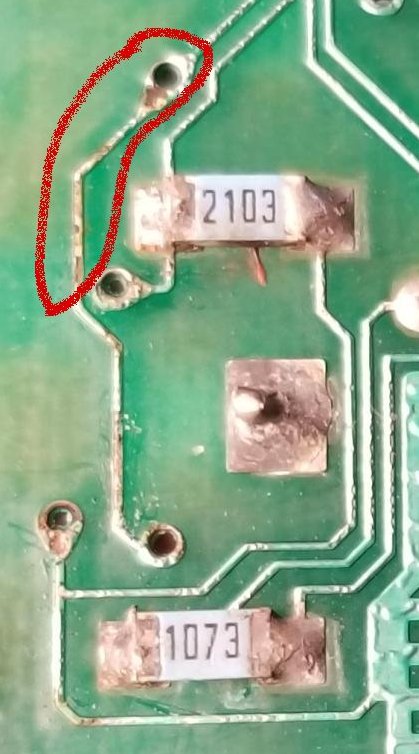

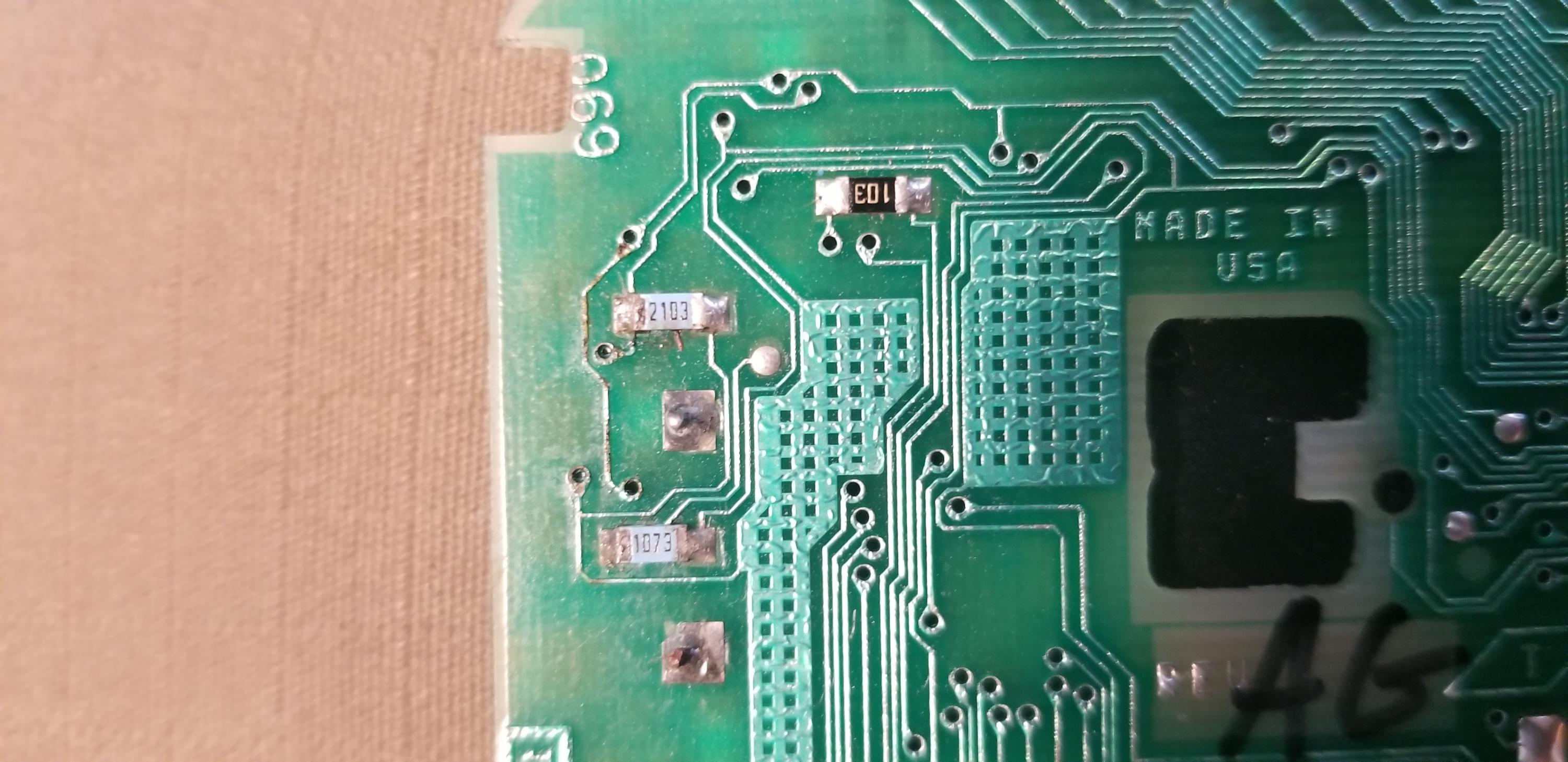

            Ok, hopefully this works. You can see the two blue ones that are bad. I looked at that website already and unless I'm measuring them wrong, they don't show any this small

              Sorry, this shows the two I'm looking for

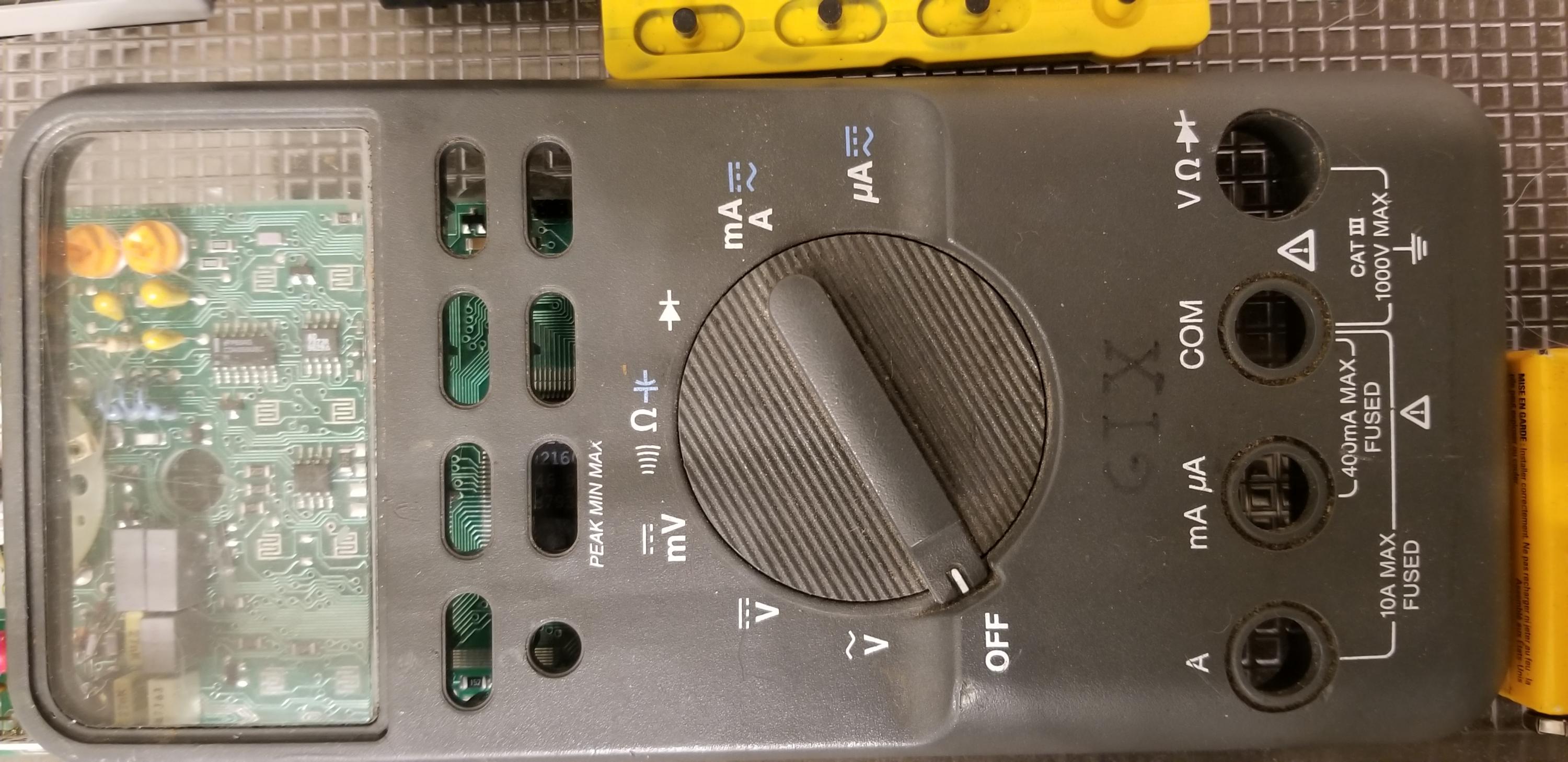

                Those are good pics.
                1) You have a Fluke 87 II (with the CAT III ratings by the Volt/ohm jack). It is the 87 I, but with update CAT requirements.
                2) In your picture with the 2103 and 1073 SMD resistors, you clearly have some corrosion in that area from the water. A thorough cleaning of pcb with IPA is recommended.
                The pcb tracks around that entire area could be broken with no continuity and the SMD resistors may not be touching their solder pads.
                3) I suggest looking at modemhead's blog pictures and fixes for #2 above.
                http://mrmodemhead.com/blog/fluke-23-iii-dmm-repair/
                http://mrmodemhead.com/blog/fluke-77...per-corrosion/
                4) The track to 2103 is clearly missing. You can see the solder clearly missing.

                  You know I didn't even see that? Looking at the board with the bare eye, it looks intact, I had to look at the picture to see what you were referring to and then got the board under a magnifying glass and sure enough. I'm going to follow the directions from your link later today and see if that works. I'll post my results. Thank you again. Love this website.

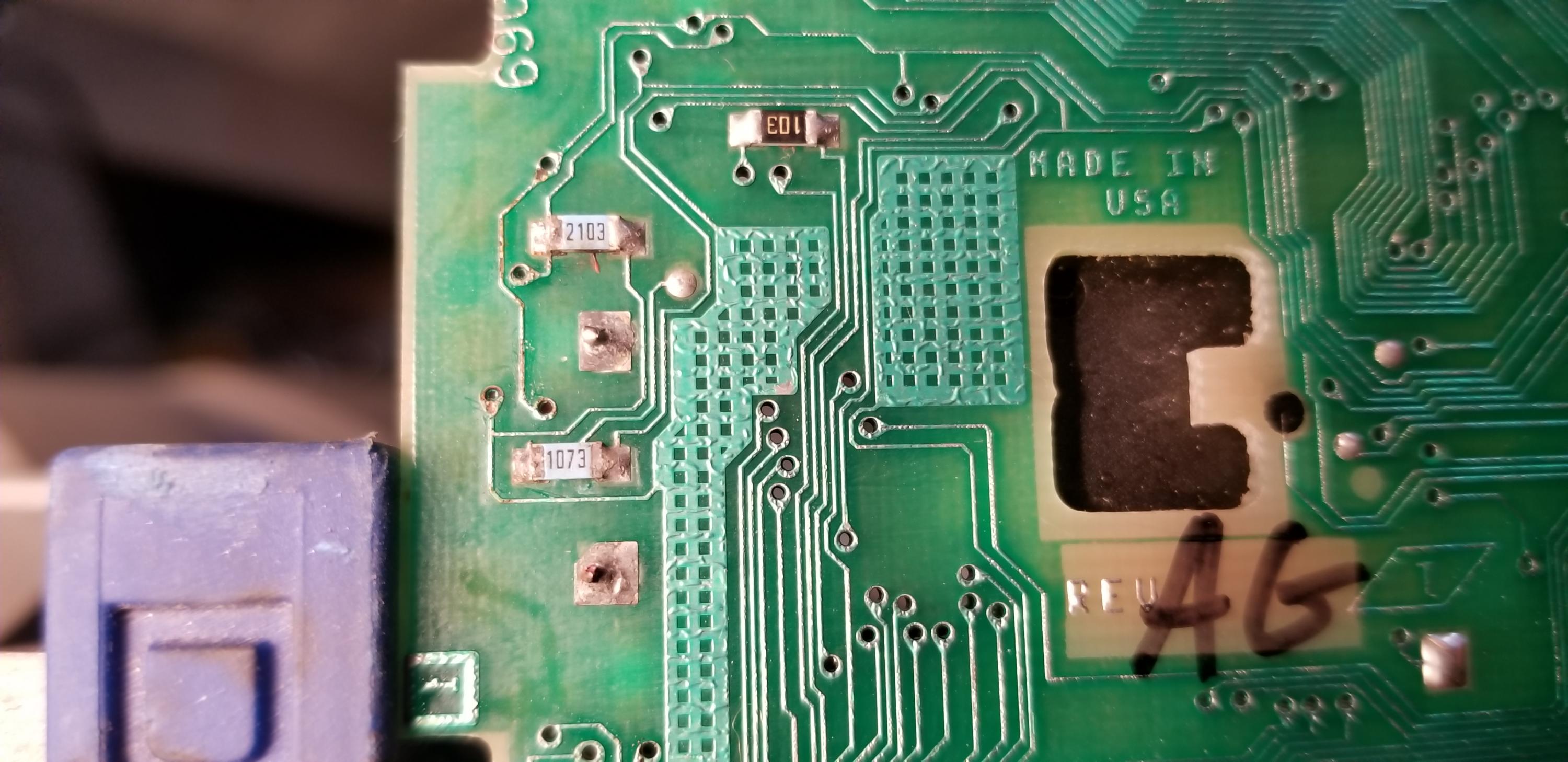

                    Well, upon further investigation, and checking it with my meter, that line is still intact. It's the coating that's came off. Those two caps read 89k and 130k respectively. I know I should remove them to read them but checking all the other ones, and the fact they are reading within limits, I'm still thinking those two are shot. That whole corner of the board is where the corrosion damage was.

                        This area still looks suspect to me in the photo.
