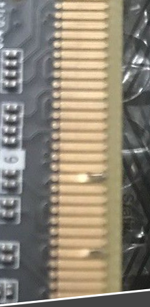

    Fixing a pealing PCB contact
    I know these happen to be ground pins, so bypassing it would be easy
    buy is the proper way to glue them down, if so what kind of glue, supper glue, hypoxy, etc.?

    Re: Fixing a pealing PCB contact
    with decent epoxy.
      CircuitWorks CW2500 as used in this video looks good stuff
        https://www.youtube.com/watch?v=vx50YtEC2S8
        Yes, it's good stuff, but not cheap.
          So would JB Weld Kwik or original be ok to use?
          https://www.amazon.com/J-B-Weld-8276.../dp/B0006O1ICY
          https://www.amazon.com/J-B-Weld-8265.../dp/B0006O1ICE
          I have both on hand
          i could use some electrical tape to keep it off the other contacts and then clamp (tape would protect pcb from clamp) it and let it sit a day and use some rubbing alcohol to get any tape glue off
          or would that just be a bad way to do it?
            being edge connectors i would try superglue . should only need pushing onto socket once. whatever you use it needs to be very runny so it is very thin .
