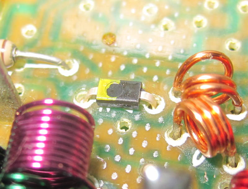

                                I SEE YOU, LITTLE BUGGER!!! STOP HIDING! (though I don't know about all the SMD on the other side of the board...)
                                Anyway, thank you silkscreen!
                                Unfortunately it still is an unmarked. Hopefully I can get its capacitance and it falls into the range I need...
