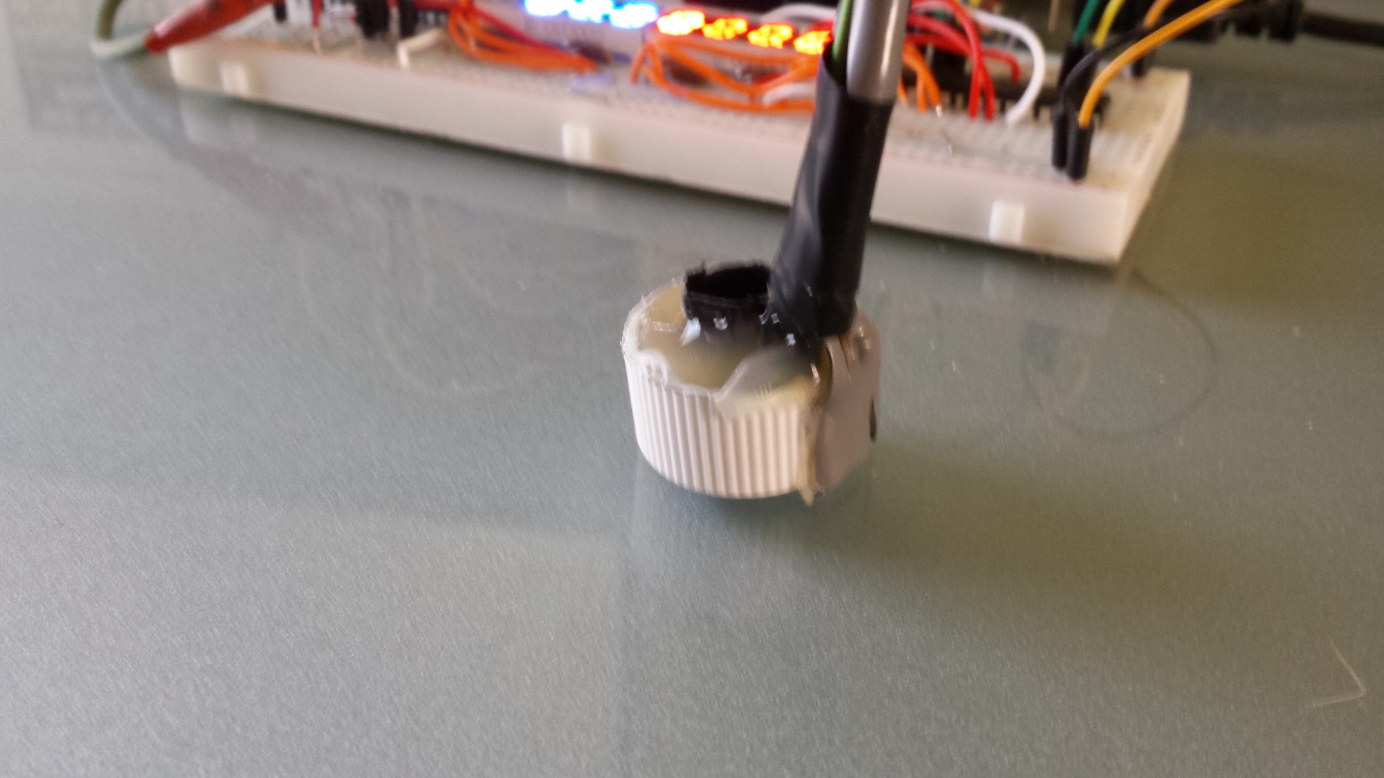

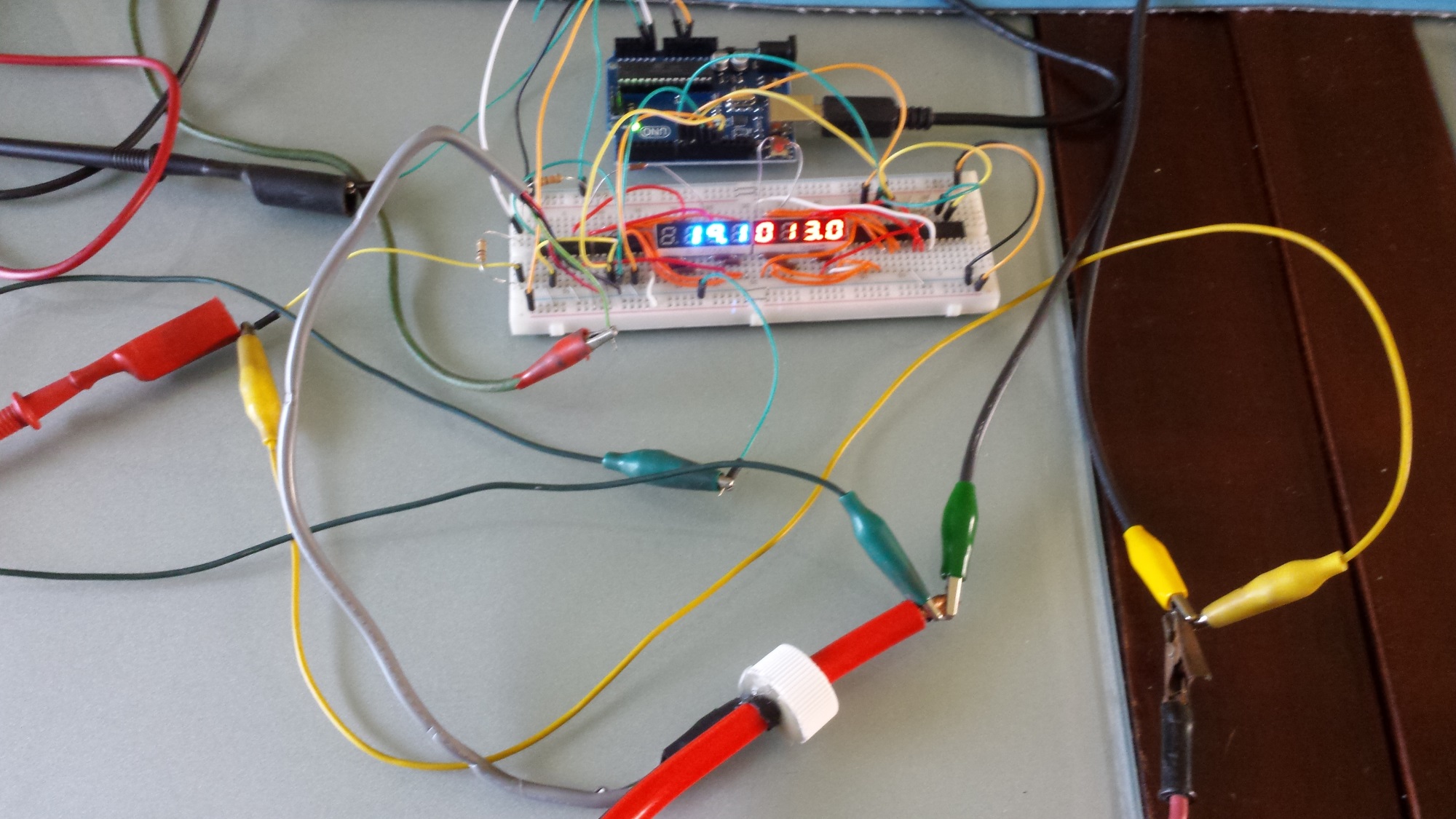

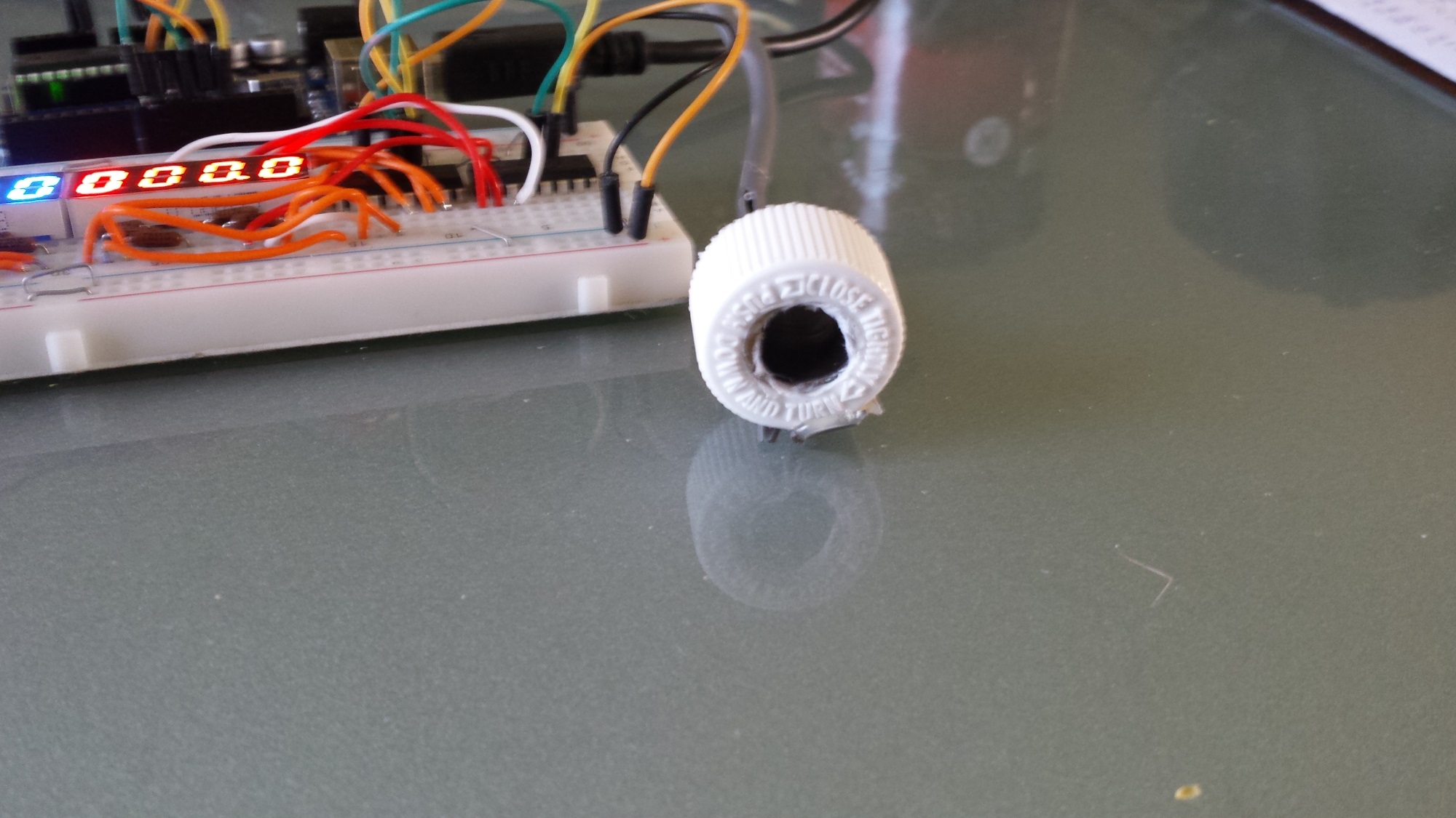

    A few years ago, I made an electric scooter out of an old bicycle and a motor off of a battery powered lawn mower. I purchased one of those cheap volt/amp meters off ebay, but the amp meter (shunt method) never worked properly. I emailed back and forth with the company, but never could get it to work. So I decided that I would make my own volt/amp meter using an Arduino. It worked great.
    The part that you would be interested in is the hall effect sensor. I drilled a hole in bottle cap, and encased the hall sensor in hot melt glue inside the cap. This left a hollow for the wire that you are monitoring to go through. Once you get everything wired up, you will have to do some calibrating on the arduino, so you'll need a parallel current measurement to guide you. I used 7 segment displays with shift registers, but you probably don't need those.
    It's been a while since I worked on the circuit or the code, but if you decide to go the hall sensor route, I'll attempt to help where possible.

      Interesting. You made that hall sensor yourself ? If so, I'd like some guidelines to make my own. I'd require 2 (one for each window). I expect the current to be somewhere around 30A at full load (at least that's what the fuses in the fusebox for the windows are rated at). It's non-intrusive, so it doesn't cause any voltage drop on the motors, plus you don't have to cut anything....well yeah, technically you HAVE to cut the wire to pass it through, but I'm lucky enough to have spade connectors on those rocker switches, so I can pass the wire through without any chopping. Also no, I don't require any displays or indicators - those would just drain the battery, so it also has to be made as energy-conservative as possible. I'm thinking of somehow making the arduino shut itself down after the car's been fully locked and the windows are rolled up....don't want to wake up to a flat battery one morning....

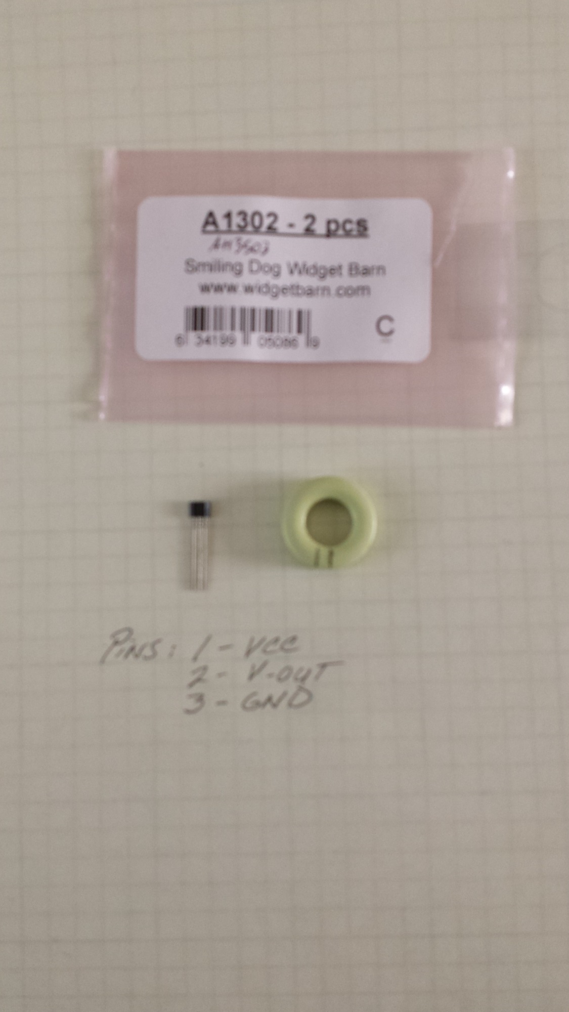

          The one that I made was good up to 100A. You first need to order 2 sensors and find (or order) 2 ferrite cores. I usually pull the cores off of old pcbs. They'll have copper wire wound around them. Try to find cores with inside diameters as close as possible to the size of the wire that you will be monitoring.
          I'm attaching a pic and another datasheet. In the pic, you will see that I drew some pencil lines on the core. You will have to use a dremel tool to cut a slot in the core for the sensor. You want the slot to be narrow enough, so that you almost have to force the sensor into the gap, a tight fit. I would not encase the sensor and core until you do some testing with the arduino. As current flows, the v-out pin of the sensor will send a voltage to the arduino. You calibrate with your code until you have an accurate current measurement. Then, in your case, you code for turning on and off relays that run your motors.

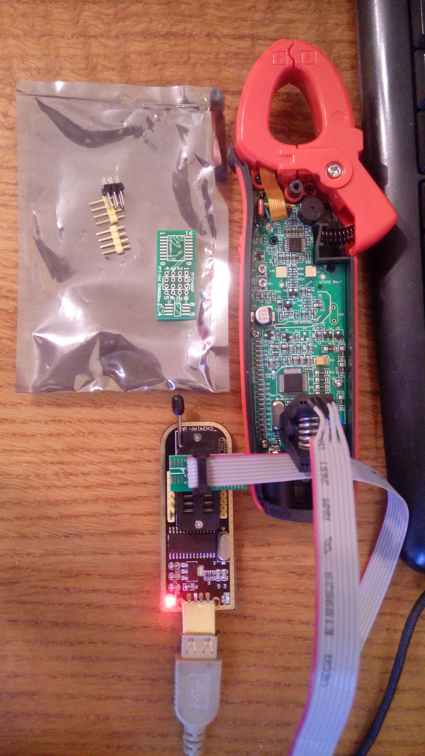

                        That's the one I want to get also. What'd you hack it to do ?

                          • 31070
                          Re: Arduino current sensing (in car)
                          10,000 count and all ranges start in DC mode,
                          + NCV with numeric readout (in mv range)
                          oh yea, and because it's 10,000 count instead of 2000 all current ranges roll at 9999 so the maximum is theoretically 1KA !! although tests by others have shown accuracy starts to drift after about 350A
                          oh yes, and it doesnt turn off until i want it too - and that includes the damned backlight.
                          use ENELOOP or LADDA (Ikea brand) NiMh battery's in it.
                          modern shit alkalines seem to just love fucking decent multimeters!!!!!
                          i think it's the ultra-low current draw causing it.

                              • 31070
                              it has an 8pin eeprom (24c02) that holds the configuration and calibration data.
                              not my foto btw.
