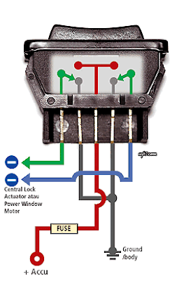

                              I just received those current sensors I ordered...haven't messed around with them yet, but in the meantime, my code reaching completion, I still haven't decided what the best course of action is regarding the different inputs: should I use "active high" or "active low" ? That is, should the pins read off when LOW or off when HIGH ? Power consumption is important, because the thing will be running on the car's battery, plus it has to be relatively noise-resistant, and in this regard I did some research and learned that the simplest form of debouncing is to add a capacitor between the pin and GND, of course this would require the "active low" setup, which is what I currently got going on on the breadboard, but how it will behave in the actual vehicle I have no idea....

                                #75
                                Re: Arduino current sensing (in car)
                                active low,
                                if you use active high you need to screw around with voltage clamping and other shit.
                                  #76
                                  I still need to clamp it to 5v anyhow, since I can't pull up or supply the board with more than that.
                                  Wattevah...
                                      pullups enabled on the microcontroller, and inputs connected through diodes - job done.
                                        #79
                                        It's a little more complicated than that, since I'm going to be using the existing rocker switches in the dash, but instead of connecting their outputs to the windows (like they are now), I'll connect them to the micro....right away there's a lot of difficulties: active low is not possible in this setup straight away, because if you know how a window rocker switch operates you know it keeps the outputs (the wires going into the actual motor) grounded at all times when not in use. When you flip it in one direction, one of the wires continues to remain grounded, while the other one is pulled high to VCC, so the motor goes in one direction. When rocked in the other direction, the wire which was VCC goes to GND and vice versa.
                                        So imagine the green and blue wires go to the motor in the door (don't mind the text, except the GND and VCC which are accurate), so what I'll do is cut them, put some connectors on them to make the install easier, then connect them to a NPN transistor each: one for UP, one for DOWN. When pressed in one direction, let's say "UP", 12v will go into the base of the "UP" transistor, pulling the E-C path to GND and the micro's "UP" pin with it, activating the corresponding pin of the H-bridge we'll be putting in. Meanwhile, the "DOWN" transistor's base remains grounded through the other wire which used to go to the motor....that's the theory at least.
                                        Trouble is, I'm not sure it will work to begin with and what trannies to use after the fact, especially since I'm using them somewhat opposite of how they're normally used: I'm switching a LOW signal with a HIGH signal, which brings us to problem no.2: the car operates at 12-15v (when running)....no need to say more. The buck converters I got off banggood should do the job of powering the while providing sufficient noise suppression....I hope....that's why I'm sharing this project, to hear other peoples' opinions and hopefully build it as robustly as possible.
                                        Granted, if I knew what I was doing, I wouldn't be posting asking for advice and it wouldn't be nearly as fun...half the fun is figuring out all this sh!t...some people hate it, but I like it...I love tinkering to waste time
                                        Wattevah...
                                          #80
                                          connect the red to ground and the blue & green to the mcu.
