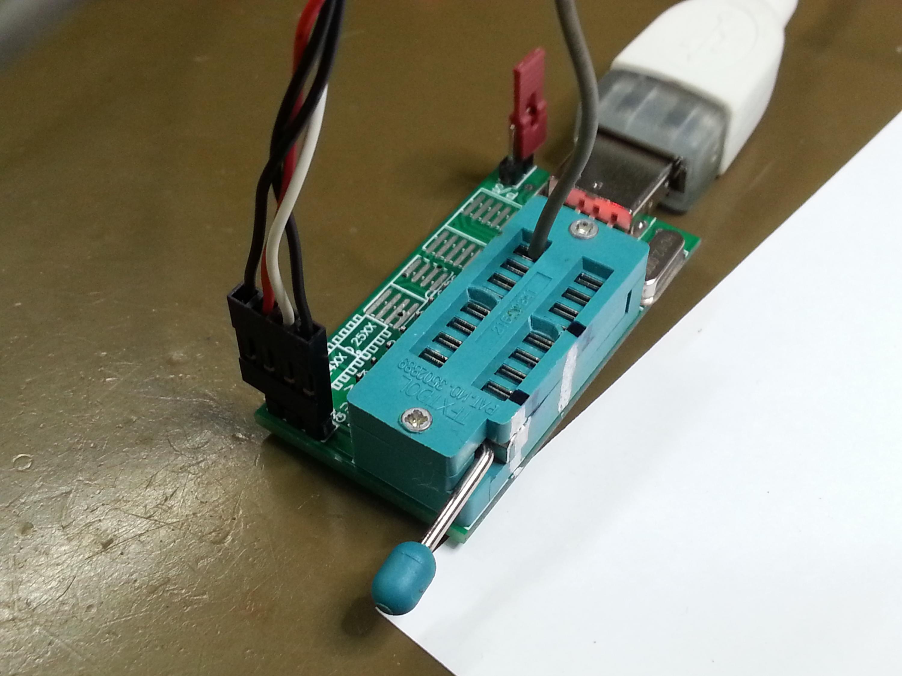

            Well it's not really black, but sure It's this. Still, I wanted to keep it as simple as possible, so I'll push on with the serial method since ISP seems tough to achieve with the arduino IDE...or at least I THINK so.
            Back to that cap you asked about: should it go between RST and GND or something ? This programmer doesn't have a RST pin so I'm guessing that's the issue....

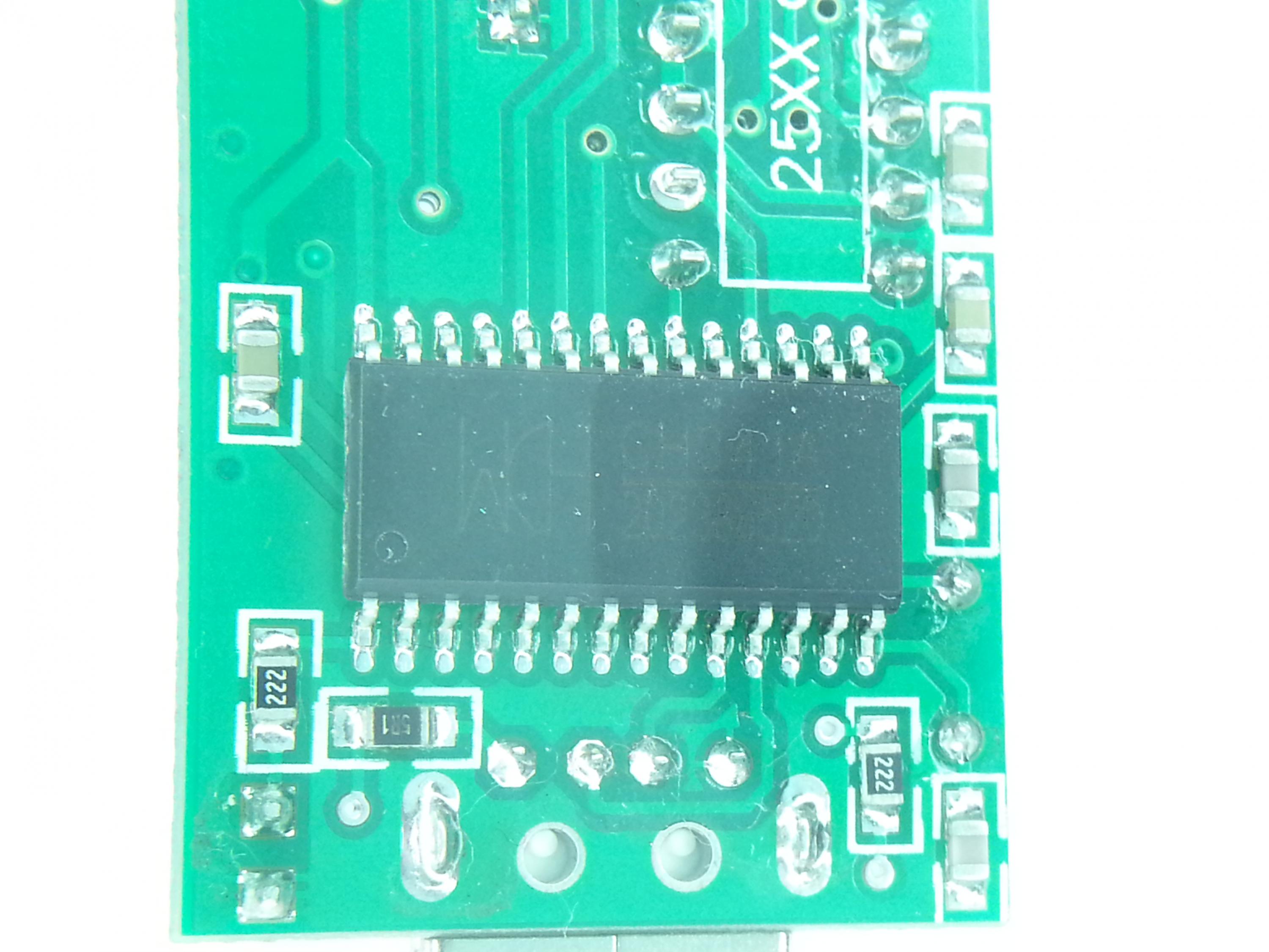

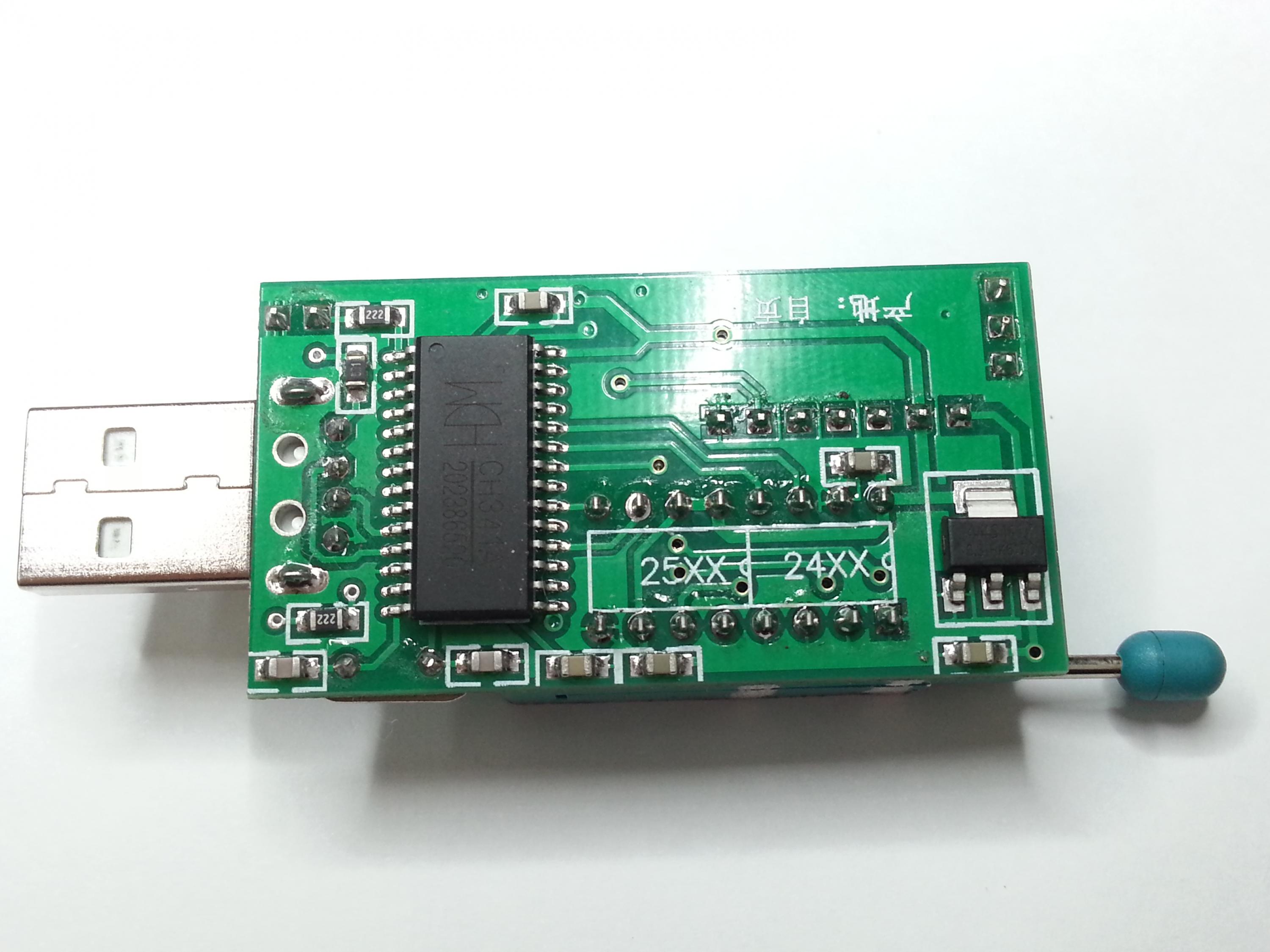

                    #129
                    Re: 555 countdown timer design question
                    It is a CH341A and here are some pics up close...damn I need a macro lens for my DSLR >_>

                      #130
                      you need to connect the 100n cap between your programmer pin20 which usefully appears to connect to the green socket, to the reset pin on the arduino.
                        • 31090
                        #131
                        btw, second picture, lower left.
                        5.1ohm resistor looks burned - did you try to power something big through the programmer, or short something??
                          Yes it does look like sh!t, I agree....never even noticed now that you mention it. No, I don't believe it got overloaded in any way and the resistor checks fine on my meter, so it's not faulty, plus the programmer works.
                          So I should place the cap between pin 20 and the reset pin ? Dumb question again, but what does the cap actually do ? Why not a piece of wire for instance ? Is a ceramic capacitor with 104 on it the right one ? I suck at these, I told you that

                            #133
                            Ok, works perfectly now: that cap between pin 20 and the reset pin did the trick. Big shoutout to STJ for the help...here's the setup: the gray piece of wire stuck into the ZIF socket corresponding to pin 20 of the CH341 on the bottom goes to the cap and then the other end of the cap has another piece of wire stuck into the breadboard on the RST pin. A CD ROM audio cable came in very handy for fashioning a "programming cable" because I could just insert it straight into the TX/RX male headers on the CH341 without having to run individual jumpers and make a mess of wires everywhere
