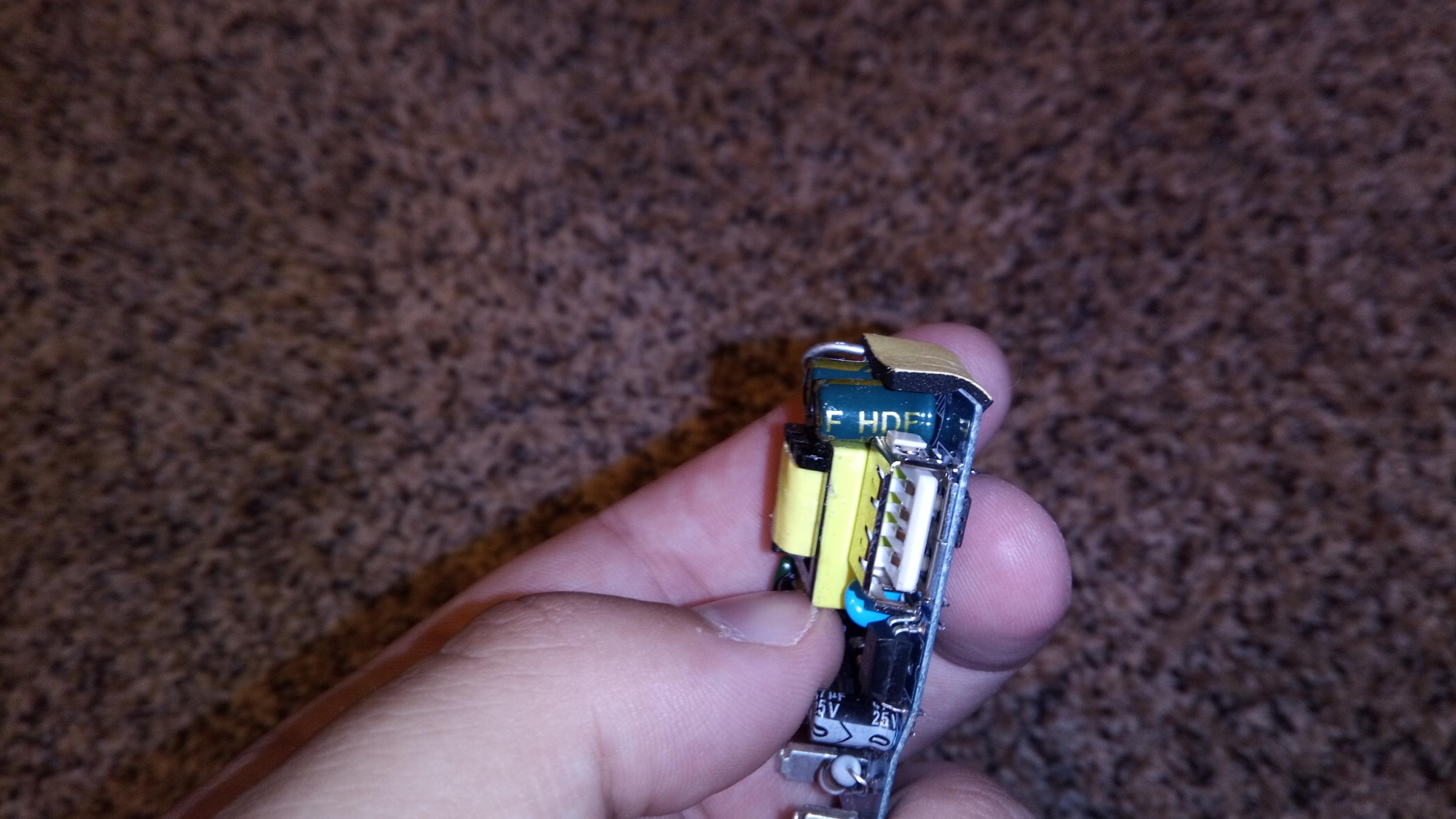

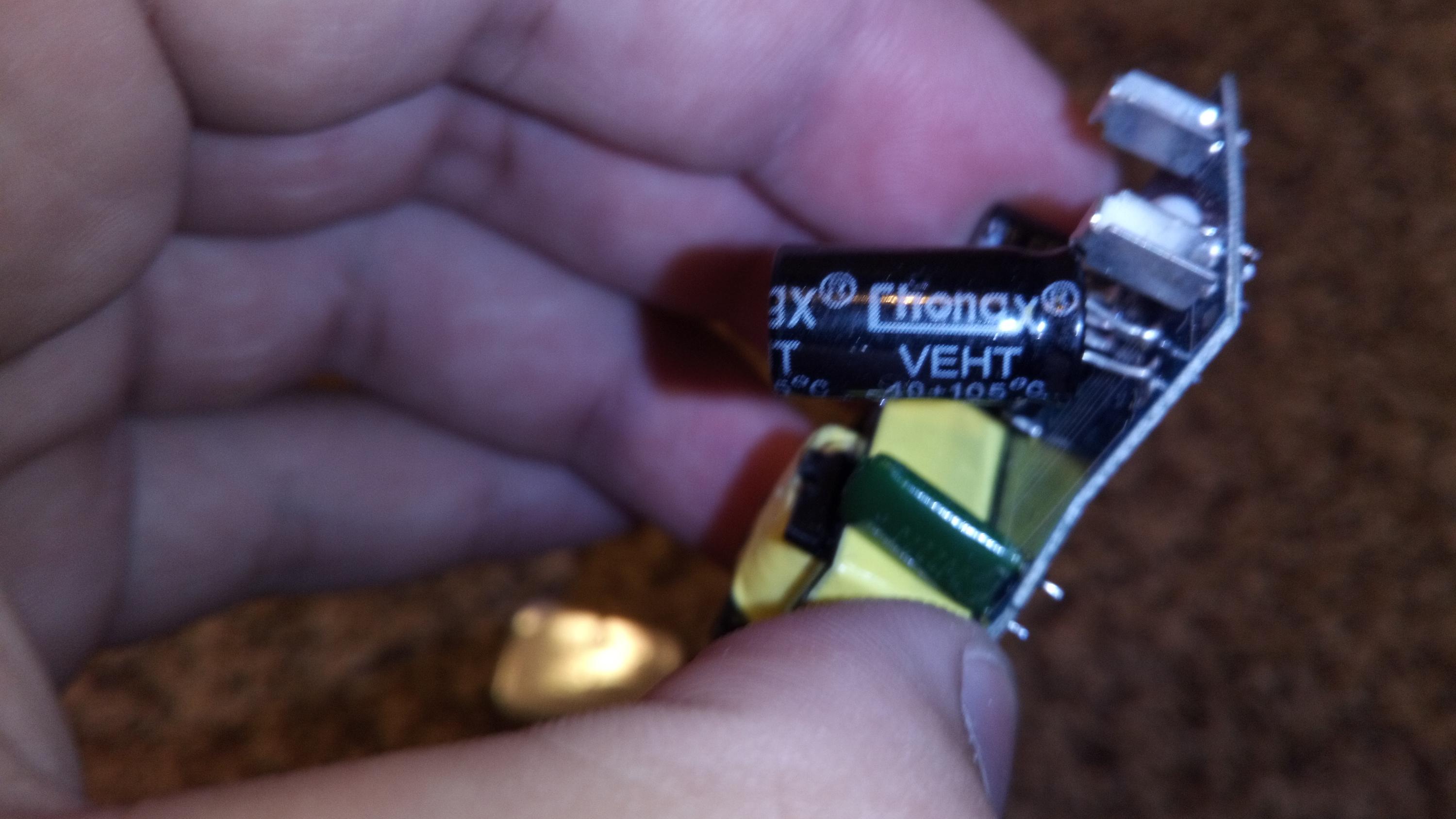

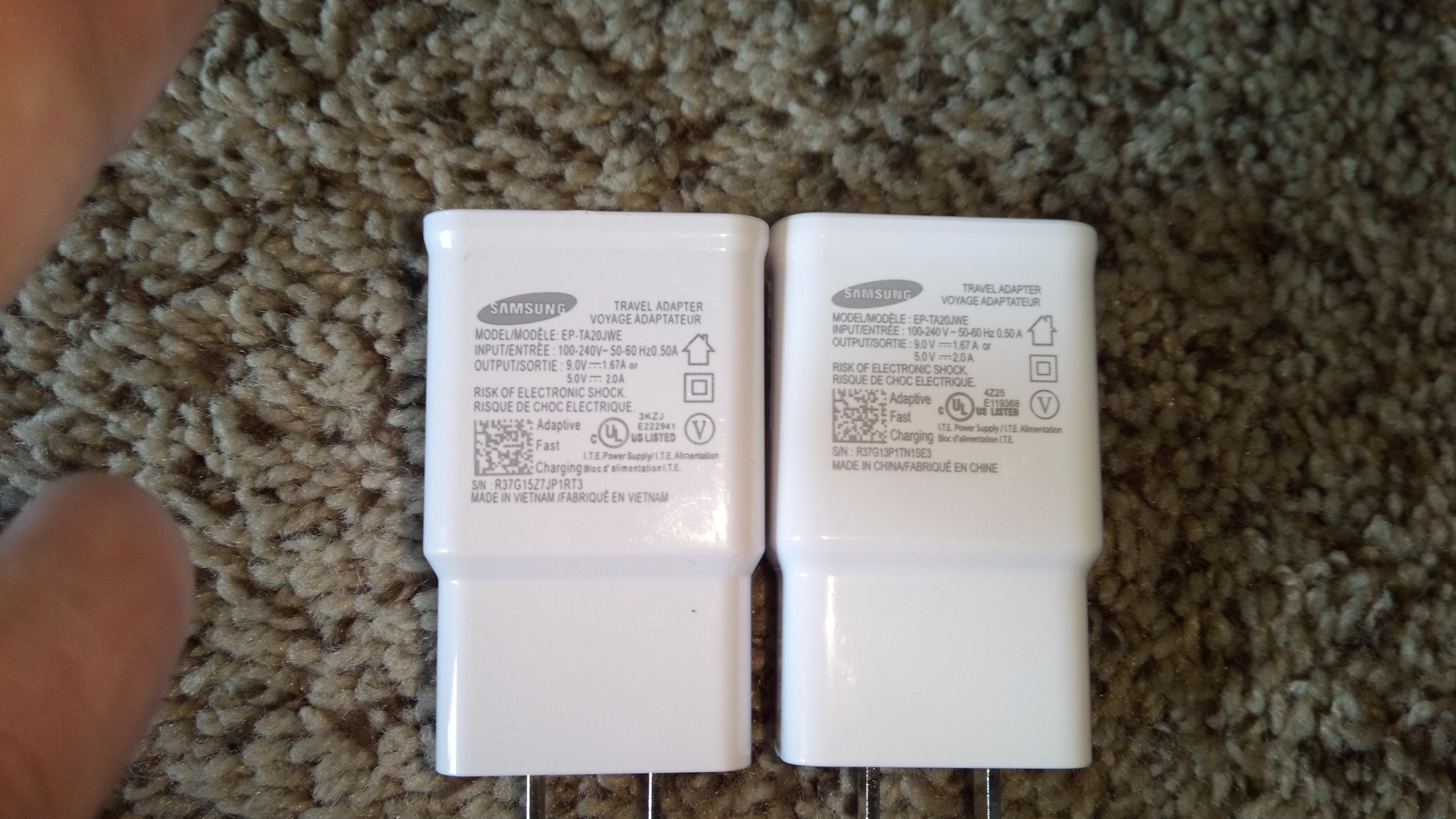

    So my mother ordered a Samsung charger for her S6, the adaptive fast ones.

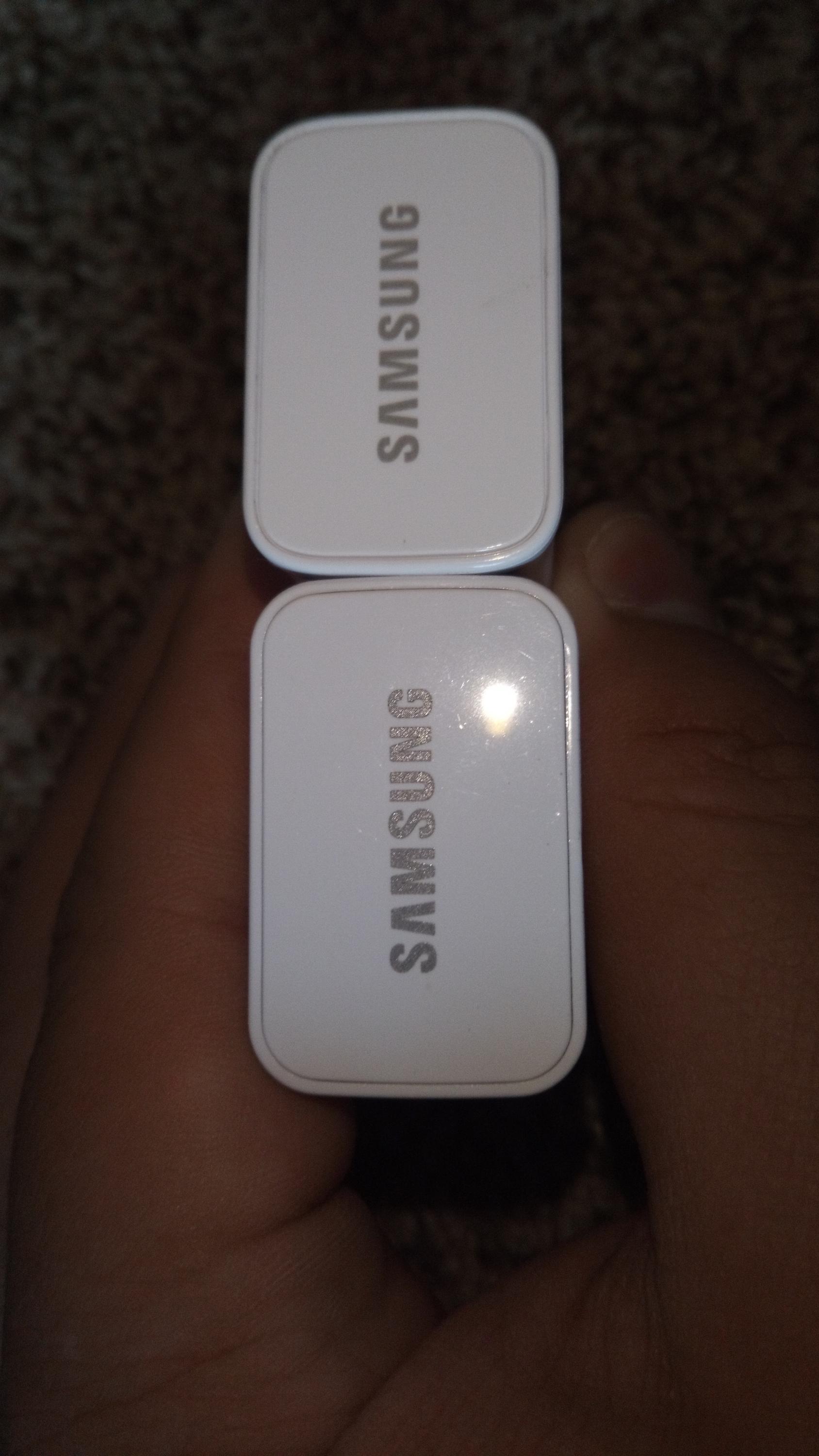

    It arrived today, however upon opening it I immediately smelled something fishy. It was not in a Samsung box, it was in a plastic bag, as were the other cables too. When I held the charger in my hand, it felt lighter than the real one that was in my other hand. Upon further inspection, I found the following:
    UL number was fake
    It was shitty printing that could be peeled off with my finger
    Fonts were wrong
    Text was too bold

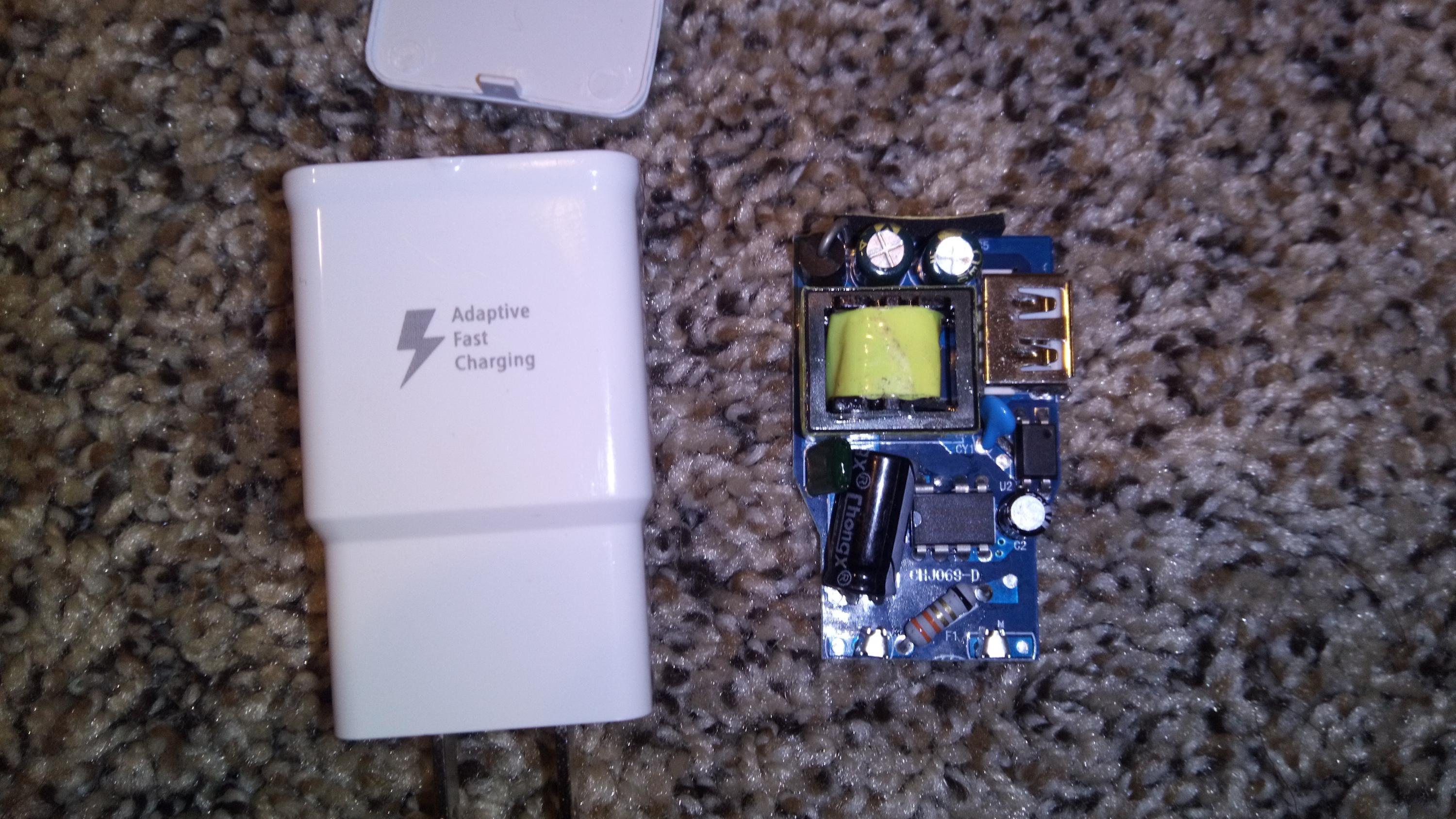

    So I opened it up and Yep! It's a heap!

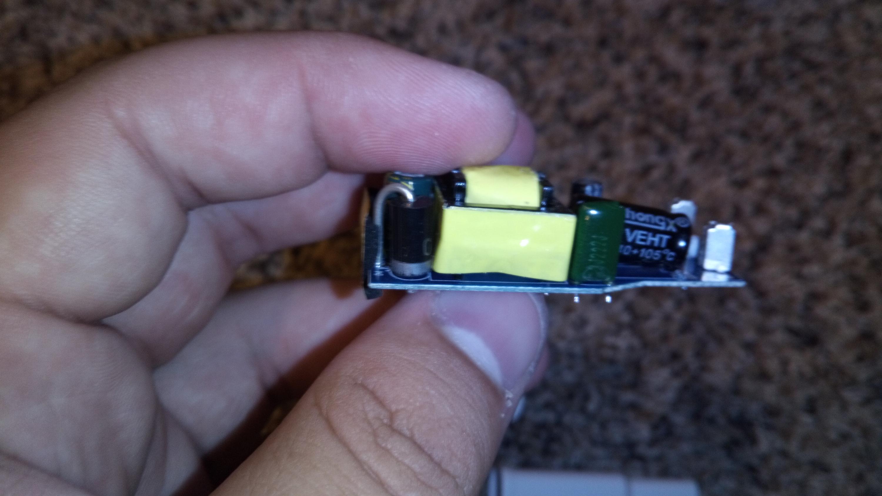

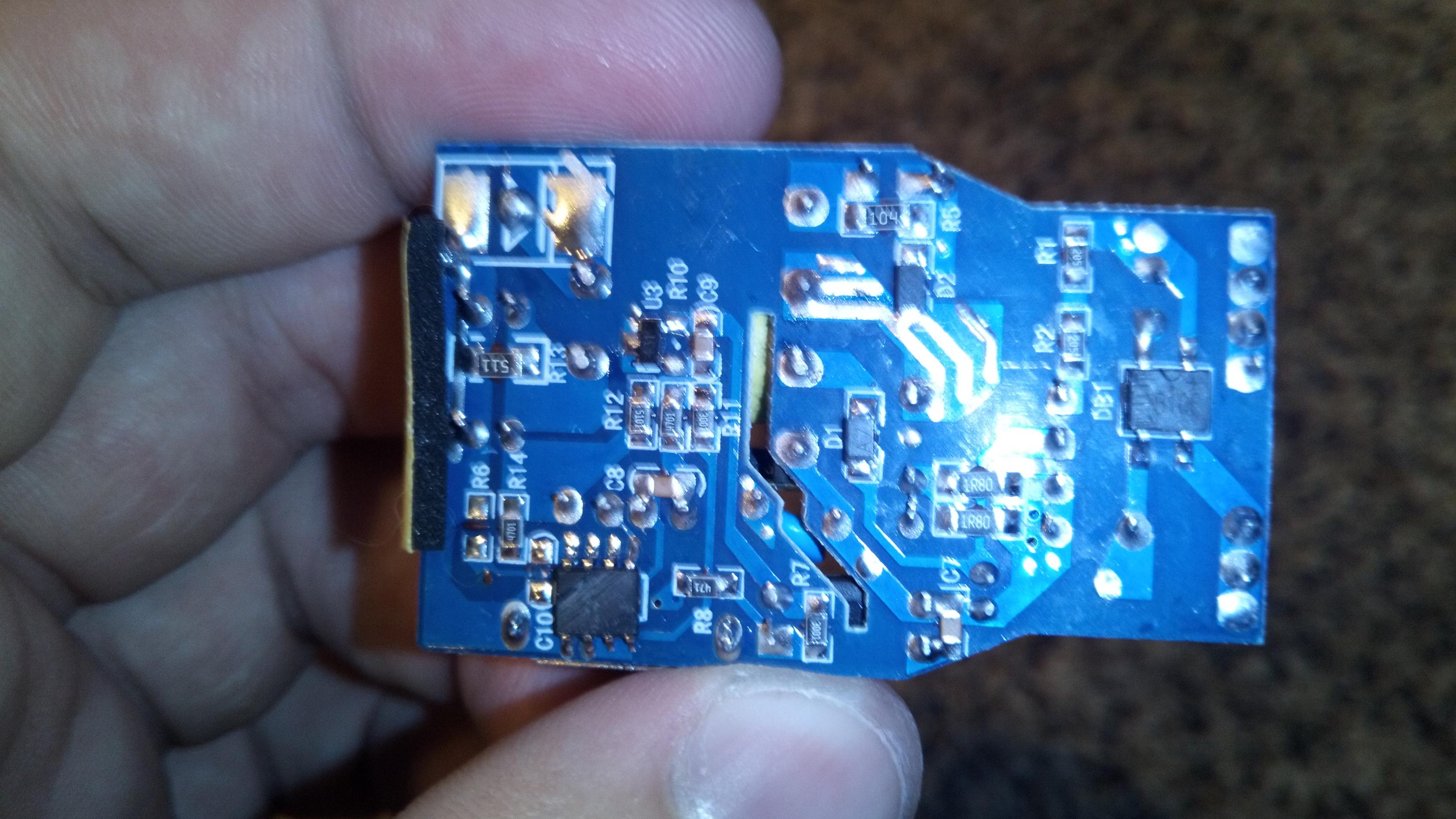

    I'm gonna upload pictures below, but I found something really unusual on the output. There is a chip on the bottom for the voltage regulation for the adaptive fast charging, when filing off the number on top, they took a large portion of the chip with it.
    Caps were:
    Primary: 10uF 400v ChongX
    Transformer: 25v 47uF Huahong
    Output: "LOW ESR" 470uF 10v HDF

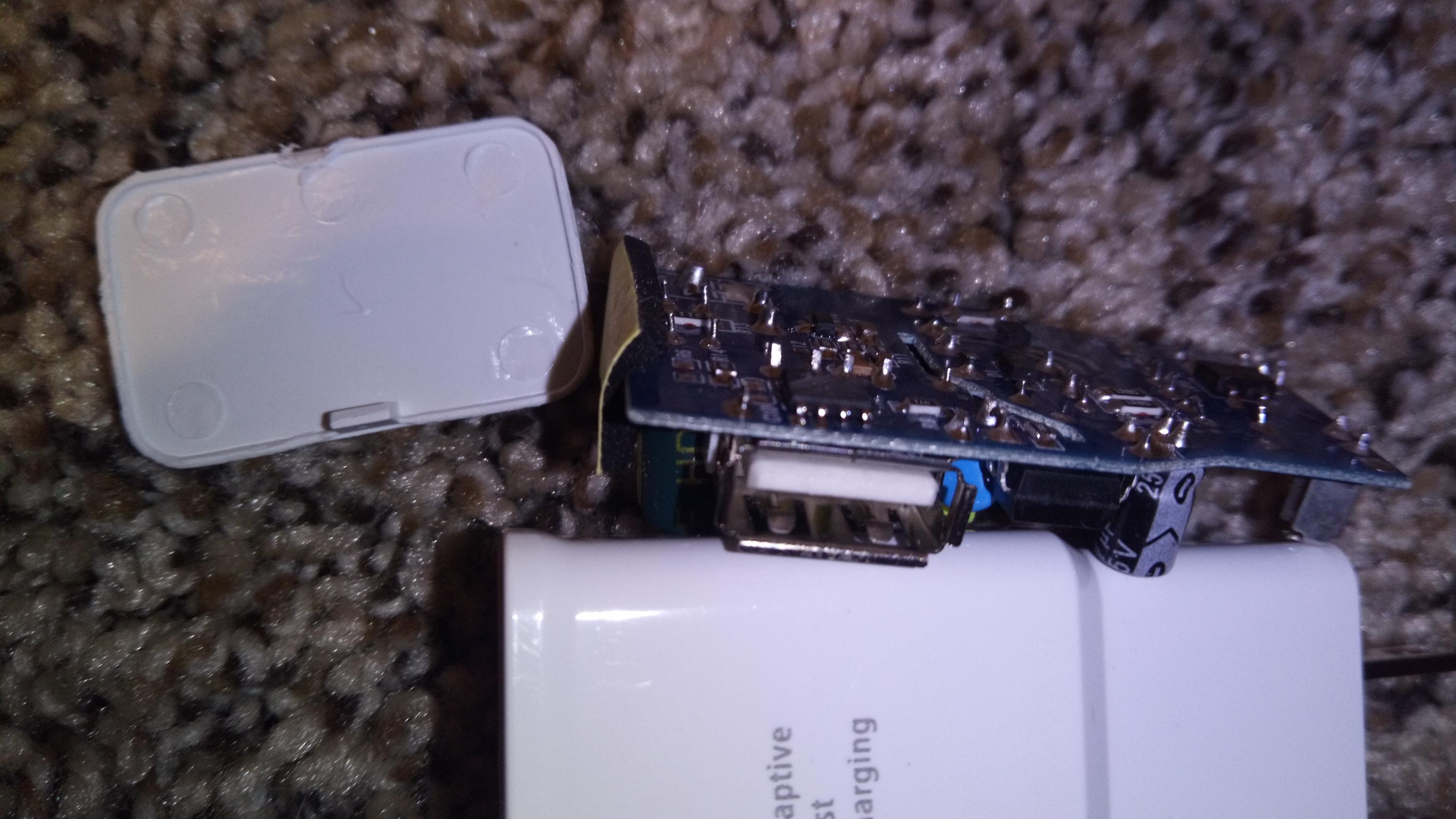

    Also notice the pad at the end, it's double sided tape with only half of the sticky side peeled off.
    Also, the PCB is as thick as about 10 sheets of paper.
    Yeah I'll let pictures explain the rest.
    Edit: In the pic where there are two side by side, the one on the LEFT is the fake, and for the one that for some reason is vertical, the one on the top is fake.

    Re: Fake Samsung Charger Sold by SnoCo Inc. on Amazon (Reported to Amazon)
    For ordering off Amazon, you have to make sure it is fulfilled by Amazon and not some 3rd party to get the best chance of getting a genuine product.
    I have seen these fakes on ebay, aliexpress, etc.
    I always keep the OEM charger that comes with a phone/tablet when purchased from a reputable company.
    Thanks for sharing and taking the time to take pictures.

      No problem, I want this shit to be made public because my mother got a fake battery from eBay and her computer's northbridge chip lit up red hot and caught on fire. That was not fucking fun to have happen at 9PM at night.
      Also, Samsung lists Walmart as the official retailer for their chargers? Went to the website, they said go there. Sure as shit Walmart has the official ones.
      Also, I don't order Samsung chargers, I get ones from brands like Anker or Aukey, as they are usually made very well and I've never had problems with them.
