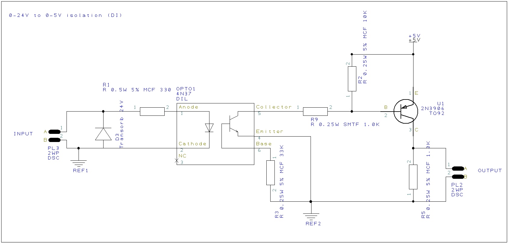

            i have found some schematics for analog opto isolation and i need opinion what should be good solution.
            There is video on youtube how machine works an this ones is quite same i am working on, afternoon i will post more pics.
            I am aware that there are modules for this but i want something just for testing purposes for now.
            Yes , i made opto board with 8 I/O and it serves me for simple functions for the
            machine like limit switches , Estop, etc. and 7i33 is daughter board for servo interfacing without any isolation.
            Mesa boards are relatively expensive , and i want to isolate it completly from machine.
            https://www.youtube.com/watch?v=JeSDThbsvyg

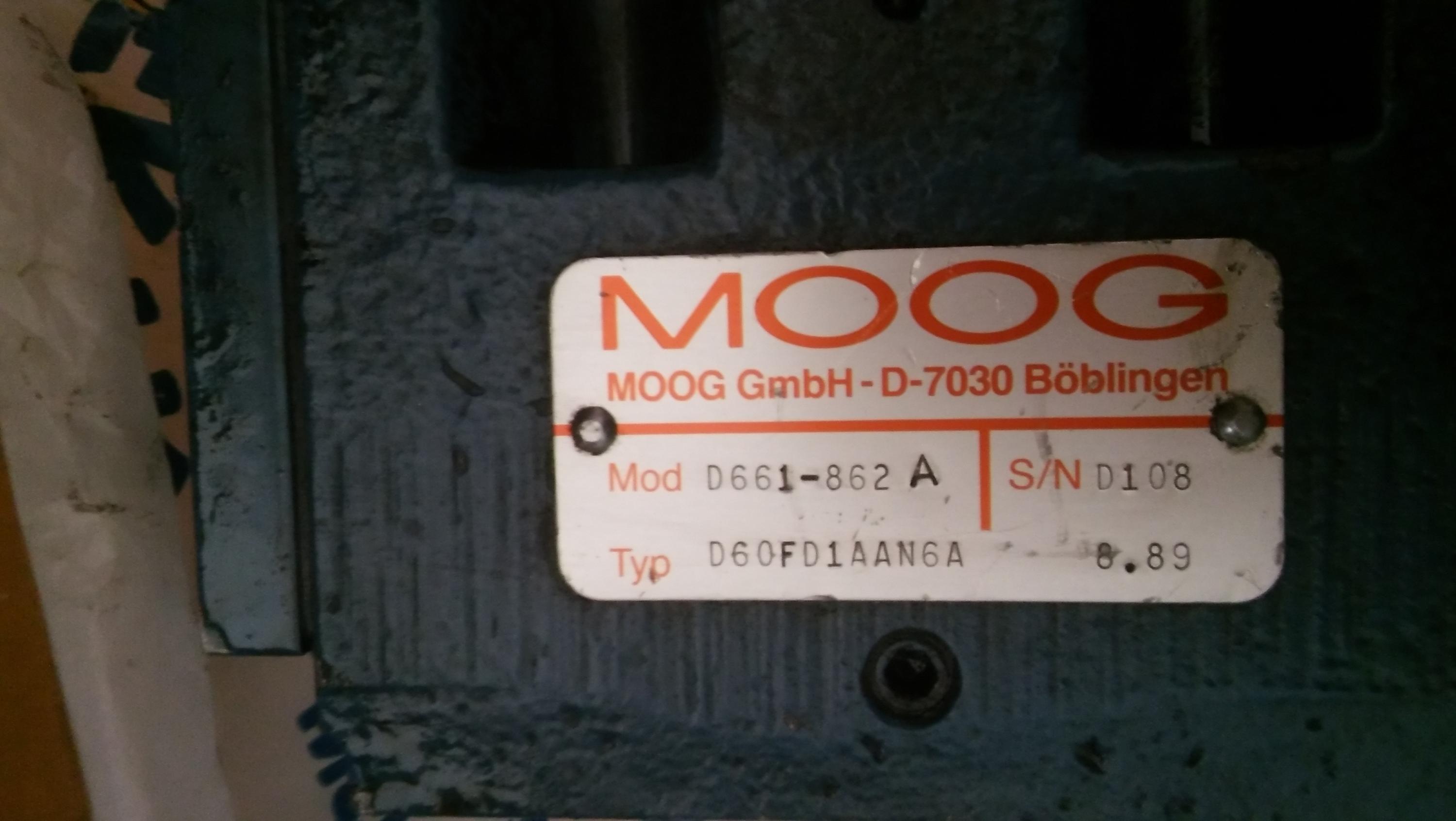

              I need to what the full model number servo value
              You are going to have a problem with what you posted because I read in the manual that the center position on the servo valve is 6 volts and full open is 11 volts
              Because one of them only goes to 5 volts
              Do you what the milliamperes is for the 0 to 11 volts signal to servo valve input to control the valve ----> is----> this will be important to know I might have a solution for this problem but I need know this information

                Re: Analog to pwm converter
                I think you are referring to actual spool value , this is output and i am not using it , i have
                encoder connected to the head controlling actual position.
                According to manual spool position is at center when Ud - Ue inputs are on zero volts ,also
                when using only one command signal as i have on 7i33 mesa board either Ud or Ue is connected to ground.
                This inputs also can be driven by current 0 to +/- 10mA

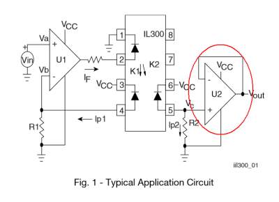

                      Yes that IL300 design with the servo feedback optoisolator design is one such solution. You could use two regular optoisolators as an alternate solution rather than using that single part to do voltage feedback - one optoisolator to do the main voltage transfer, and the other one to feed back any error to the driver.
                      I was kind of worried about the bandwidth needed for PWM solutions because I don't know what kind of bandwidth is needed - how fast must the PWM change its output voltage to be on time. You'll need a filter on the output to convert the pwm back to analog and that has some filter response that may or may not be acceptable to your system. (You could even use a microcontroller with an ADC to PCM it to a serial bus that can be isolated, and another microcontroller with a DAC to convert back, too, as another possibility.)
                      The all analog design also has bandwidth limitations too of course, but the analog solution's bandwidth should be good enough.
