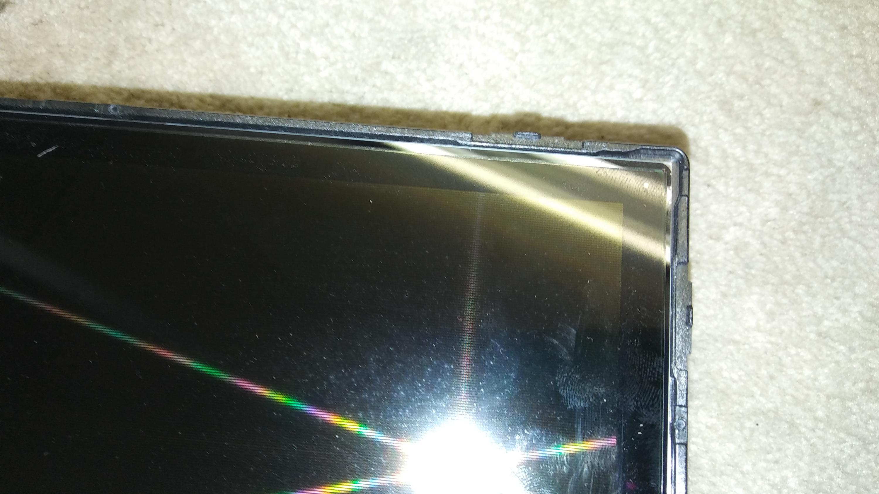

    Any tips for changing LED
    We, First.
    pic1 : I put the TV screen vertically bonded with tape.

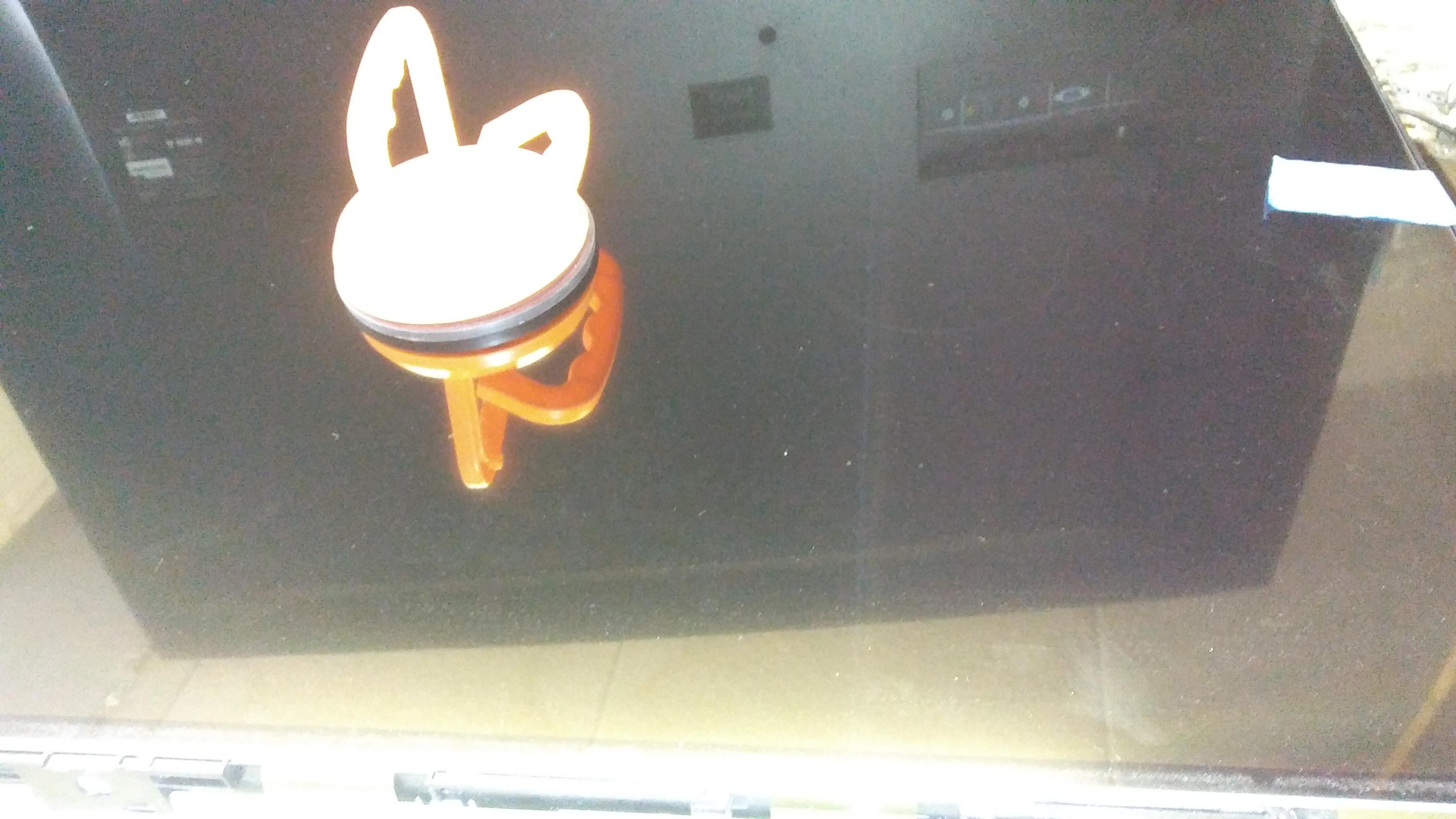

    pic2 : I use Harbor Freight glass sucker to aliment the LCD screen .

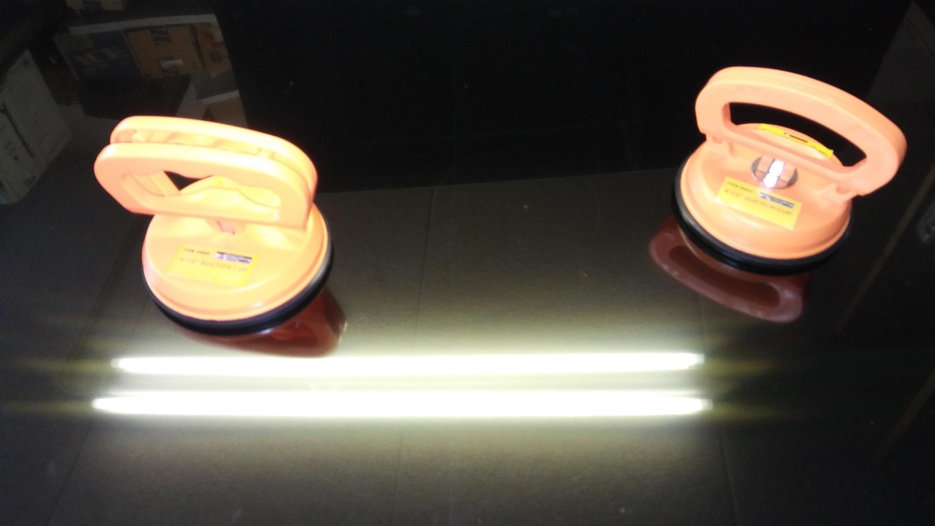

    pic3 ; make sure screen is inside the right place.

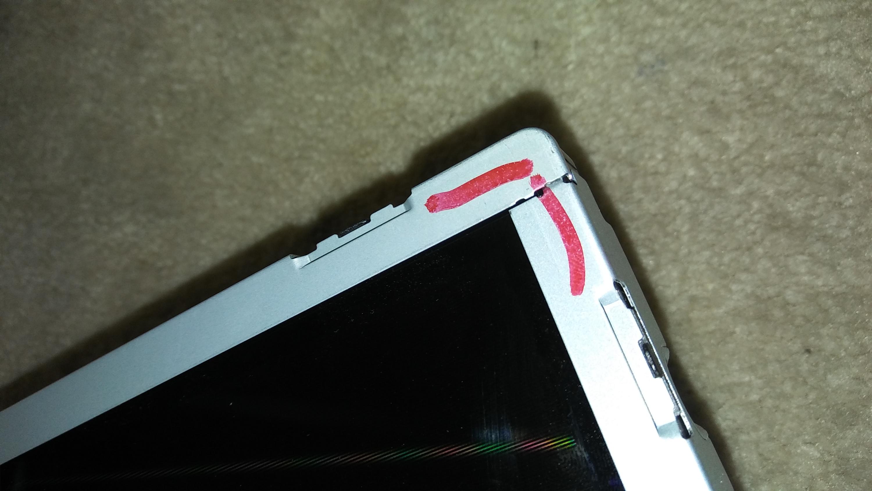

    pic4 : With marker I never confuse which one is which.
    Element Tv glue the screen with the frame, need to be extremely carefully.....
