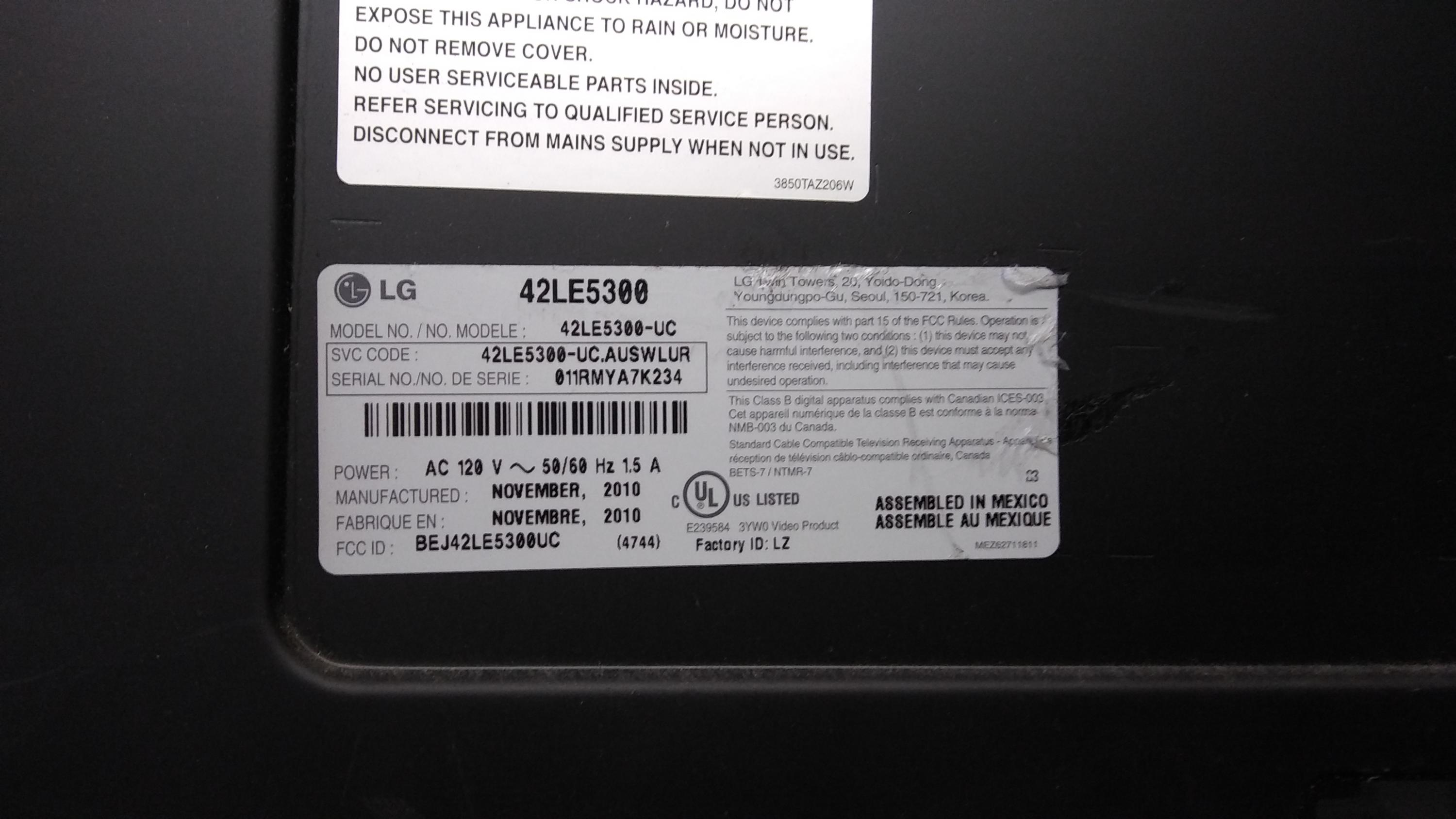

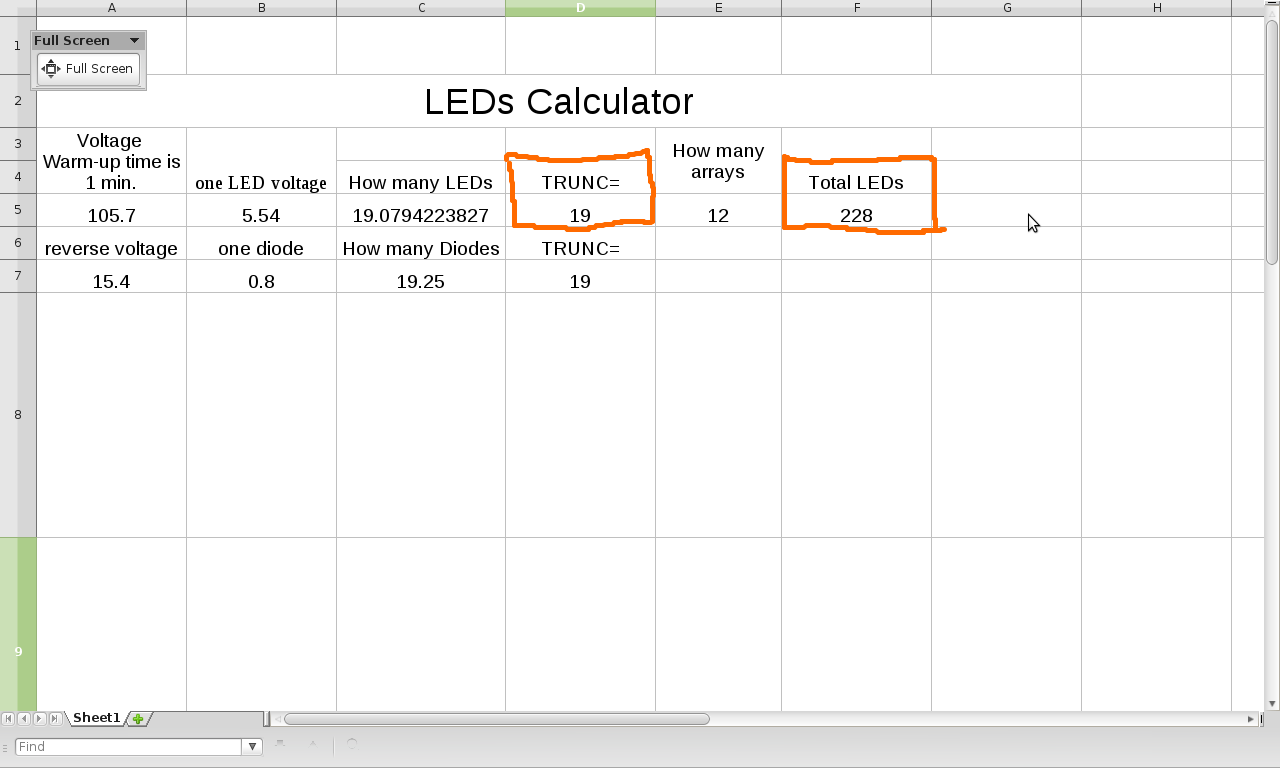

    LG 42LE5300 my tested result shows : 19 X 12, Total LEDs = 228 LEDs , but ShopJimmy's picture shows 52 X 4, total LEDs = 208 LEDs

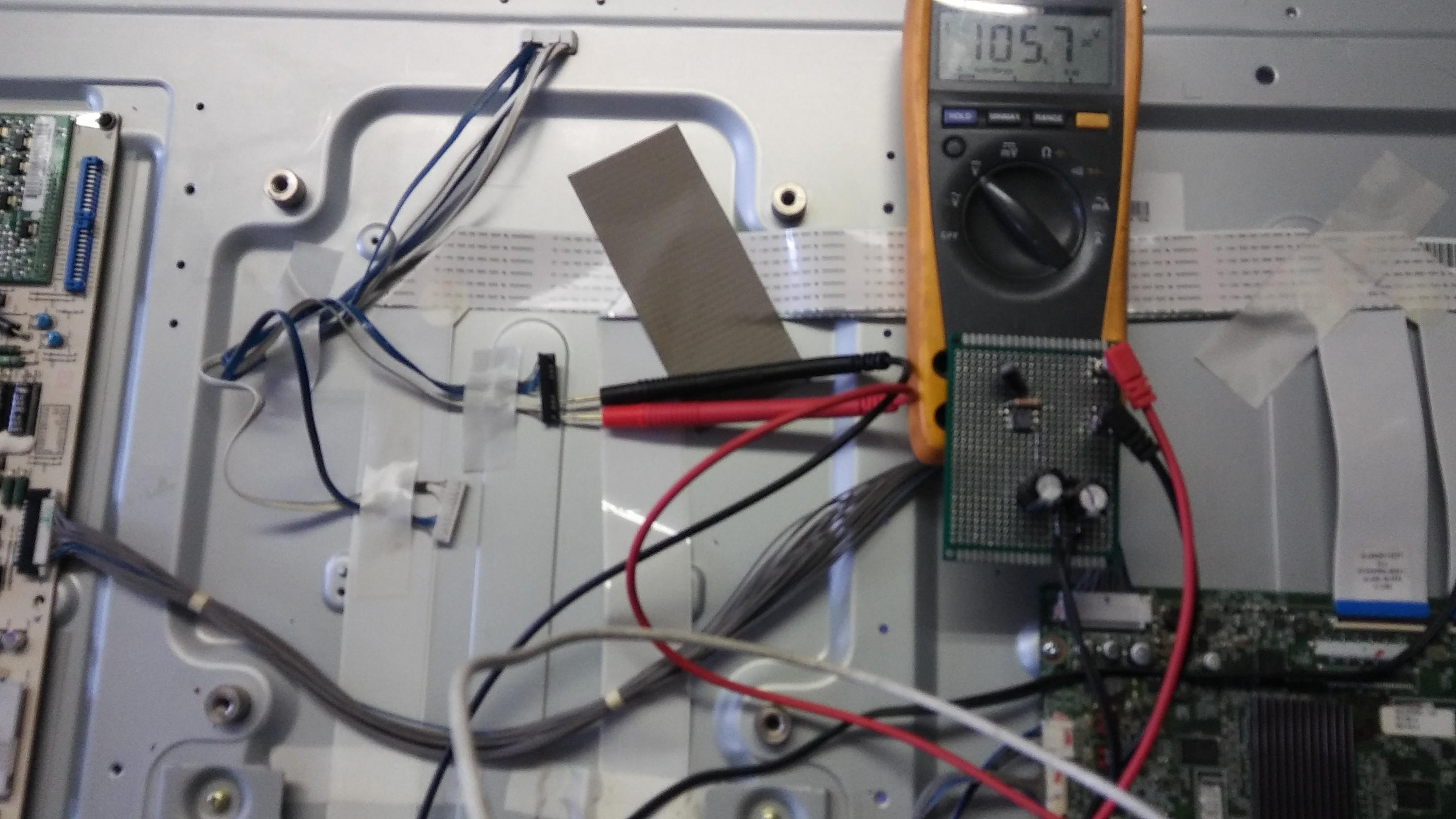

    Voltage needs wait 1 min. = 105.7v, one LED votage = 5.54v
    How many LEDs in an array = 19 LEDs, How many arrays = 12, Total LEDs = 228 LEDs
    PS: This edge screen has twins LEDs, all the led arrays worked OK, so I won't open the screen to find out the answer!

    p.s what is that board for on your meter ?
    • capwizard
      • Jun 2016
      • 1991
      Re: Me wrong or ShopJimmy?
      Poormans LED TV Backlight Tester.
      https://www.badcaps.net/forum/showthread.php?t=59136

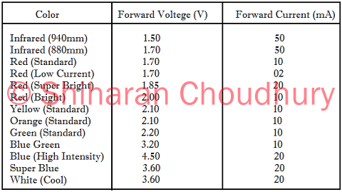

              5.54V for Dual -LED, you are getting that may be due to you are not running at close to max If so the calculation comes out wrong?
              I.E. Look at Vf VS If chart.
              https://cdn.badcaps-static.com/pdfs/...4398d8add2.pdf

                "you are getting that may be due to you are not running at close to max If so the calculation comes out wrong?"
                Ive set Tester current at 6.8 mA for safety reason, normally single LED should be at 20 mA -30 mA, but total LEDs test current also low, calculate results that are aiming for unknown values, the percent error formula turnout to be pretty accurate.
                "Not running at close to max" that did bother me, then I found out testing at 5ma, 10ma, 15ma, and 20ma the result almost the same, and can accurately predict the number of LEDs, but not the total power consumption. Thank you for your response.

                  "normally single LED should be at 20 mA -30 mA" Not these White backlights LEDs they run at 200~400mA.
                  Lower current = lower Vf so your cal for the qty of LEDs will be off.

                    You're the Best! it's hard to believe that TV industry put up the current so high to get what they want, every time I saw the spec. I thought that was A misprint! In my case, LEDs current is at 55mA.
                    From ShopJimmy: base on AUO's panel T420HW07 V.1 it is 208 LEDs. He is right!.....
                    ShopJimmy's picture shows 52 X 4, total LEDs = 208 LEDs is for Panel Sticker Number: T420HW07 V.1 LG/Vizio T420HW07 V.1 LED Strips - 4 Strips
                    From my calculation: base on LG's panel LC420EUH it is 228 LEDs. im right!.....
                    Voltage = 105.7v, one LED voltage = 5.54v, how many LEDs in an array = 19 LEDs, How many arrays = 12, Total LEDs = 228 LEDs
                    PS: My LG 42LE5300 TV LED screen till unopened..... WHY! they use different brand of panels? Because they sale so many TVs all over the world , always out of the supply.

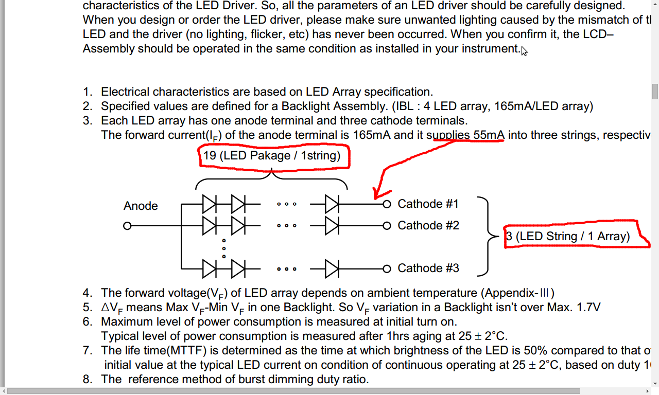

                      If you look at the chart (LC420) when the LED string are driven at 55mA (TYP.), the Vf is 117.8V (TYP.).
                      The T420 is driven at 120mA (typ), Vf for one string is 88.4V (TYP.)
