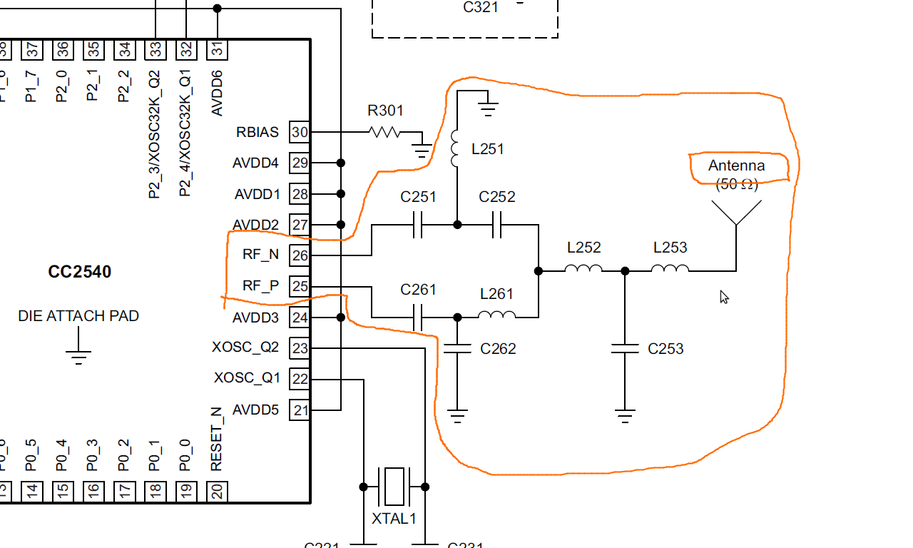

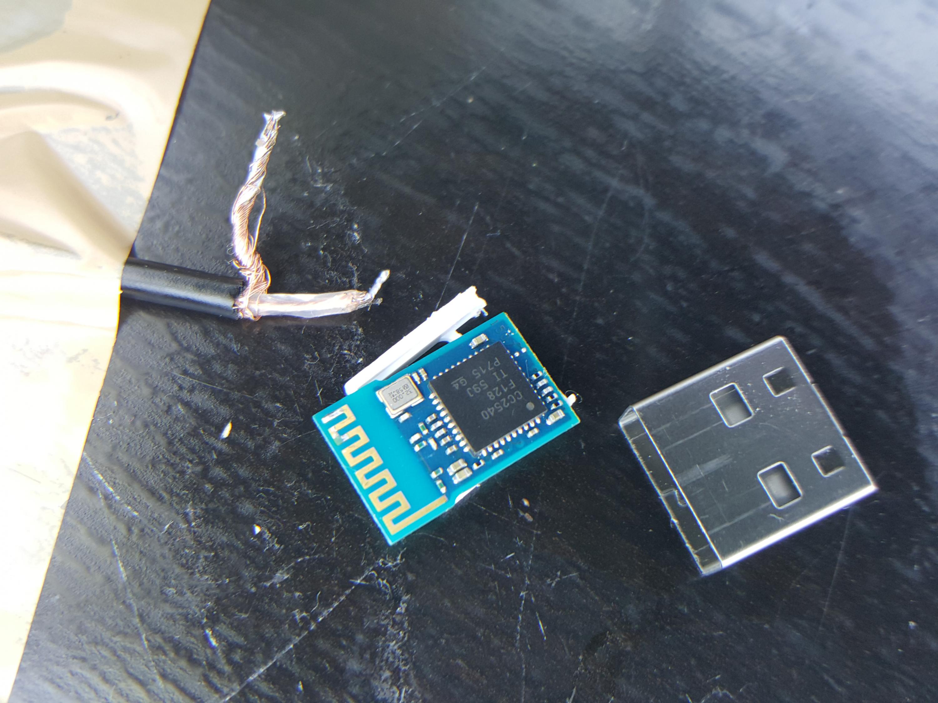

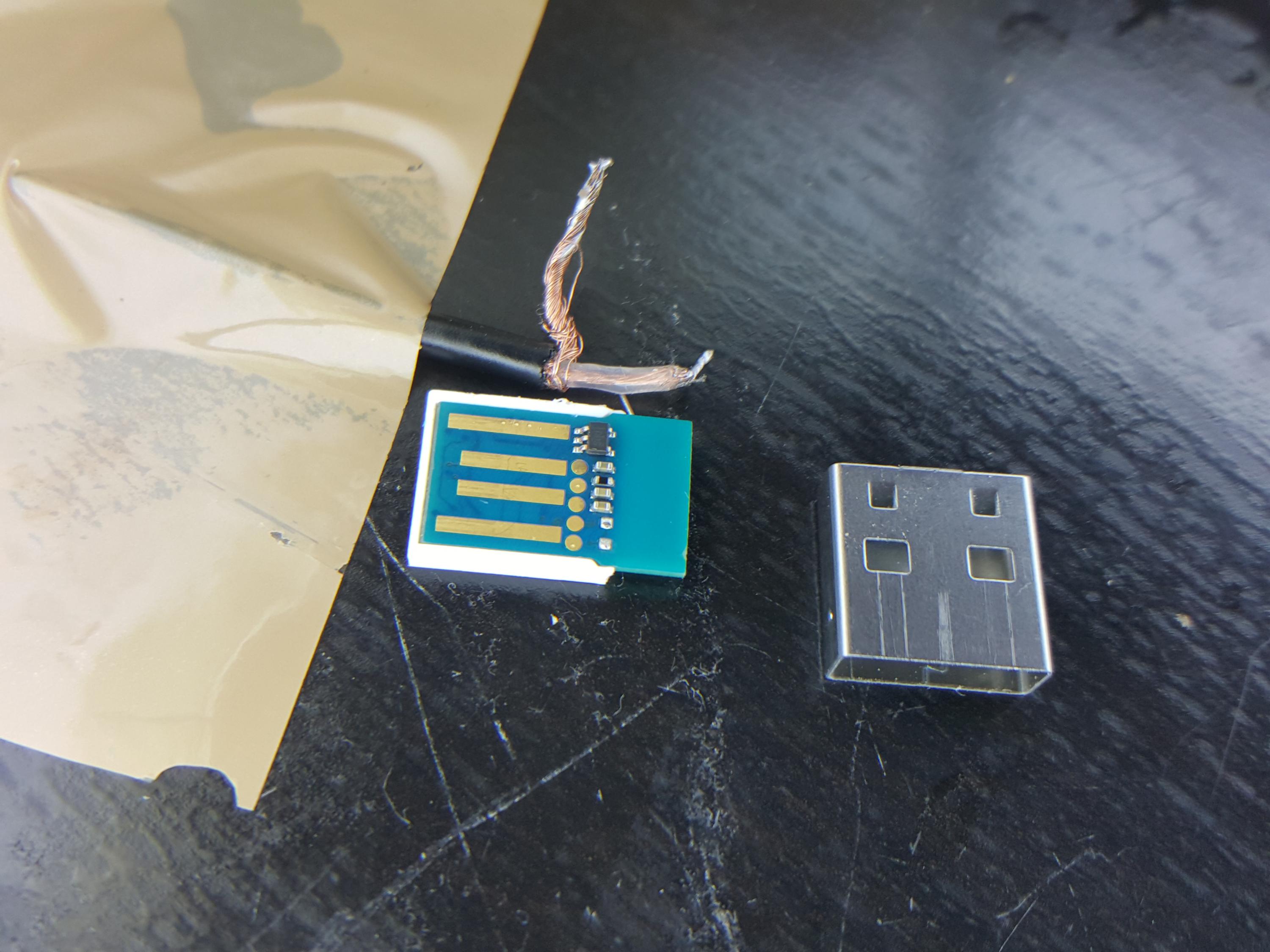

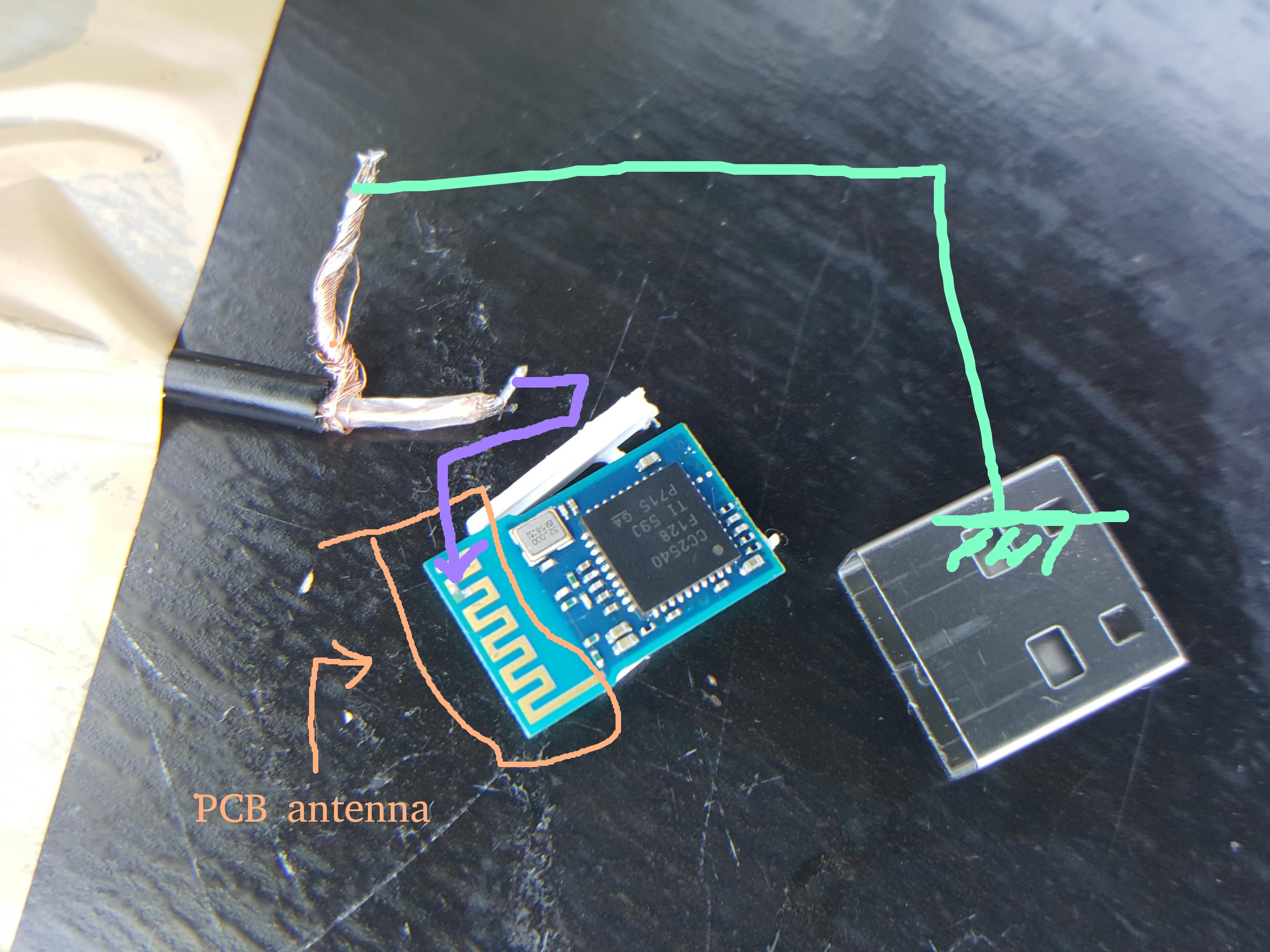

    So i have this BT USB dongle and i need it to cover a wider area, The question that i have is WHERE DO I SOLDER the middle middle wire..i know that the outer layer goes to ground but I believe i have to bypass a few caps or resistors to connect my new omni directional antenna. I have photos of the device and The SChematic for the IC CHIP.

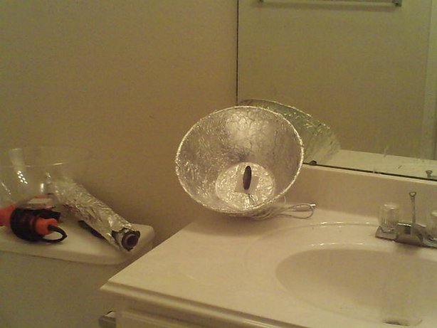

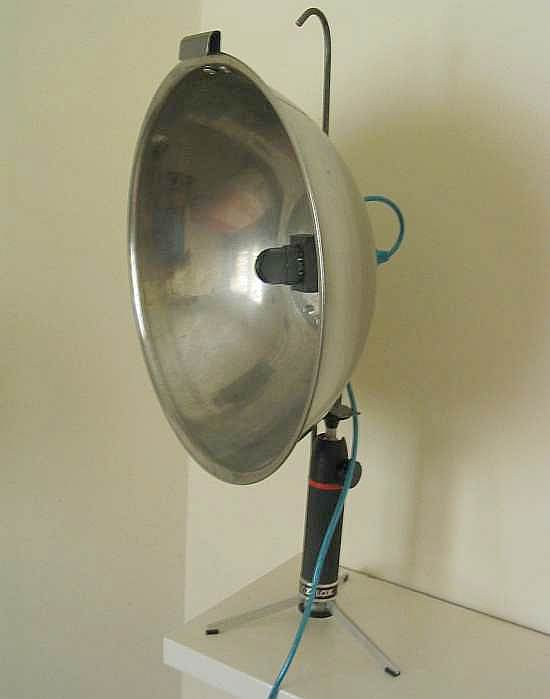

    My friend made a salad bowl antenna, he has been used city wifi for free about 2 years.
    Wifi antenna comparison Which directional type ?
    http://users.picknowl.com.au/~gloaming_agnet/ant4.html
    Two quicky directional wifi antennas
    http://www.instructables.com/id/Two-...-bowl-antenna/

      AWESOME i'll give that a try... I actually have a 16dbi onmi directional antenna..i read somewhere that some of the component in the antenna circuitry makes it differentiate between diapole and omnidirectional..something like that..but I'll give this a try. thankx a lot.

                Re: Help with USB bluetooth external antenna project..
                Originally posted by capwizard
                Can't wait to see the result. PL. Giving a Feedback.
                I dont think it worked. can't get away more than 50 feet away from this bluetooth with the antenna soldered as suggested. i even set different tx power/calibrated power on devices's setting.

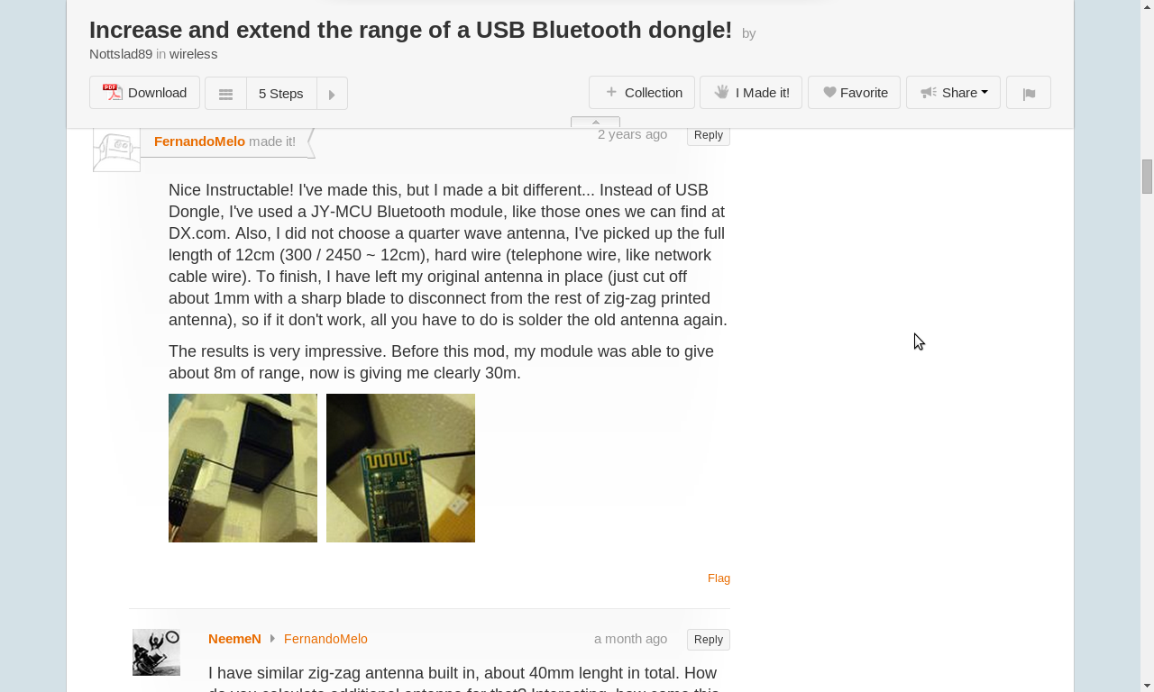

                      Increase and extend the range of a USB Bluetooth dongle!
                      http://www.instructables.com/id/Incr...-now-attached/

                        • 31137
                        what type of cable was it?
                        at 2.4GHz it matters!
