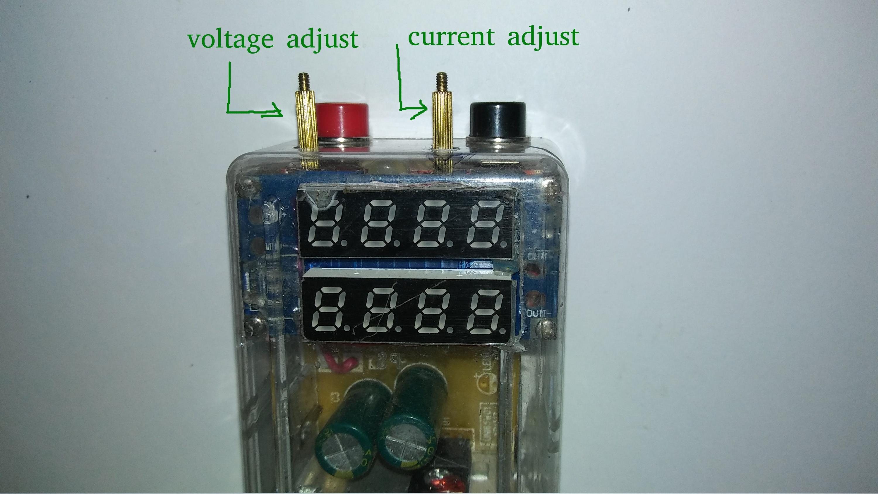

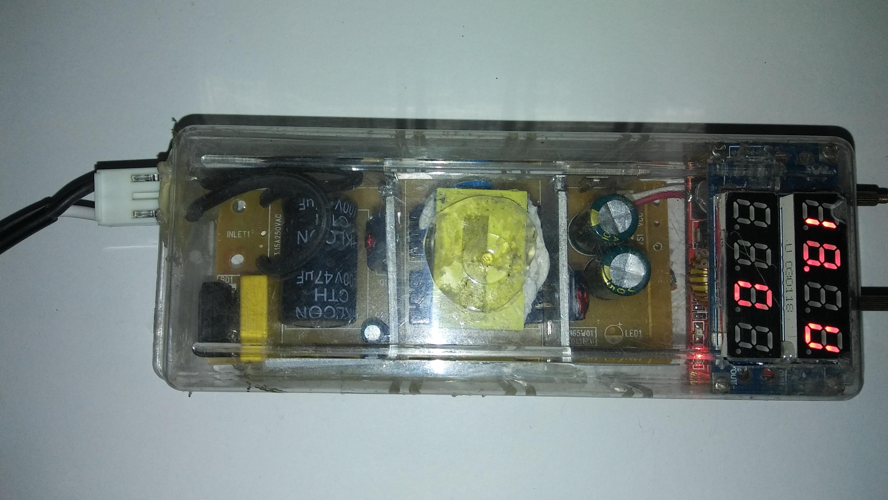

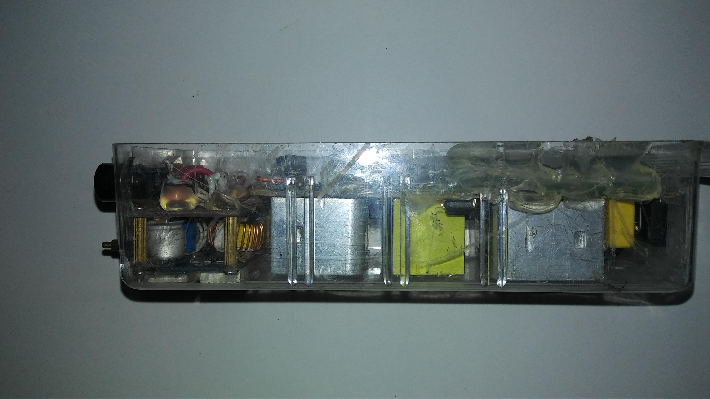

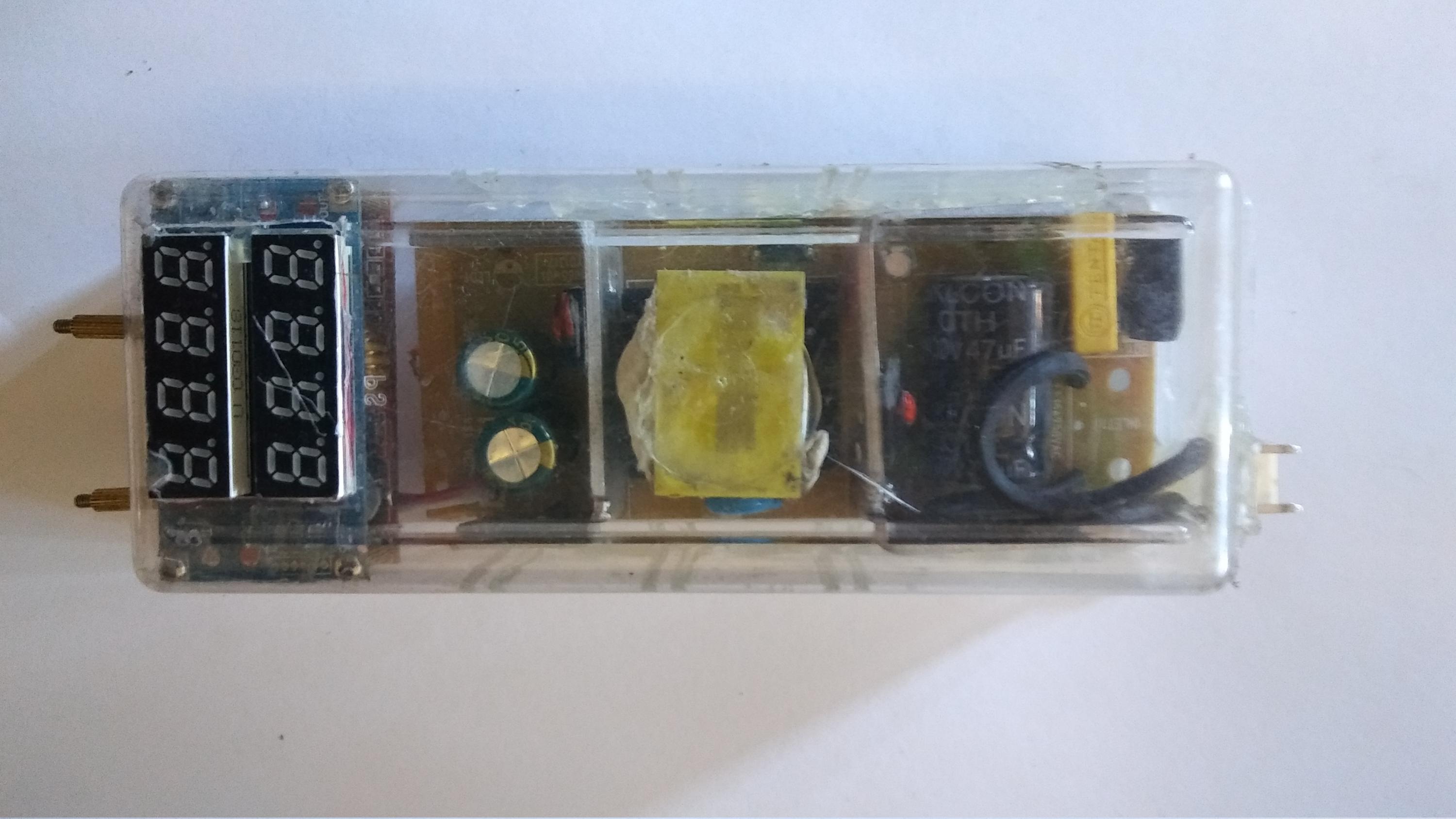

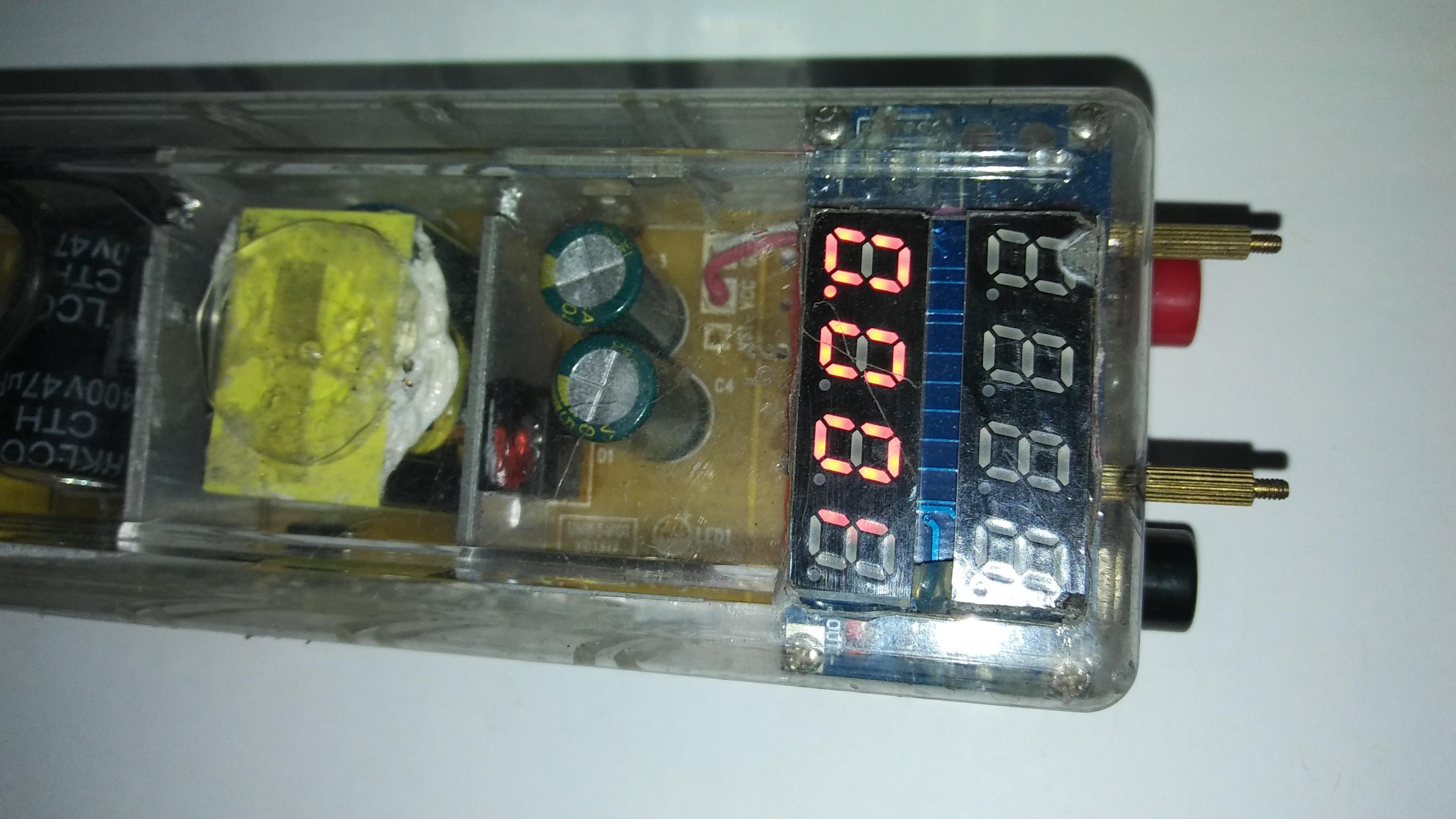

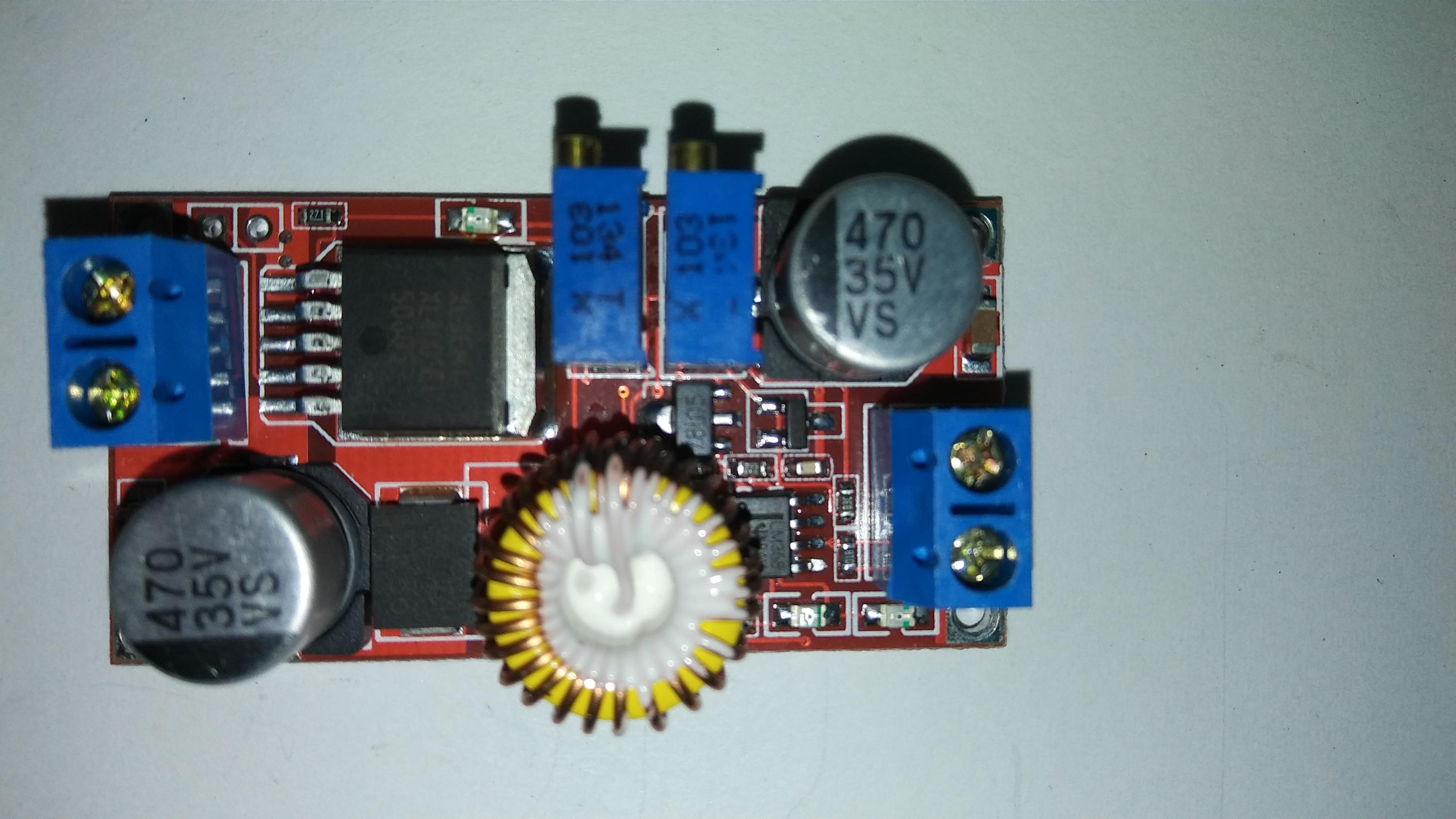

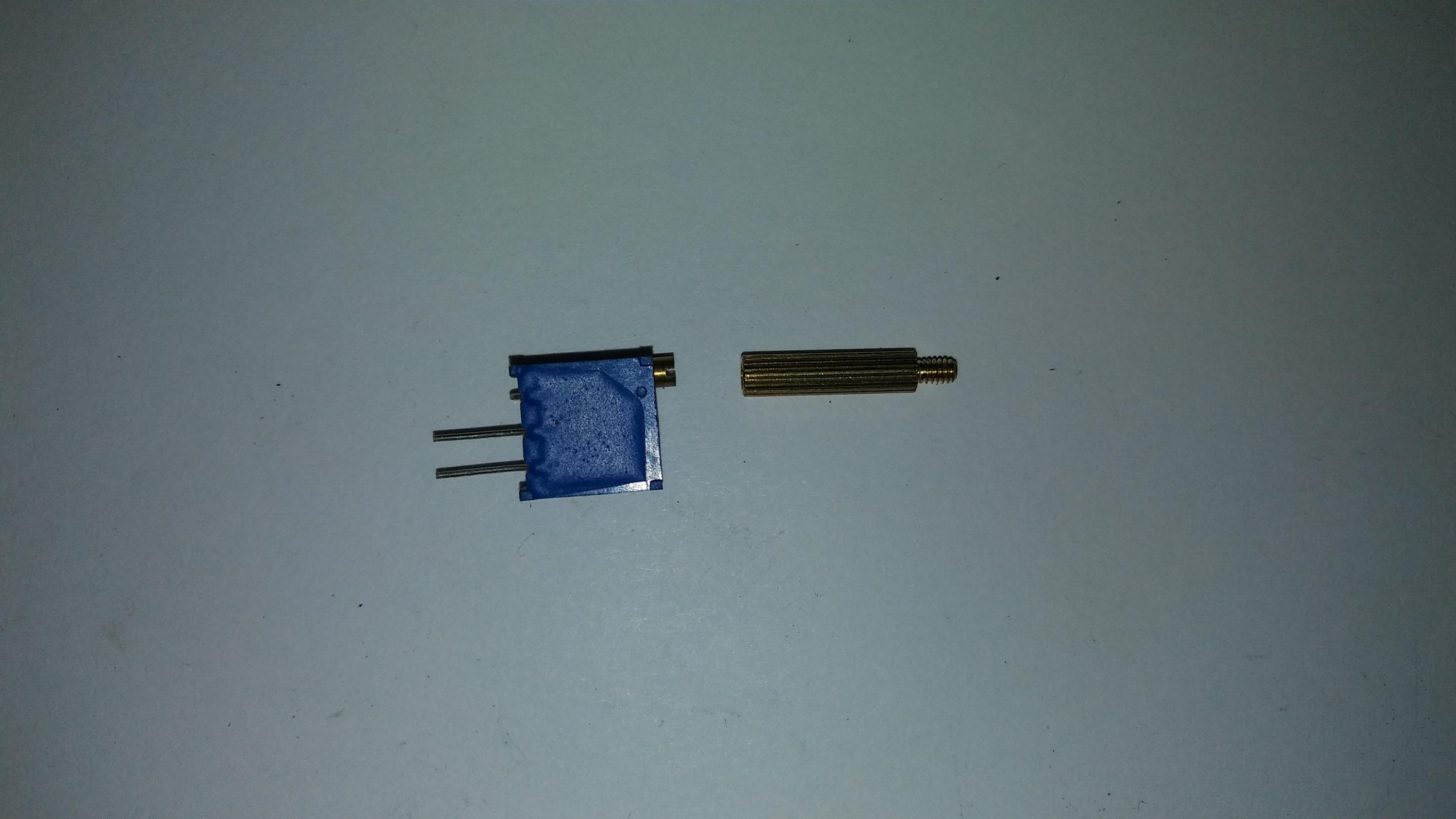

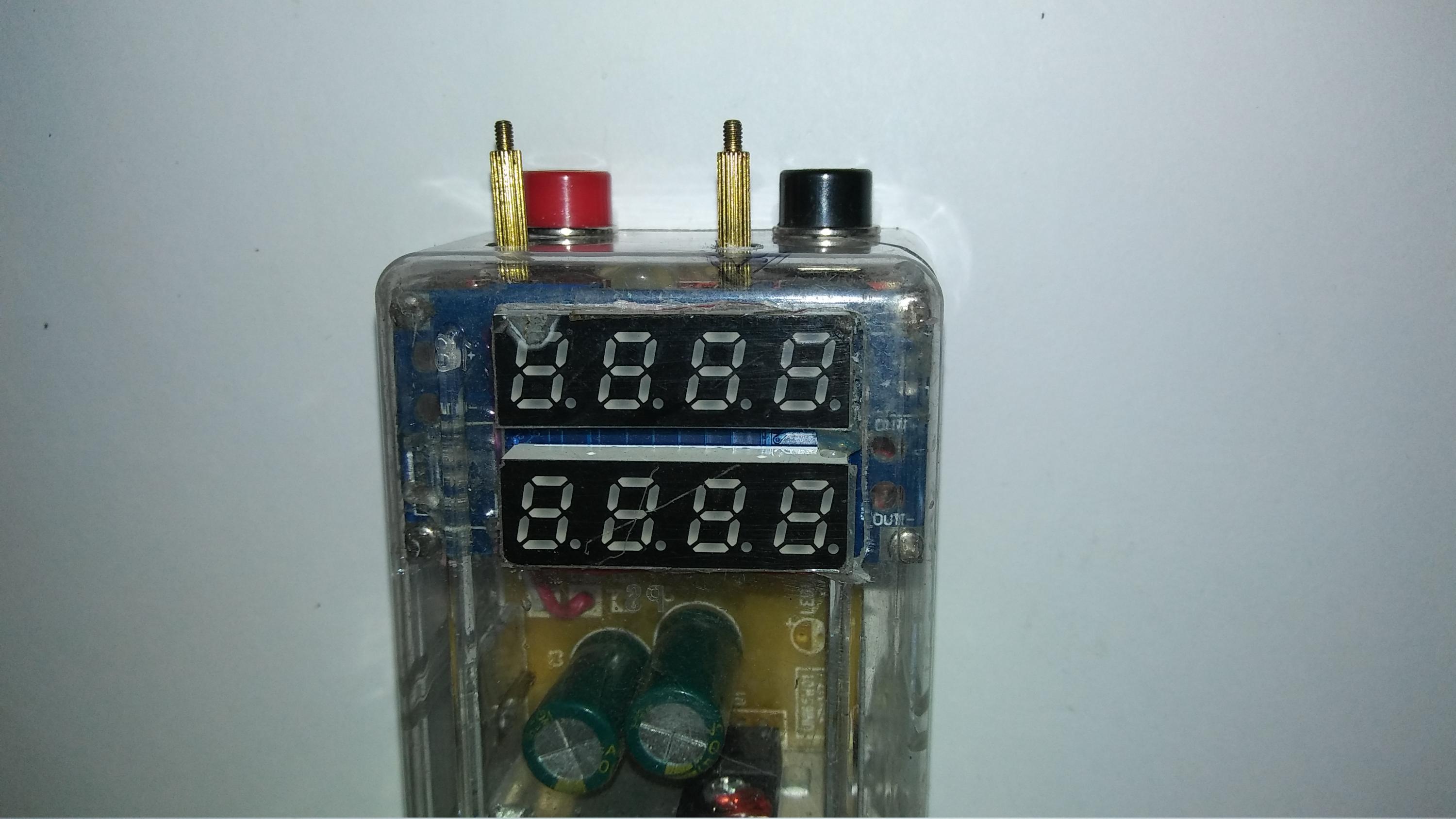

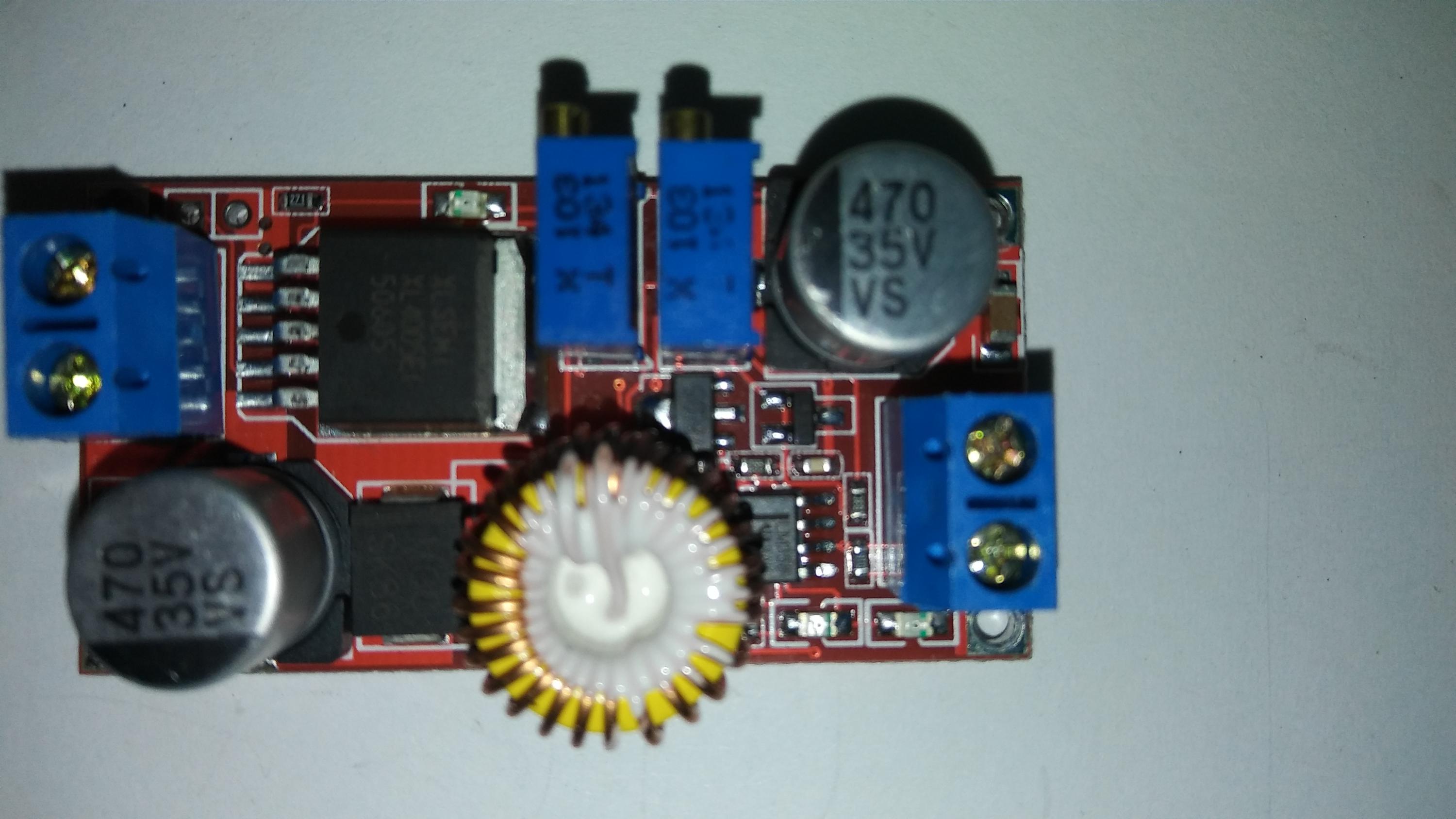

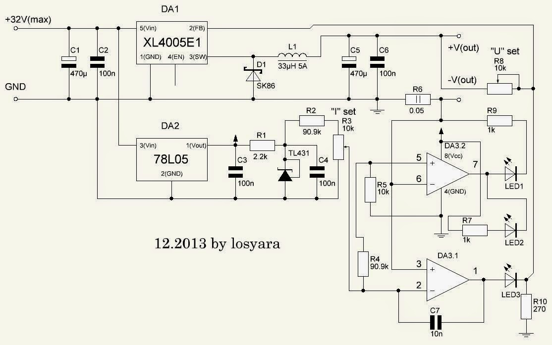

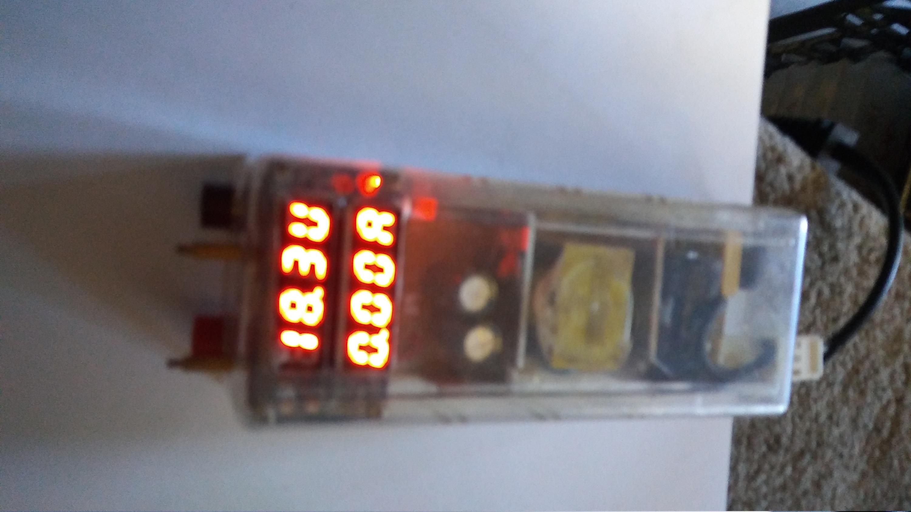

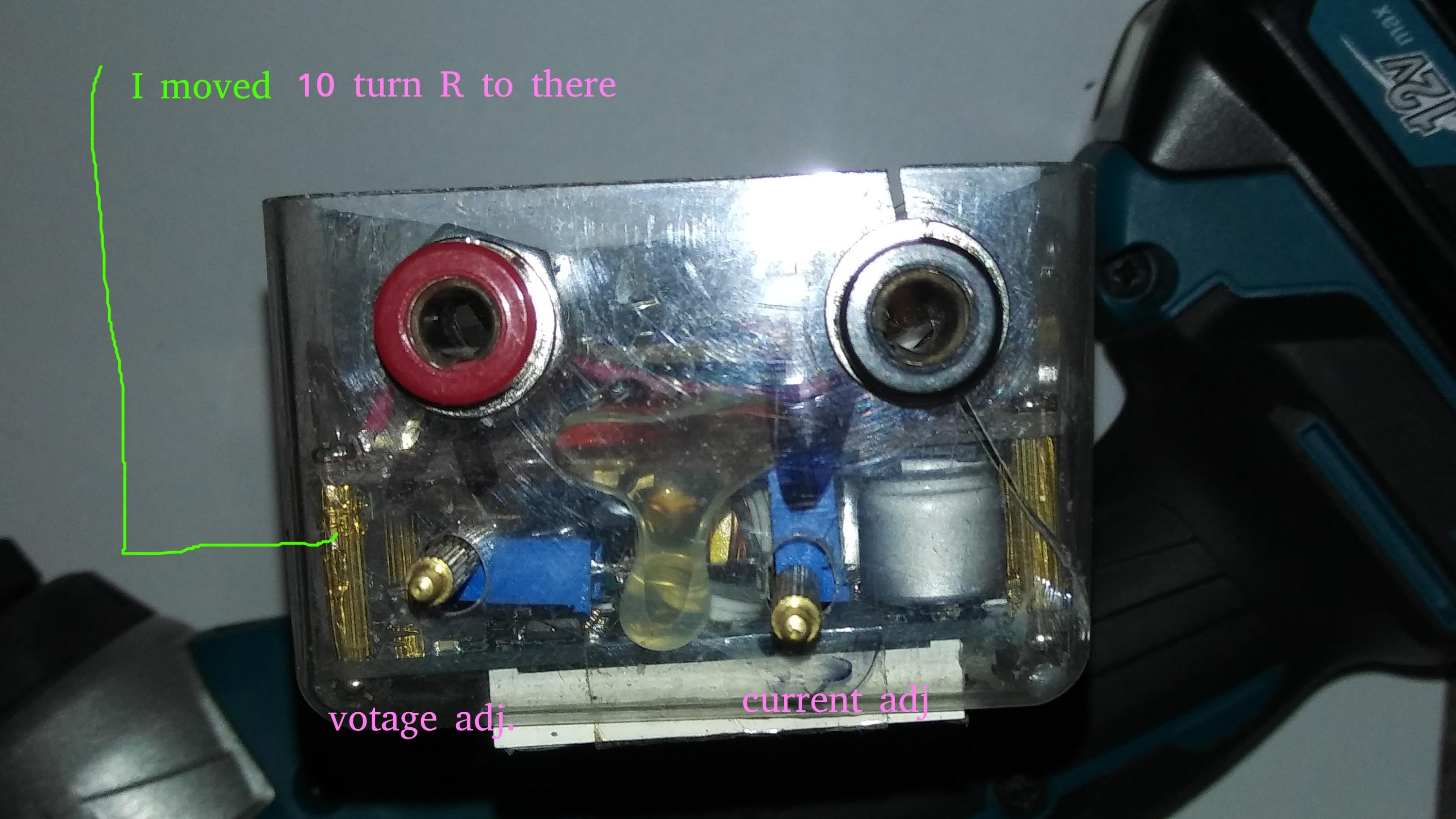

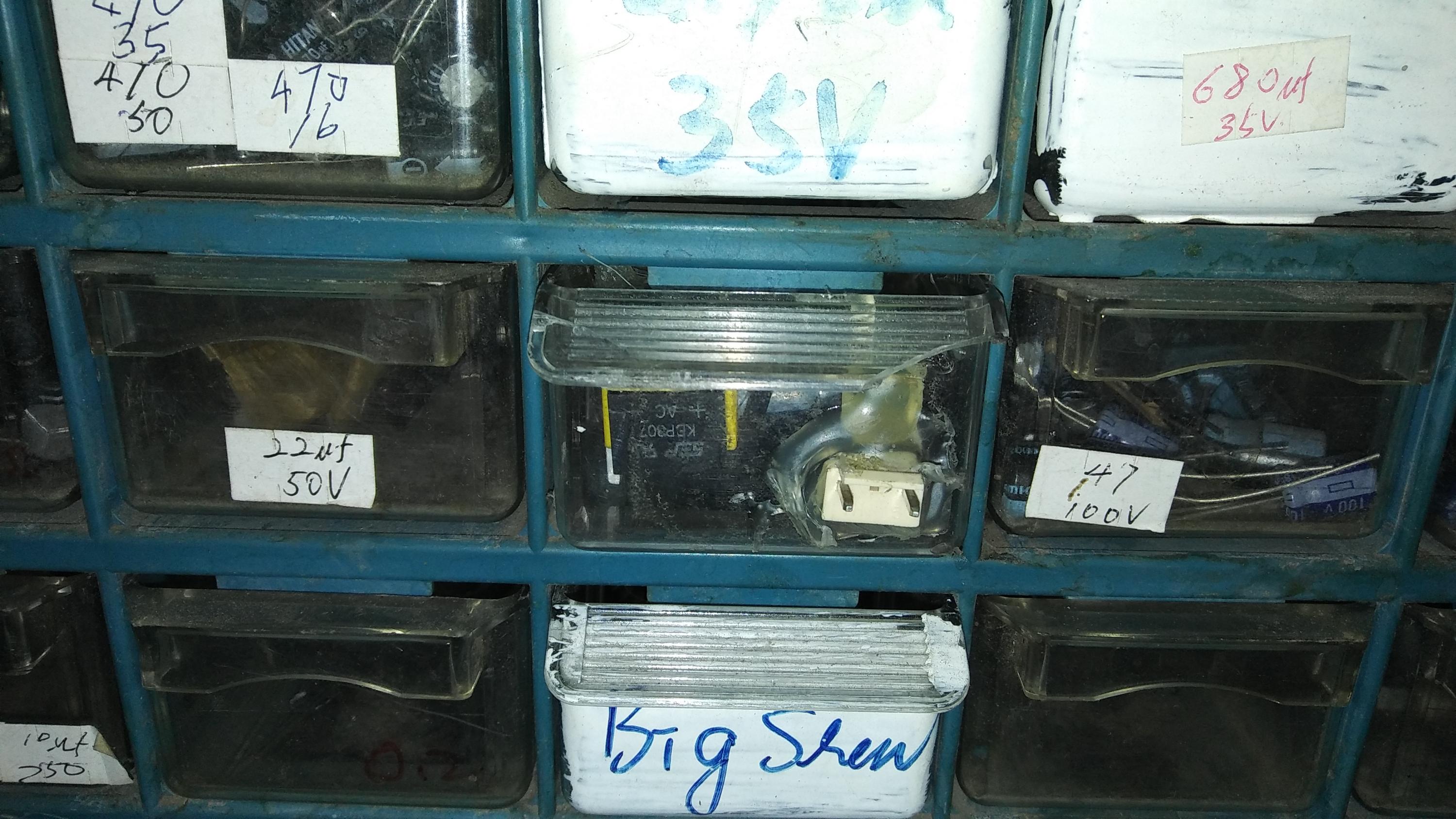

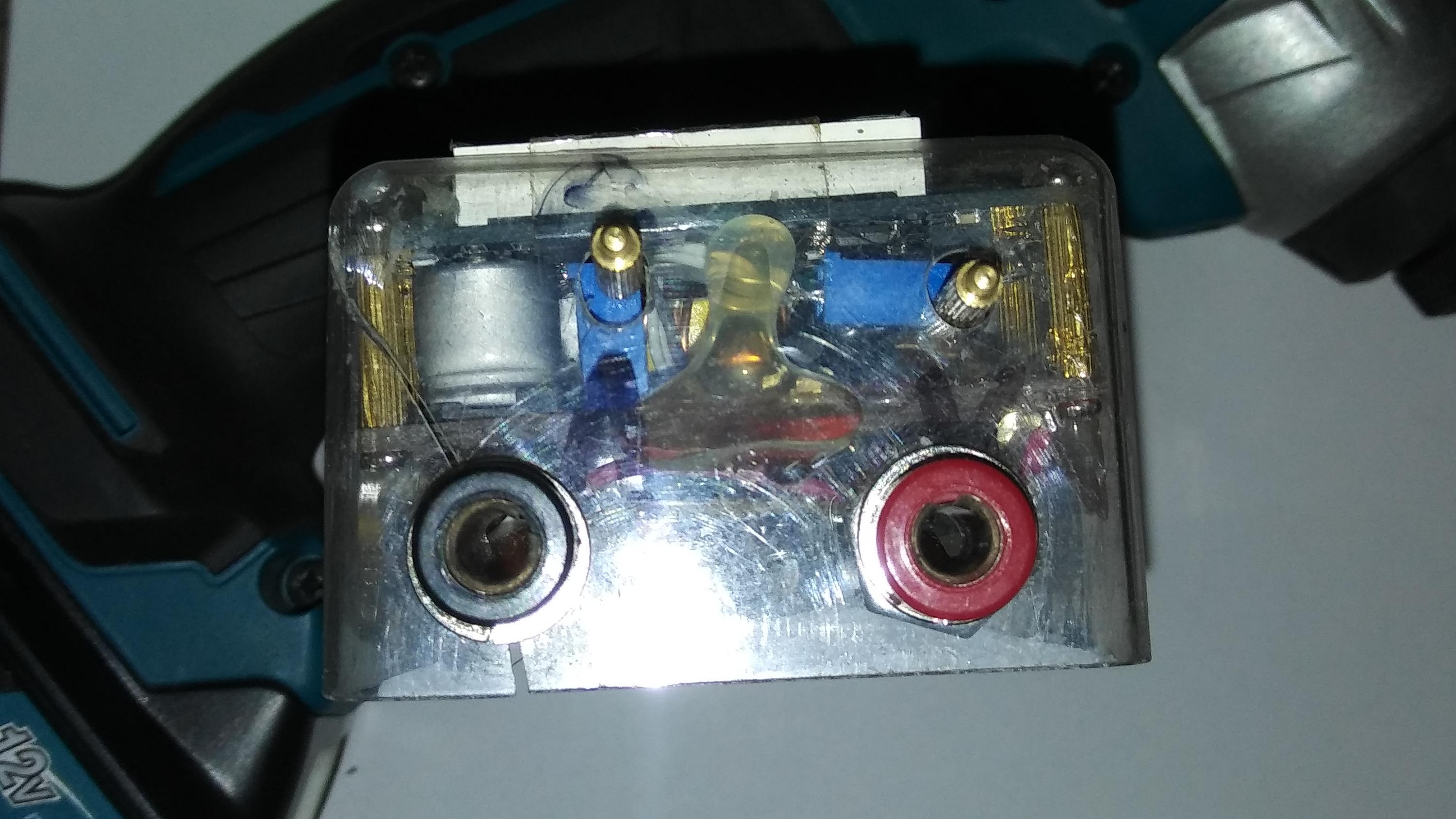

    Home made (fits in Drawer Parts Cabinet) adjustable CV (1.2v -30v) CC (0ma-2A) mini power supply
    This is the power supply which I use the most, instead of my heavy HP bench top power supply.

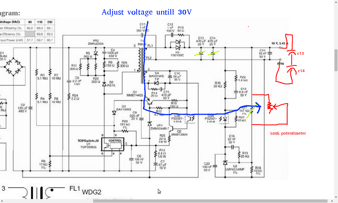

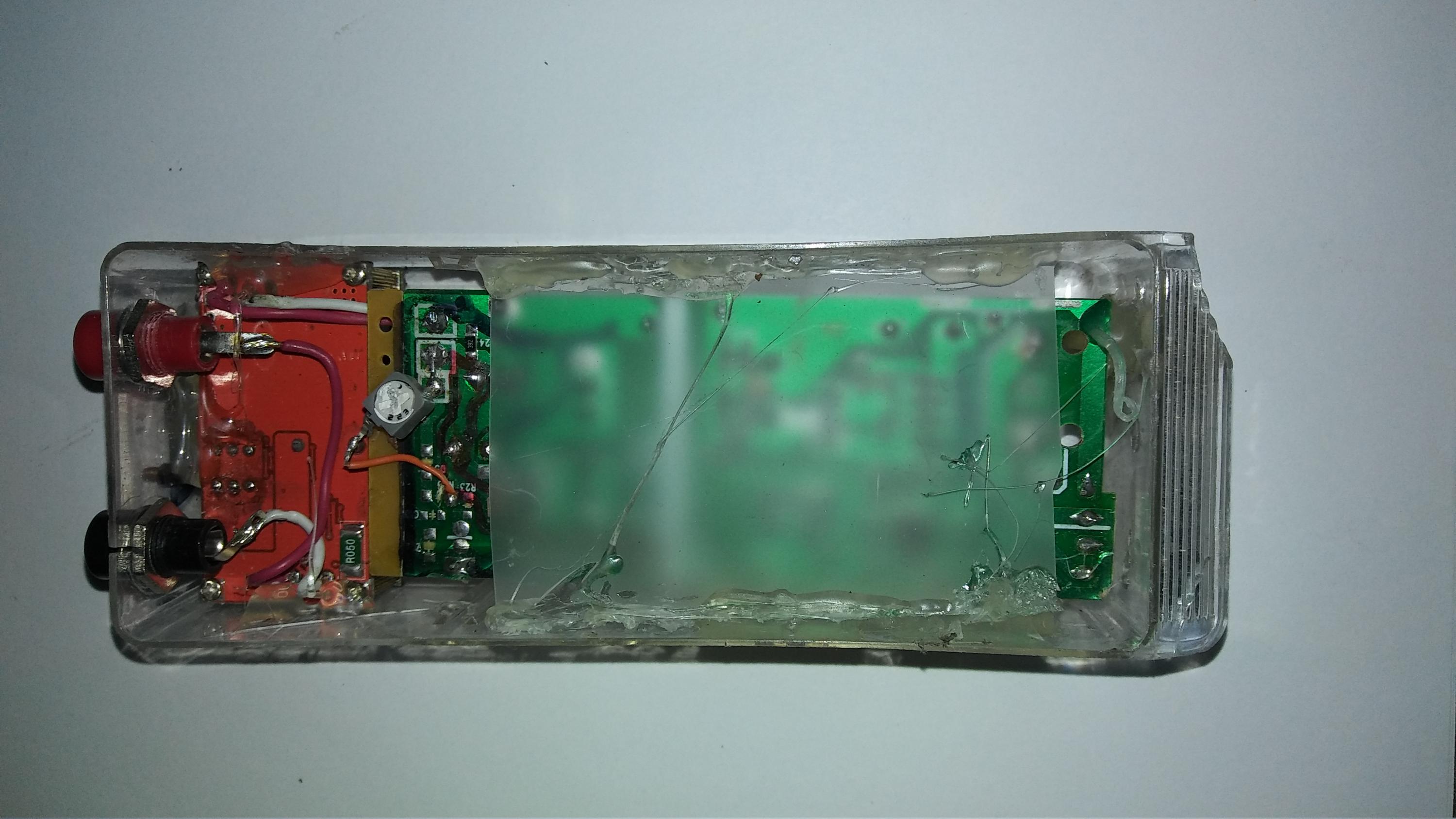

    First: Find an AC adapter DC output 28v – 30v, then go to Step 2.
    Step 1:. cant find it . I grab one AC adapter (9v 2.2A) from junk pile. First we need to jack up the voltage to 30v, take out 2 capacitors and a 9vZener diode on 9v voltage line. Put a 500K potentiometer on TL431 leg 1 (ref). Now you have an AC adapter DC output 24v – 33v.
    Step2: IF you have a 30v dc power supply, put a cc cv led meter , now you have a 30v CC CV DC power supply with LED METER.
    reference from:
    BenchTop Power Supply with XL4005
    http://remcoterol.blogspot.com/2015/...t-finisht.html

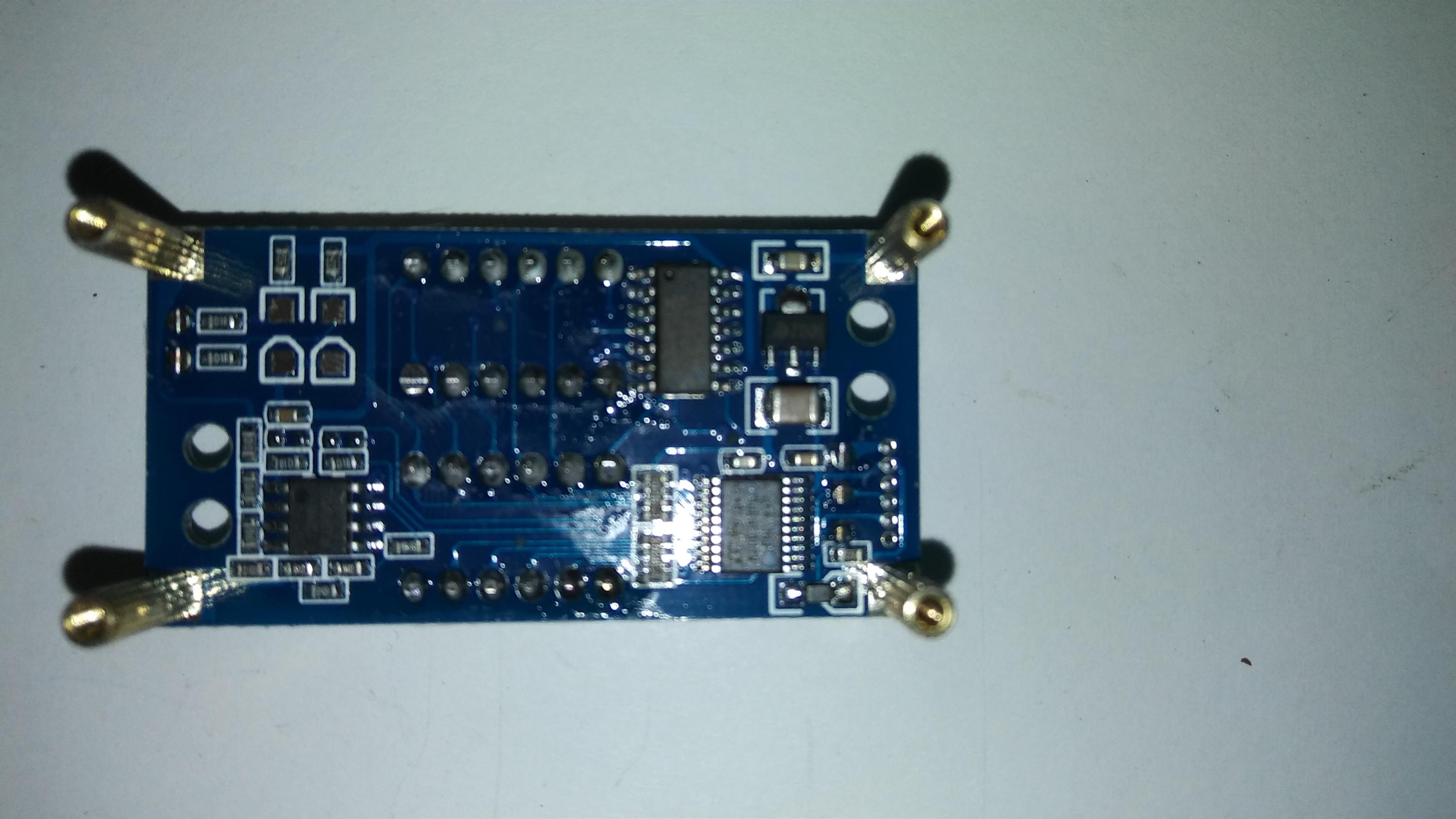

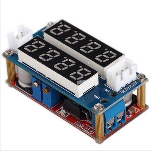

    How well are those meters, especially the CC module. Do you have the spec of the module you use?

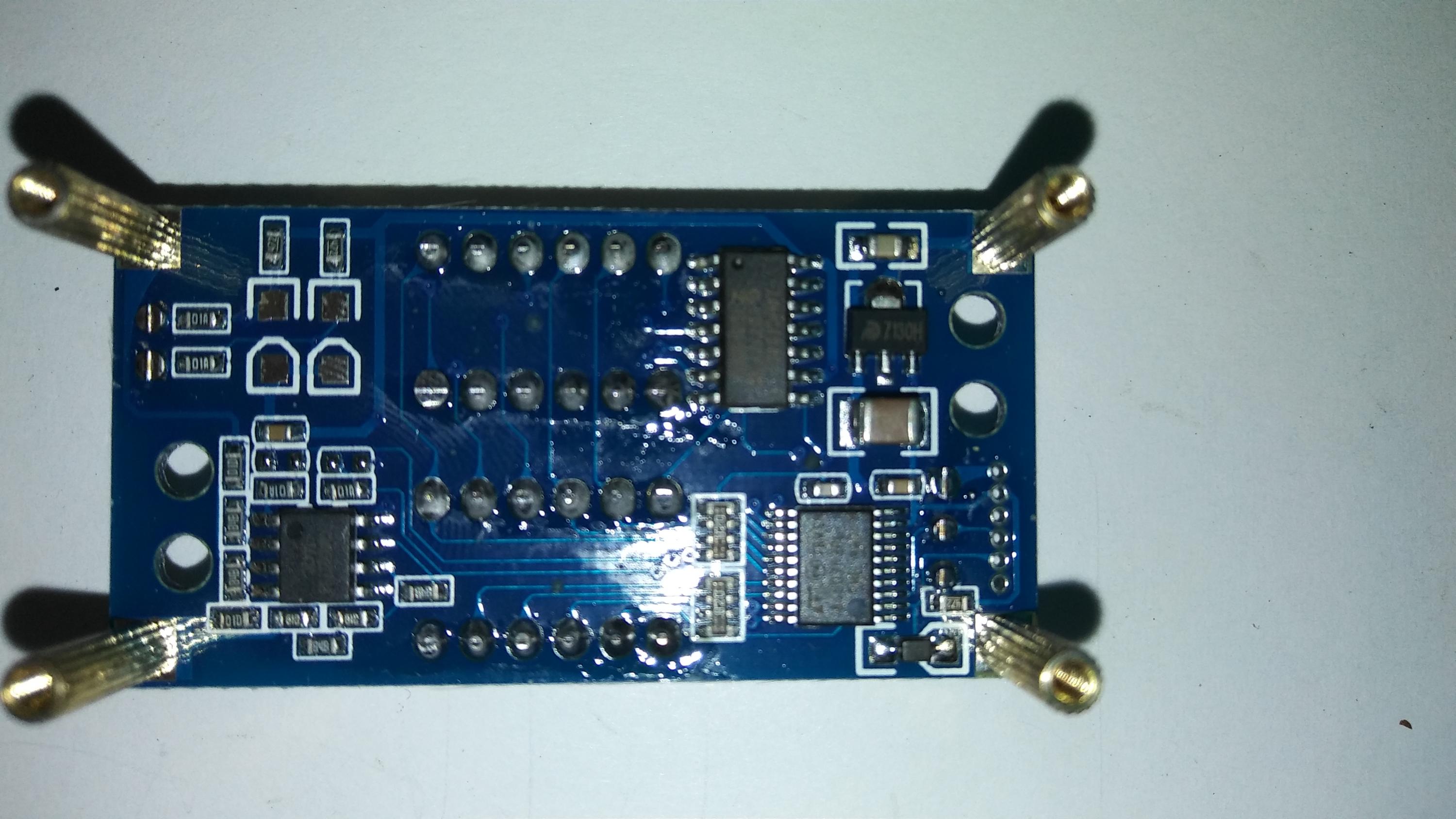

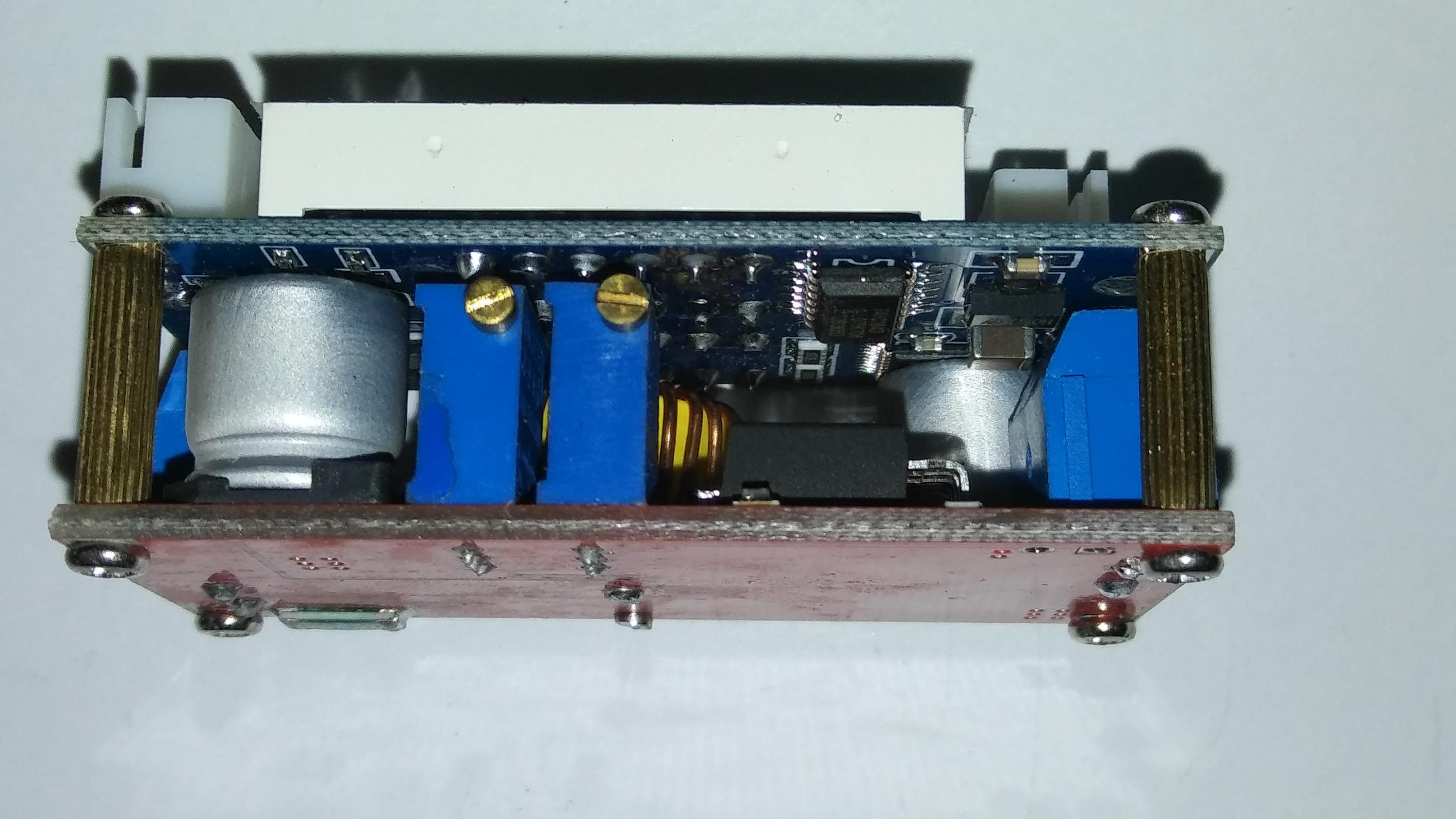

      Yes, The module is this:
      5A Adjustable CC/CV Step Down buck converter charge Module. LED Panel Voltmeter Ammeter. IC is xl4005, It is originally designed for RC lithium-ion battery charger.
      Review 1:
      Buck Converter DC/DC PSU has Voltmeter and Ammeter and a Bug!
      https://www.youtube.com/watch?v=tOFvfZyXLzY
      A really compact buck converter with constant current control and voltage and current digital LED displays. It works well, but be careful when shorting the output terminals!
      don't short circuit this module at lowest voltage set point, the circuit with the op-amp and the shunt resistor won't work. Current is limited by the XL4005 it self, that will be 5.5A !!.
