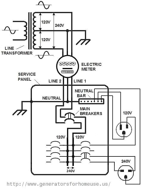

                      Well, it sounds like you need to get good working meter to start with otherwise you are doing goose chase with the wrong data.
                      What do you mean you do not have 240VAC yet? I never seen the house that the Electric company does not provide split-phase power to the house.
                      Amperage of the panel has nothing to do with getting the split-phase power to the house or not.
                      Show us what you have in your breaker panel.

                        So your saying you only one 120 RMS power line coming into your home?

                          I meant I do not have any 240VAC outlets yet. My old house, we had a 240V outlet for the stove, a 240V outlet for the dryer, and a 240V outlet for my rework station, that I wired myself. I just meant all the outlets in this house are 120VAC outlets.

                            No, I should had been more clear. I meant all the outlet's are just 120VAC. I thought Stj was referring to the 240V outlet that I installed in the old house for my BGA rework station. You guys helped me wire it up. Sorry for the confusion.

                                When I wake up tomorrow, I'll pull the cover off and take some pictures. Tomorrow is my wife's due date for the baby but we're not sure she's going to come tomorrow or not. I'm going to head to bed now so I can get up early, just in case.
                                I know amperage of the panel has nothing to do with getting the split-phase power to the house. I thought though maybe the setup isn't correct. One 100 amp panel that supplies a 60-amp smaller sub-panel....I thought perhaps the people who installed it didn't know what they were doing and maybe that's why we're getting some weird readings and have some unhooked wires in the basement, etc.
