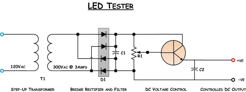

    LED Backlight Tester
    I have a transformer to build this circuit. Do you guys think it is a safe test tool to make?
    • 31278
    Re: LED Backlight Tester
    no, you need to regulate or limit the current.
      Thanks stj
