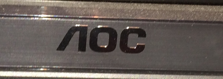

                Re: Any harm in increasing capacitance?
                I have a AOC brand TV set that use to not want to turn OFF
                When hit the power button and the tech that came said the the switch board was bad
                This set was only 18 months old at the time
                I had an exstend warranty on this set and then they told me that the switch was no longer Avable any more I got a refund on what I paid for the tv and exstend warranty
                I used for another year with the switch board disconnect and used the remote
                Then I move this tv to our office and did not want to have use the remote to turn it ON and OFF
                So I open the TV set and check all of the caps on the power board and the board controller and found that every cap that was below 100uf had a very high ESR value compared to a new one and after I recaped both board I could use the switch board that was on the set
                Now it turn ON and OFF like it should
                I hope this helps
